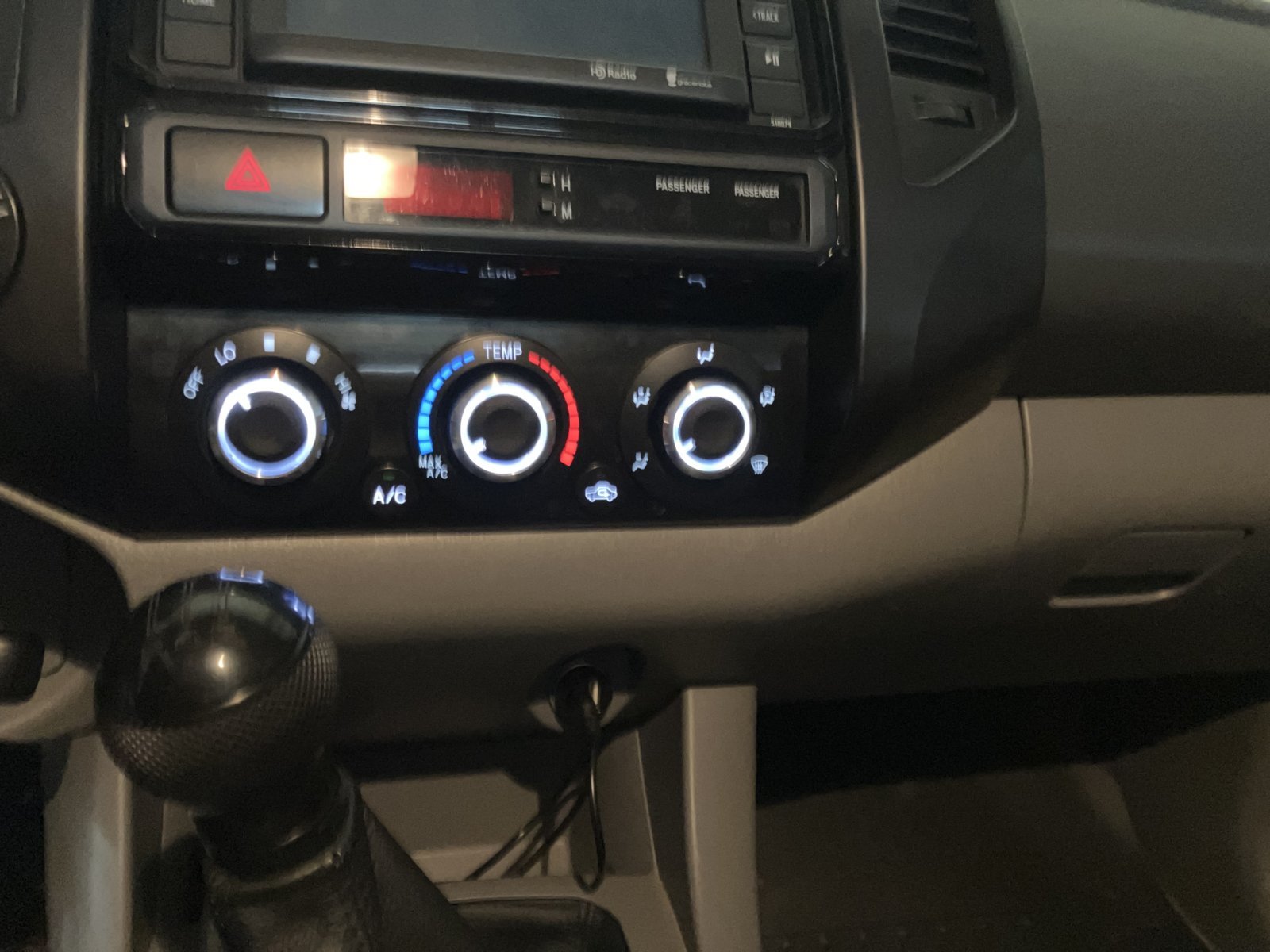

    No idea whatsoever. I can grab a photo.

    That would be cool!

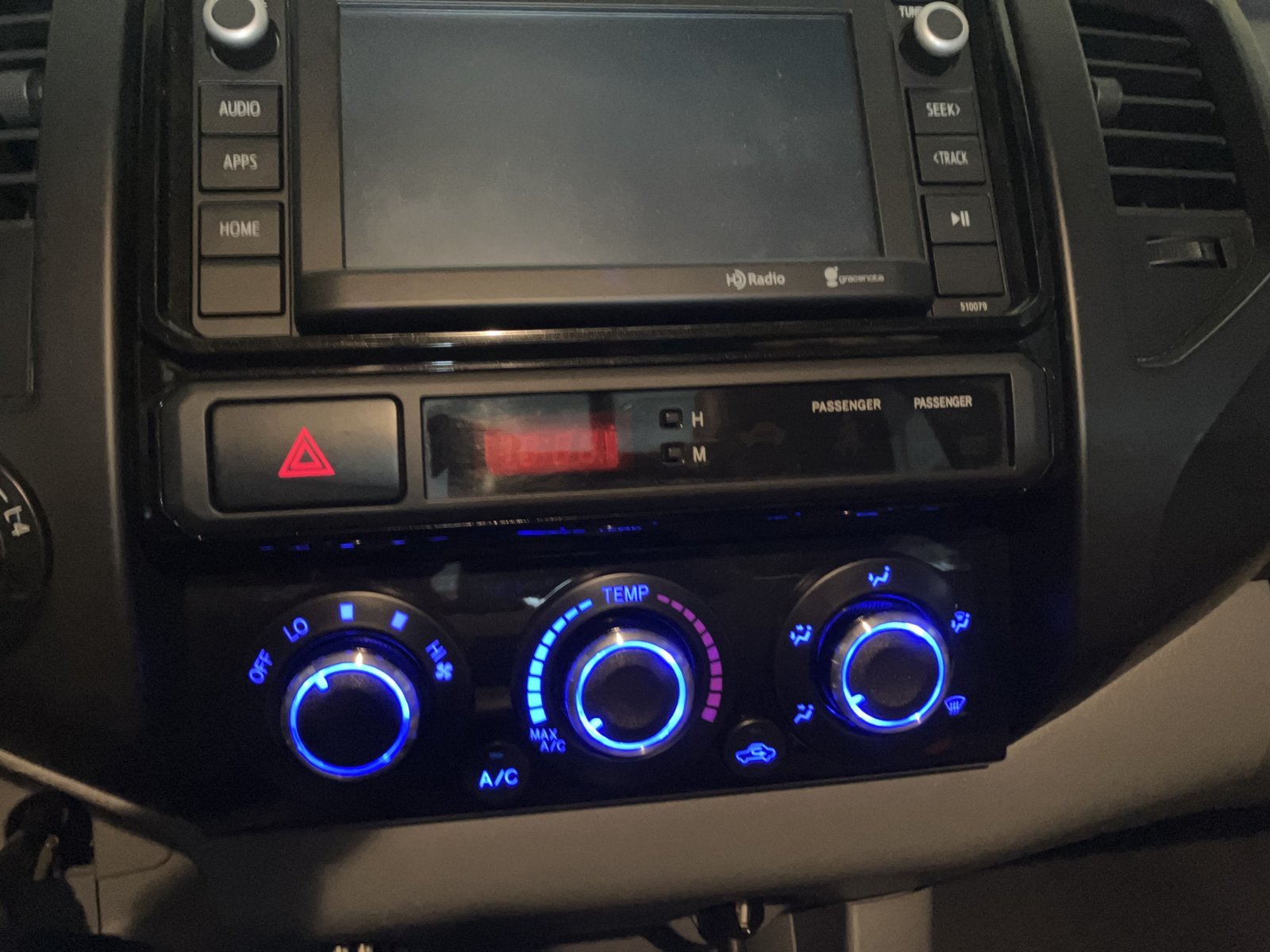

    Oh man that’s sick! My interior is all blue and white so I’d like that. I thought you weren’t able to change the lights in these?

    I didn’t do it. Must have bought it from someone who did.
    I would swap w you if you want, you handled the rheostat problem already?

    I could attempt to change my orange dash lights but I already got my homelink mirror in orange to match so not super stoked with having to swap that out too cause it’s a unicorn w temp.

    Yeah, I’ll send you the blue setup fully tested in my ‘05. I assume it will work perfectly in your ‘06 and my dad’s ‘06.
    I’d rather have white or orange than blue, looks a little loco to me.
    I really hate building the harness but I’ve got two so I can make one more.
