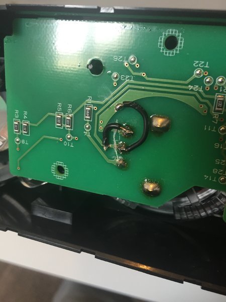

    2) You would think that was all it took - After I fixed the connector I plugged everything in. At first I was pretty happy. Everything seemed to work just as it was supposed to. It was hot out side so I was especially happy that the AC was blowing cold. Then I realized the temperature setting was set to max heat! I turned it to Max Cool and it started blowing hot! Damn, I can't live with that.
    So I did the only logical thing I could think of, I took my old controller and the new controller apart. Now I can read a basic wiring diagram and everything looked pretty similar from a 10,000 ft level. So I did the next logical thing... I swapped the two rheostats... and much to my surprise it worked! Cold was cold, hot was hot, and snozberries taste like snozberries.
    3) So real quick here is what I did - (Just a note both units are assembled pretty much the same way just take your time and try not to get too much of a buzz on from your beer.
    This one got me for a minute, I couldn't figure out why it wasn't coming apart after removing all the screws and pulling the three knobs off.
    To get to that little guy you need to remove the fan control connector socket. Gently pry back the tabs but be very VERY careful because there are some springs and a little red ball that acts as a detent for the switch.
    Remove the screw and replace the connector socket you just removed before those spring loaded parts go flying. Gently start pulling the tabs apart until you have separate the controller housing. If you still haven't removed the three knobs, now would be a good time. Pretty much repeat these steps for the other controller. When you are done you should have both circuit boards in front of you. Start heating up your soldering iron and check out the solder points on the rheostat for the temp control.
    The trick to removing the solder is to heat it up really good then quickly give the circuit board a gentle tap on your work bench. Do this enough times at each solder joint and you won't have a problem removing it.
    Just for reference here is a picture of the one I removed from the older controller. Damn, that circuit board looks primitive!
    Now put everything back together and don't forget about that hidden screw under the connector socket... or do forget it, its not like it will come apart without it.
    If anyone smarter than I sees some major issue with swamping the rheostat please let me know. As far as I can tell I only reversed the range of resistance. I will definitely update if I come across any long term issues.

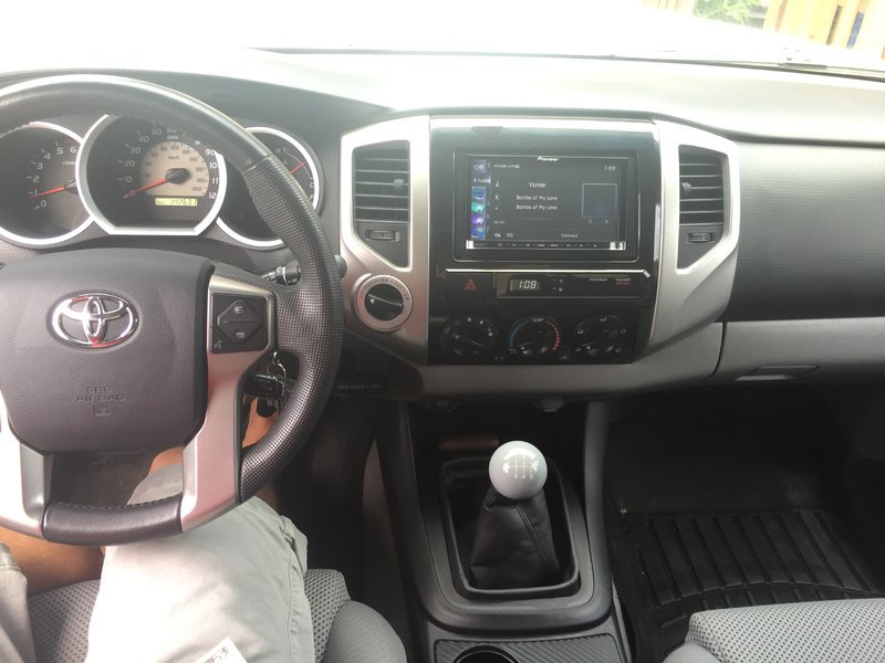

    Been a few days now and I couldn't be happier with the outcome of this swap. If you can get a good deal from a salvage yard or your lucky enough to find one on ebay I highly recommend this to anyone who want to update their truck. Here are some pictures of it in the dark. It's nice to finally have matching controls, just need to do something about that silver hazard switch now.

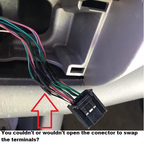

    I did this mod today
    Works great!
    Hardest part was asembling all the wire on the new plug. Those little pins can be a real prick.

    Nice I like you way better, it's probably worth noting that you scratched out the original contact between the rheostat pins just so someone not looking closely doesn't try and simply solder the wires.

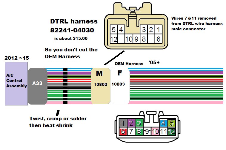

    I'm trying to understand your post. Does this harness allow you to swap the controls without using new wires and pins? What is there to crimp/solder?
  20. Sep 19, 2016 at 1:52 PM
    #20
    caribe makaira
    caribe makaira Well-Known Member
    Feb 13, 2011
    #51121
    11,799
    Caribbean, Puerto Rico
    05 PreRunner TRD Offroad AutoTrans
    Hood Struts, My version Fogs always ON, Map & Overhead Light Mod,
    Nope, you still have to crimp or solder new terminals to the end of the wires going into the A/C control. It's to not cut the vehicle harness. Think aftermarket radio harness to vehicle OEM harness. Do the work on work bench instead of in cab too.
