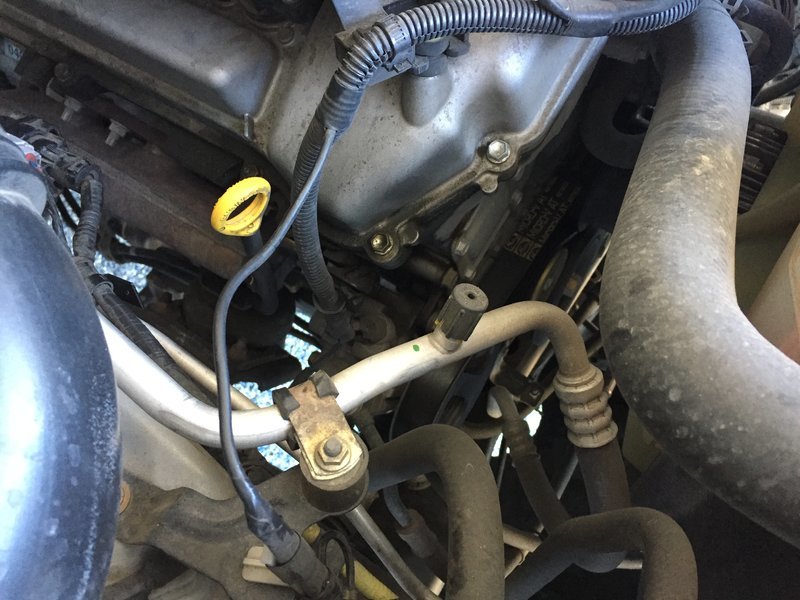

    Does anyone know the location of the low pressure a/c port is located at on a 05-11 4.0 V6?
  17. Mar 12, 2017 at 3:51 PM
    #37
    Justinlhc
    Justinlhc Not looking for a relationship
    Jul 7, 2015
    #158945
    3,513
    Right next to the dipstick
