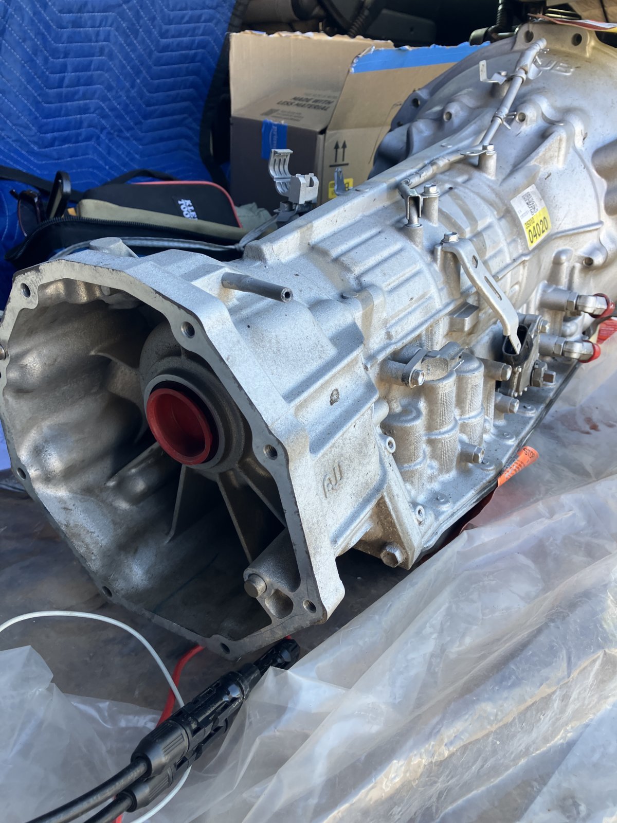

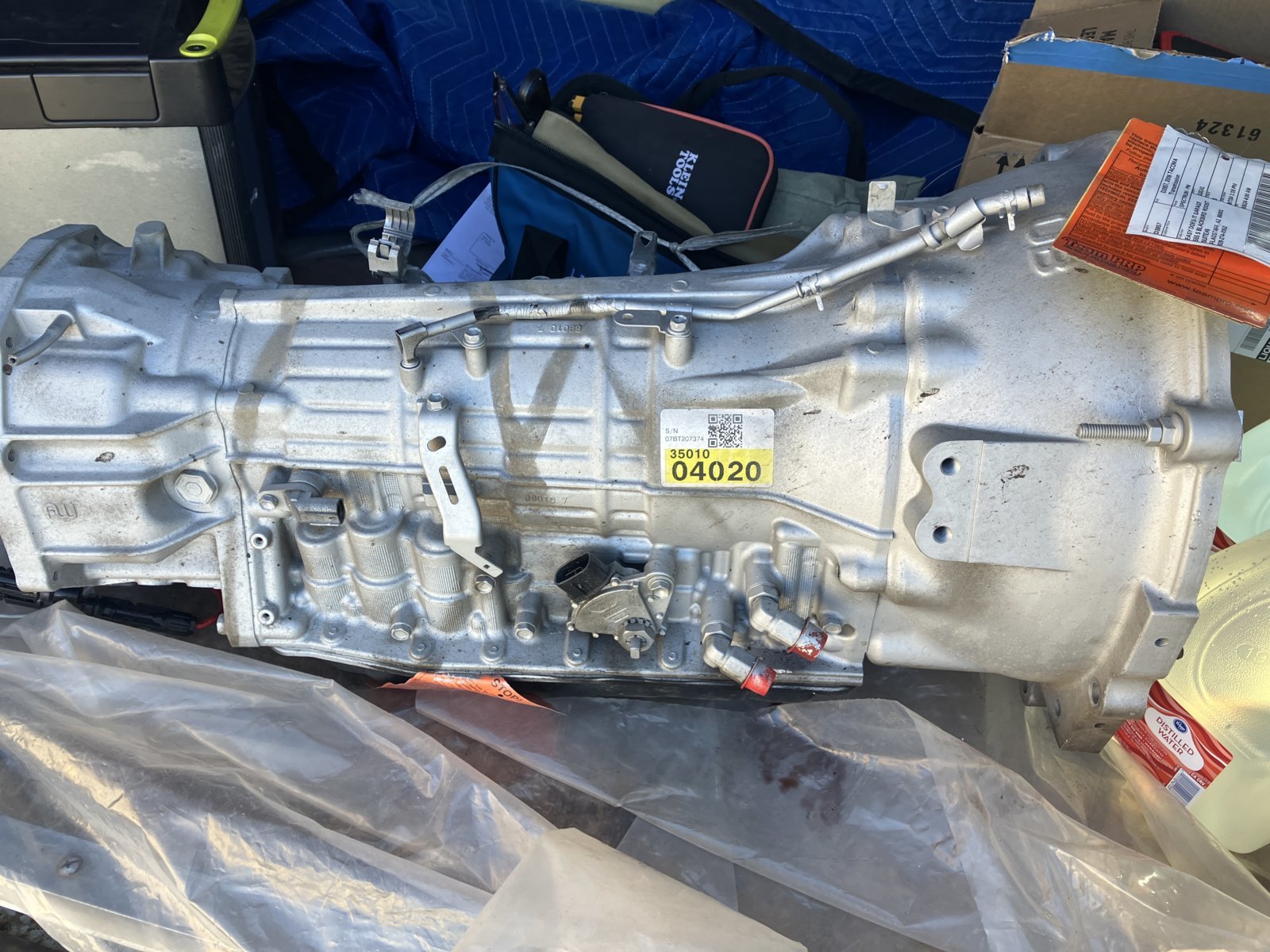

    I just ordered a used 750 F transmission but when I went to replace the output seal, it did not fit. The seal appears to be the same size as a 750 E. How can I tell which transmission it is by looking at the body?
    I have a 2006 4.0 4wd and i assume thats 750F

    A750E is 2wd
    A750F is 4wd
    The picures look like a A750F

    Well, it would certainly be a relief if it’s a four-wheel-drive transmission but why does the seal from O’Reilly for the 750 F be about a quarter of an inch wider? And the one for the 750e is the same diameter Imalbeot a bit thicker
    Are there multiple variations of the 750 F that would have different seal size?

    The sticker says 3501004020
    That part number comes back as 4WD transmission for a 2005-2008 Tacoma with 4.0 engine.
