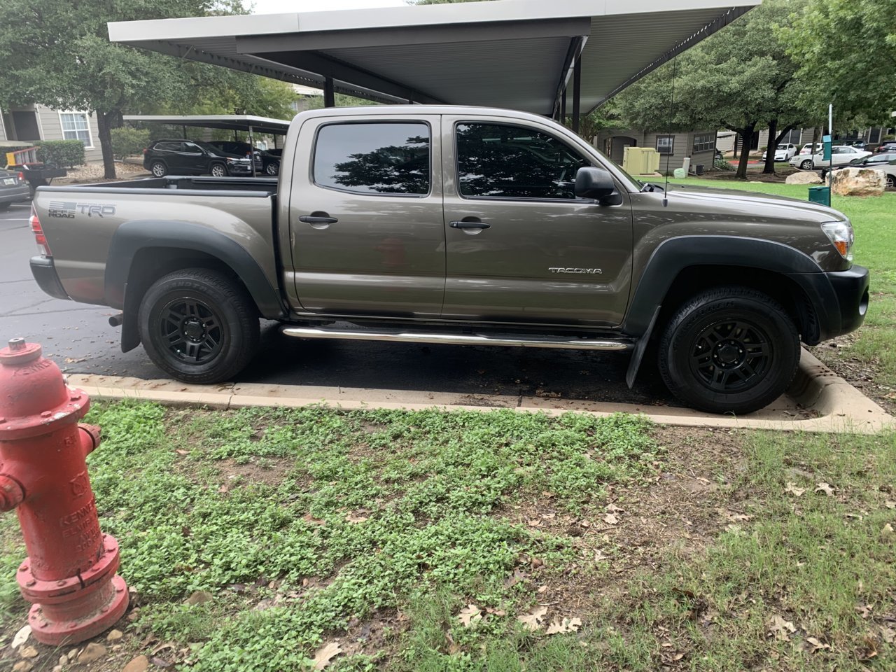

    Also here’s a pic for reference

    If you dont have a rear locker...you do not have an off road model. Regardless over other bells and whistles...no locker no Off Road model.
    Im gonna go out on a limb and say that is not an OR.

    For 2008, the Tacoma offers a Rugged Trail Off-Road package on V-6 models with white, black, or silver exteriors. The package consists of a locking rear differential, progressive-rate front springs, Bilstein shock absorbers, an anti-roll bar, 16-inch aluminum wheels, black fender flares, a skid plate, all-weather floor mats, and TRD (Toyota Racing Development) graphics. Otherwise, the Tacoma is unchanged for 2008.

    That TRD sticker looks suspect too. I don't think any came stock with an American flag on them. Looks aftermarket.
    Doesn't mean the stock sticker wasn't replaced... just...

    Definitely a custom made decal. You can have someone make whatever your heart desires

    Yep, definitely not a off road. Do you guys think I would have any luck getting the dealership to do something for me, such as renegotiate a price, or does the contract mean I’m screwed. Pretty frustrating. I even believe THEY thought it was an off-road. But I don’t like paying the off-road price for a base model.

    That is an aftermarket TRD sticker on the bed

    With the black bumpers and flares, it’s not even a SR5, right?
