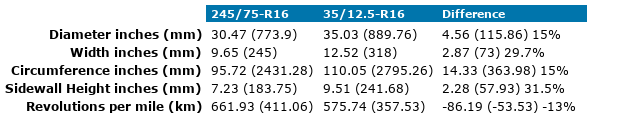

    yea if the speedo is correct anyway that's what it is not sure if it is right or not.

    yea your speedo is gonna be off

    For sure and you should be spinning lower rpm's anyways if you have 35's correct?
    Regearing should just be for power and take off's?
