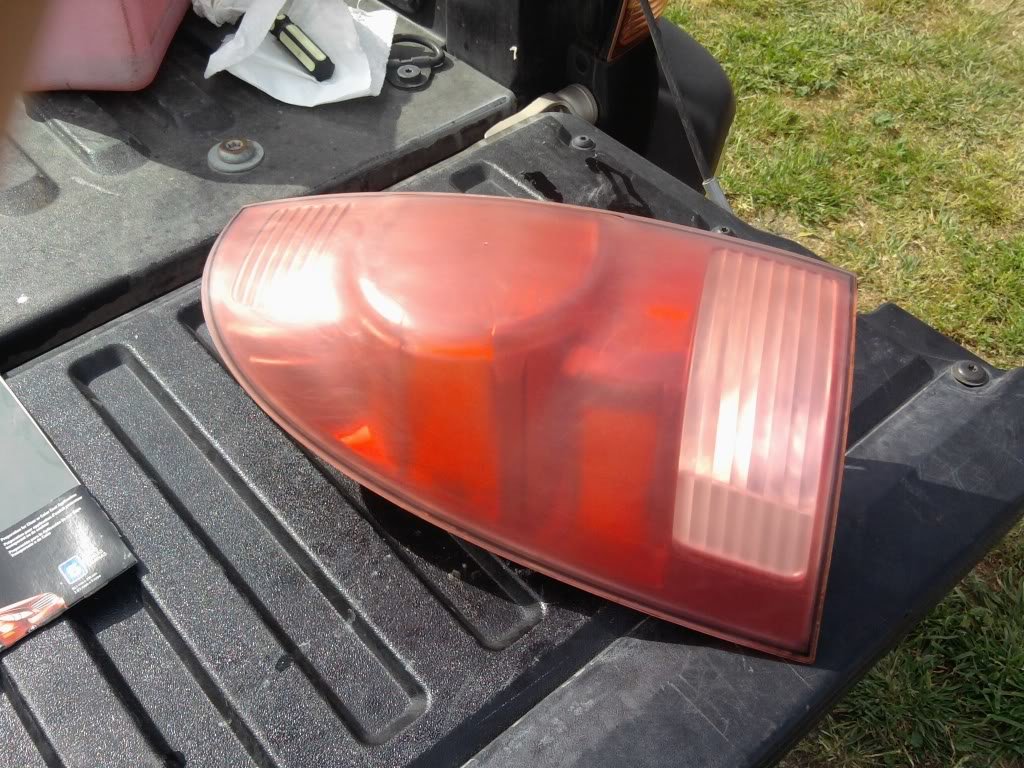

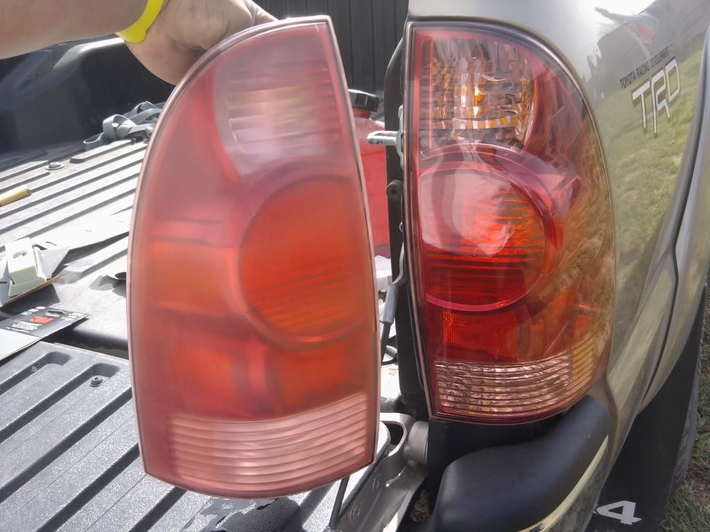

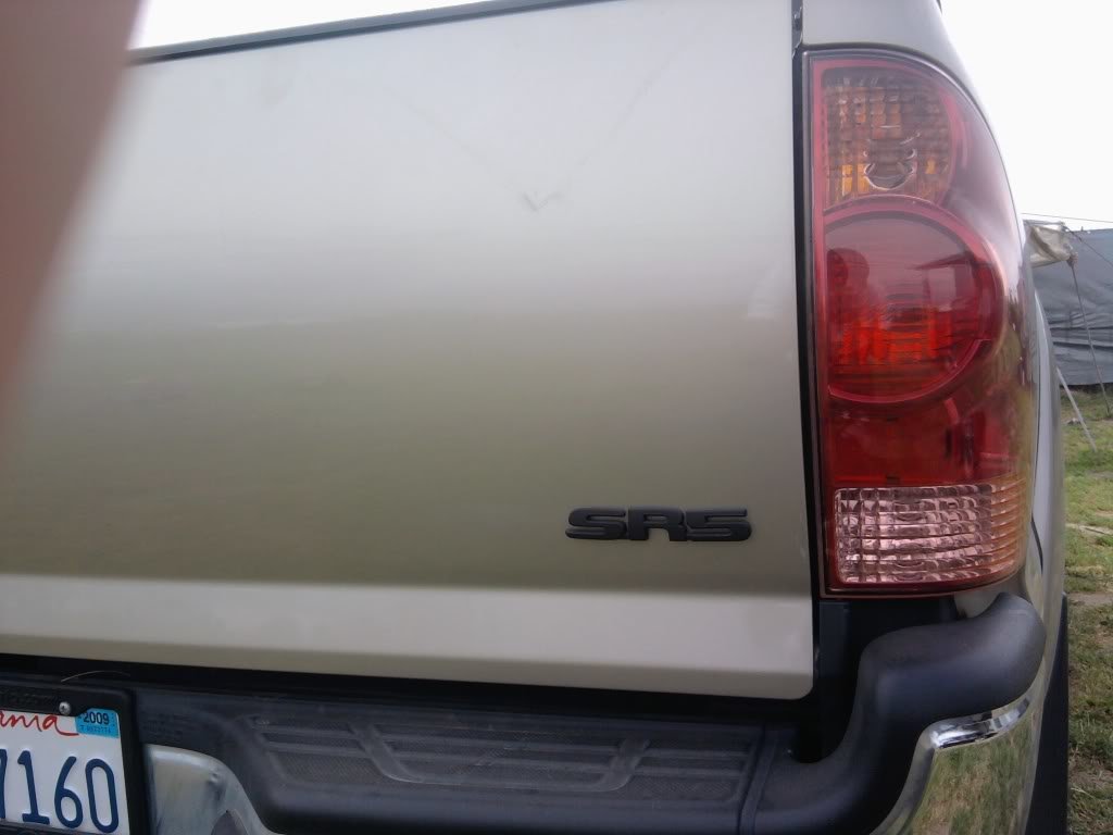

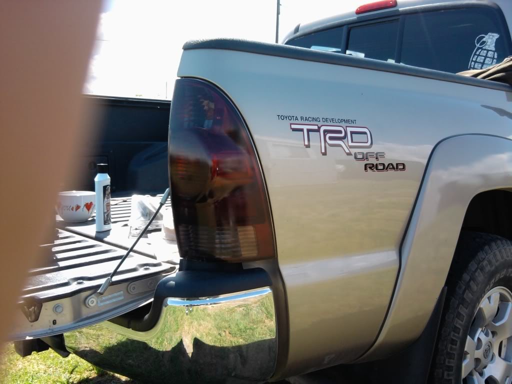

    So we start off with the tail light, untouched in all its stock glory

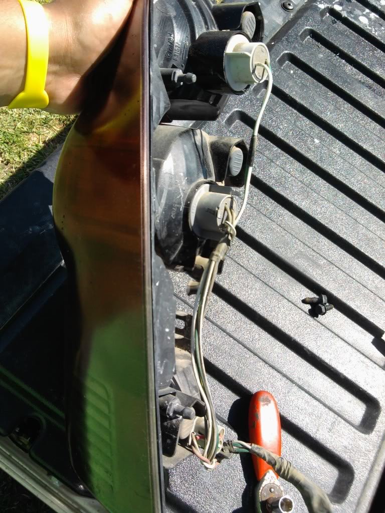

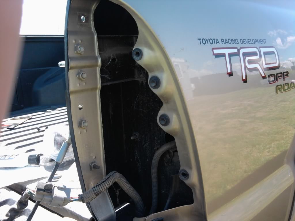

    So to remove the rear light you will use the 10mm socket
    --There are only 2 bolts per side.
    --They are the highest and lowest ones, leave the other in between alone as they do not hold the light. (sorry no pic)
    Once those are removed it time to pull the light out. There are 2 prongs that hold them in and they will take some force to get them to let go.
    Then disconnect the light bulbs with some simple twists

    Take the 800 grit paper and start to sand the light while using water. (I recommend to let the papers soak in water while removing the lights, this makes them a bit more flexy and easier to work with)
    --Between different grits, wipe down the light and dry it to see that you have got the whole light.
    Once you are done with the 800, start to use the 1000, then drop to the 2000 grit paper
    --The 2000 will make it look like it has a flat smooth satin look.

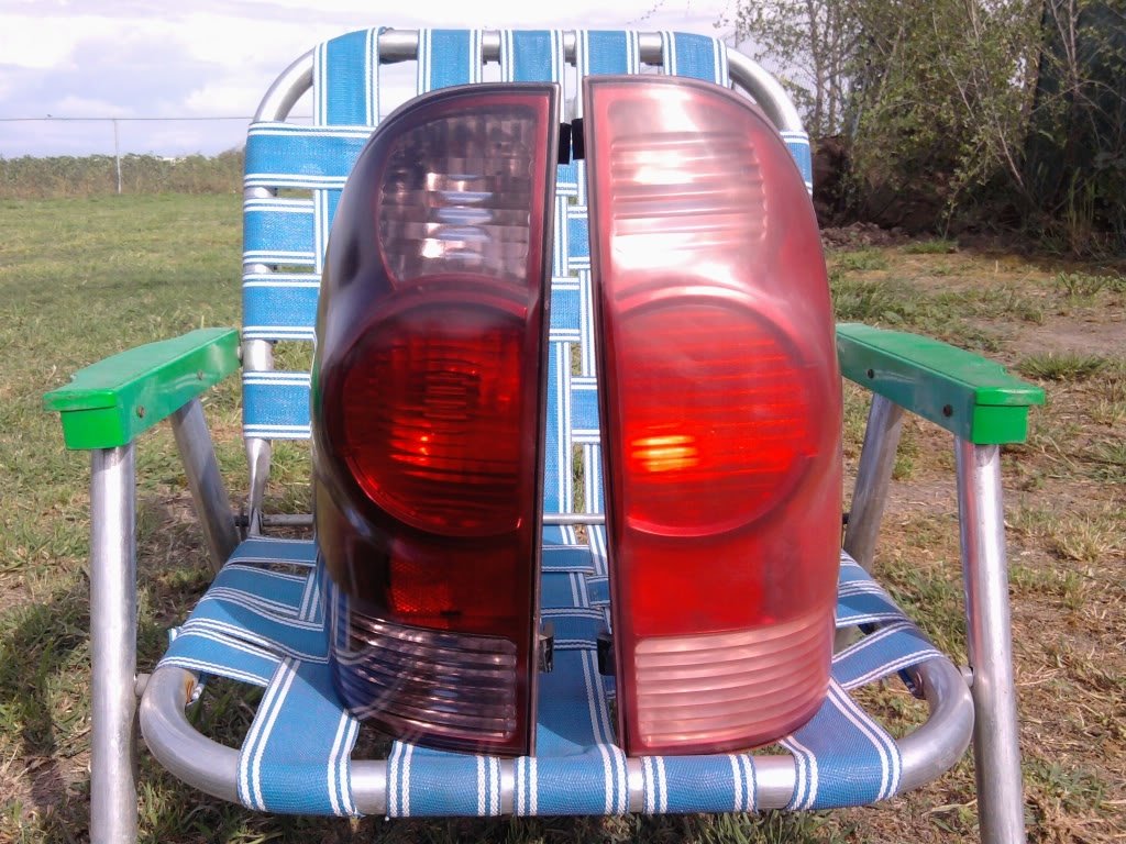

    Here is the difference after one coat

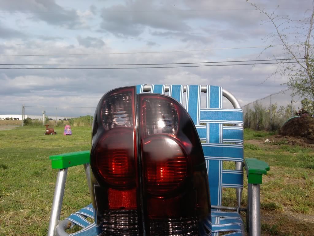

    ***For best and most even results, stand the sanded lights up next to each other and spray across both to get the same coverage on both.***

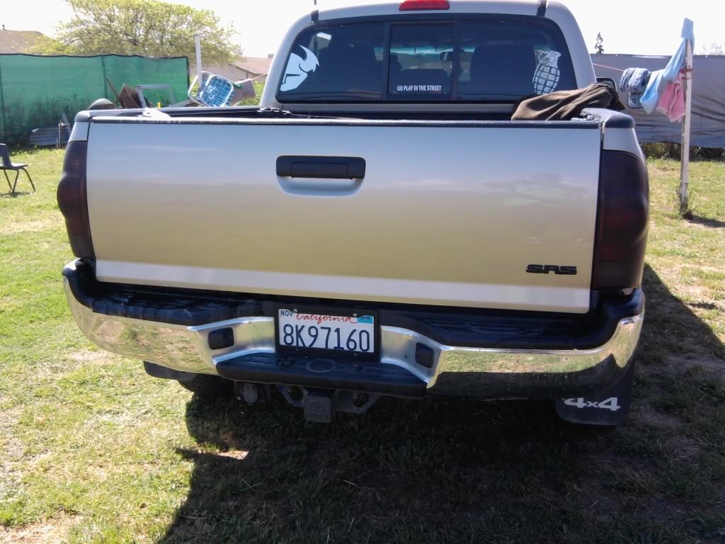

    Sun's position made them look a bit different from each other but they where even:D

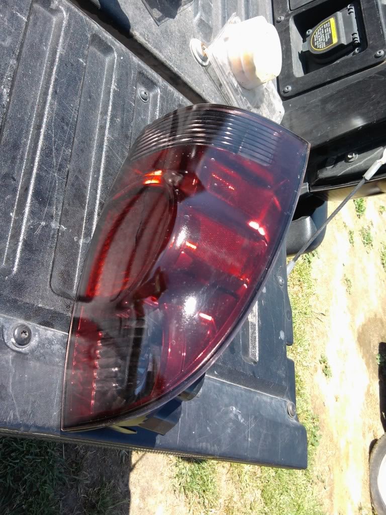

    Here is one after 3 coats and a test to see how it would look
    Once you are satisfied with the level of tint let the light dry to the touch, then cure in sun light for about 45-60 min.

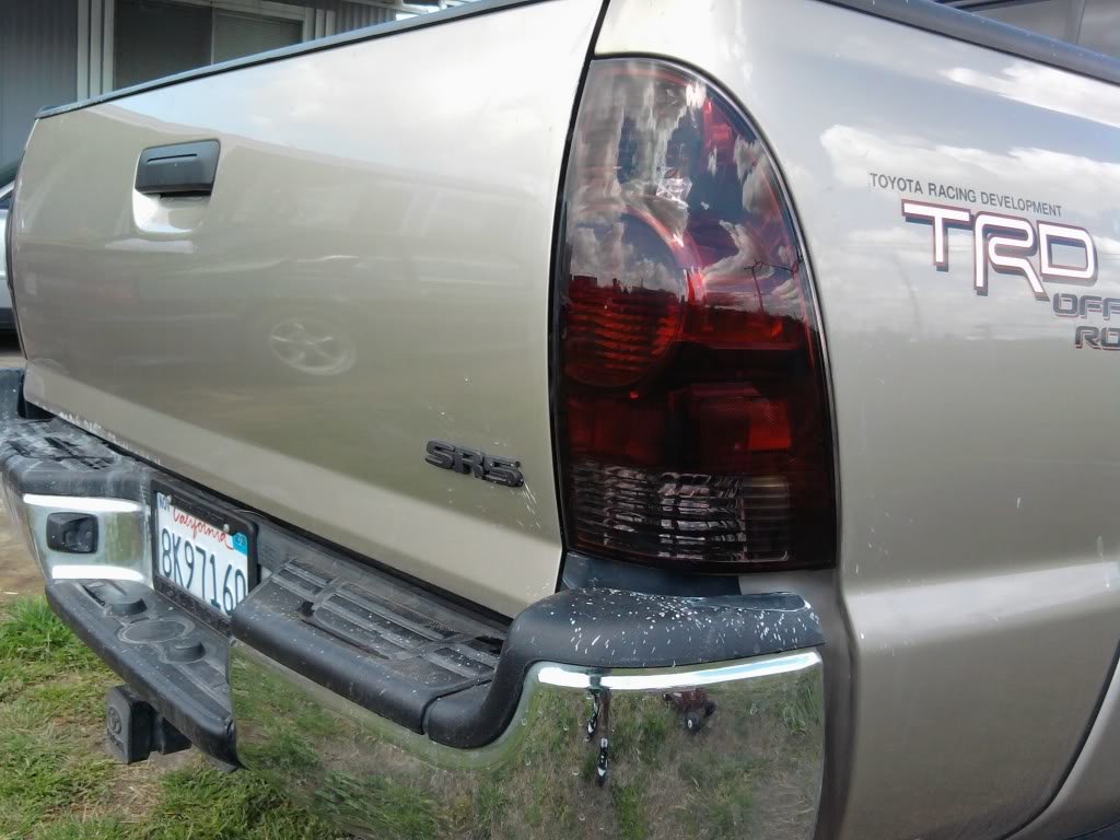

    Here it is with 5 coats of clear. Ignore the water spots lol.

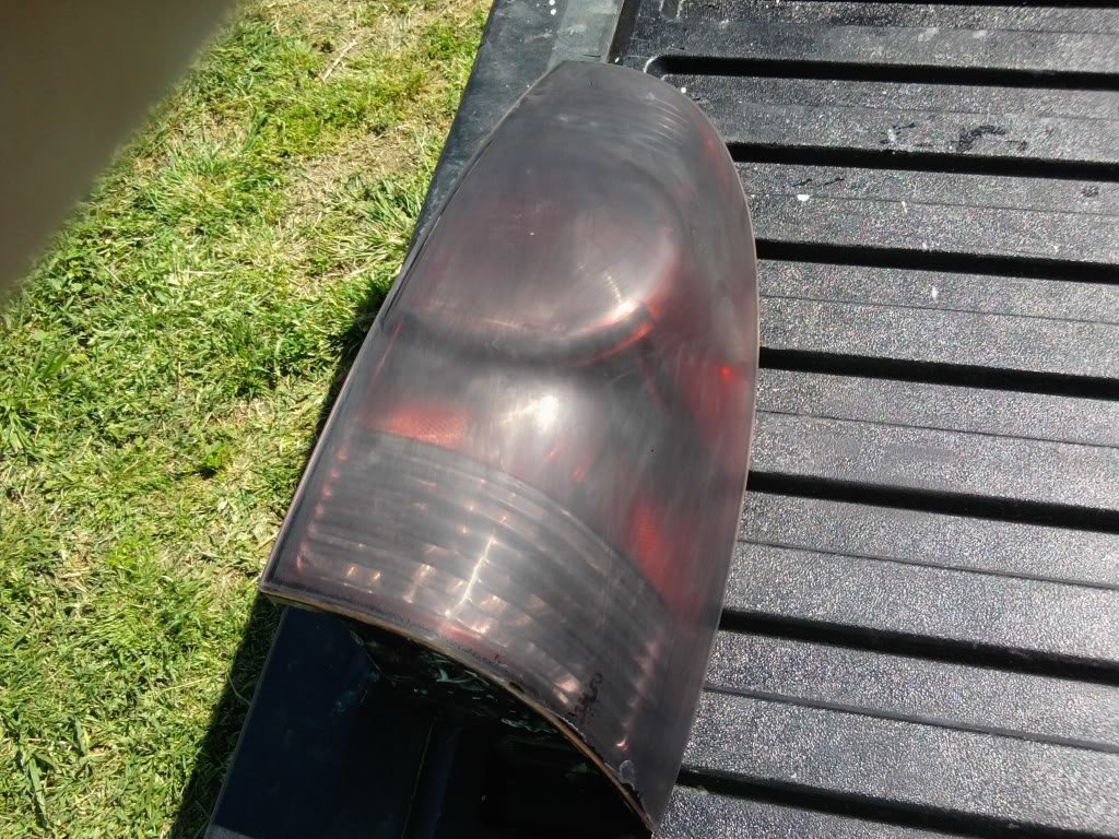

    Once COMPLETELY dried, repeat the sanding steps in the same order, but this time use more strokes with LESS FORCE. Remejber to have patience at this level.
    This sanding step will get rid of that 'orange peel' effect/texture.
    And here is the clear coat sanded.

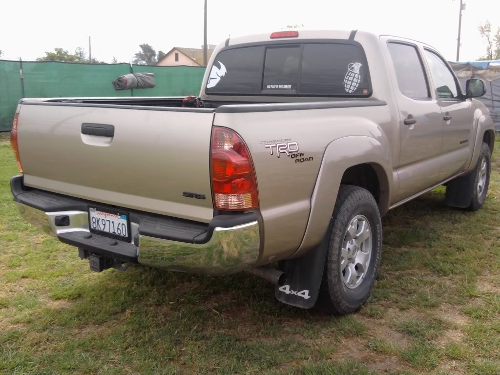

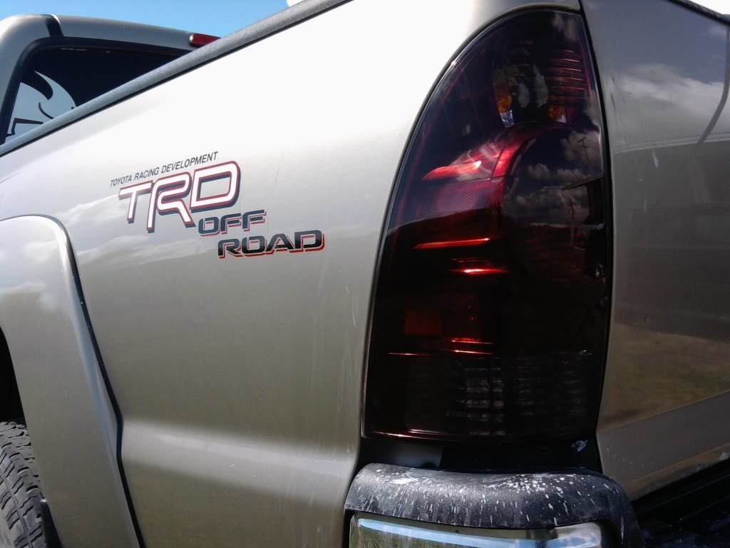

    Here is the finished product:D
    The looks I have gotten from other taco owners is fun, I have even bee asked to do a pair:D:D
