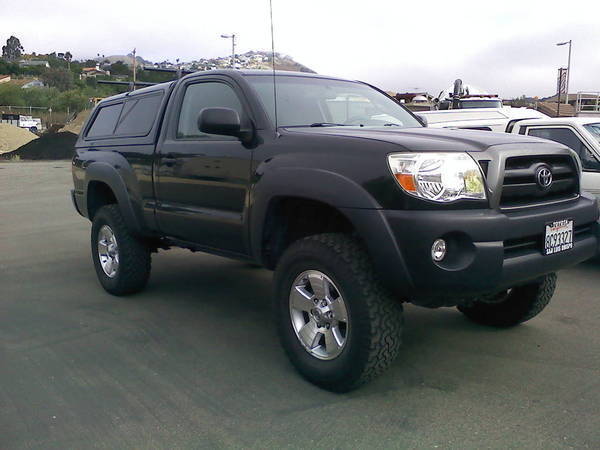

    I finished my install last week and it only took me about 6.5 hours. I did have a full workshop to use but what a fun time it was! I have never done a project like this before and this write up made it idiot proof. Thanks again! I would prefer using 2 c-clamps over the vice grips to clamp the leaf-spring bunch together. I would close each side little by litle to keep the pin bolt straight. That was really the only challenging part I had to do. I also took my front coil set up out and gave them to a mechanic's shop to intall the new coils. They had the REAL tool for the job. Only cost 40 bucks. My suspension settled out after a few days. It started off pretty stiff, but now its awesome!!
