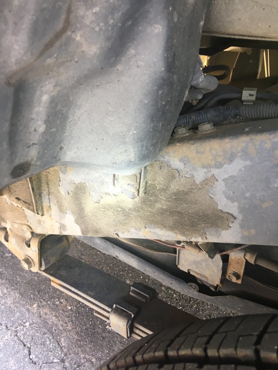

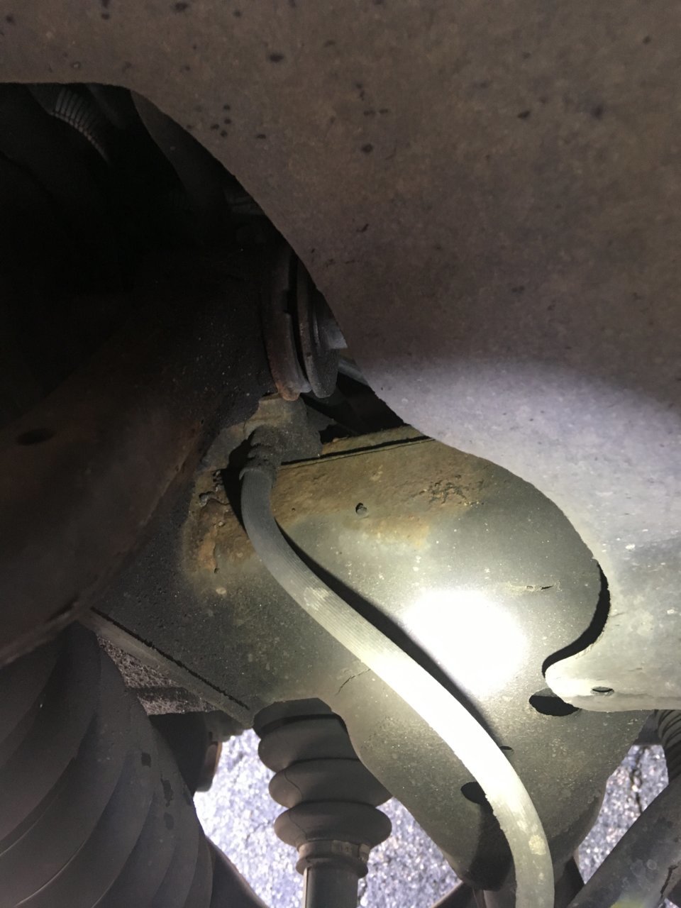

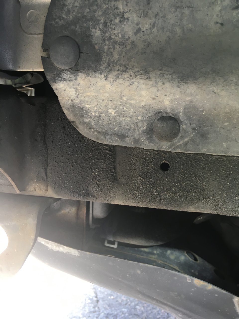

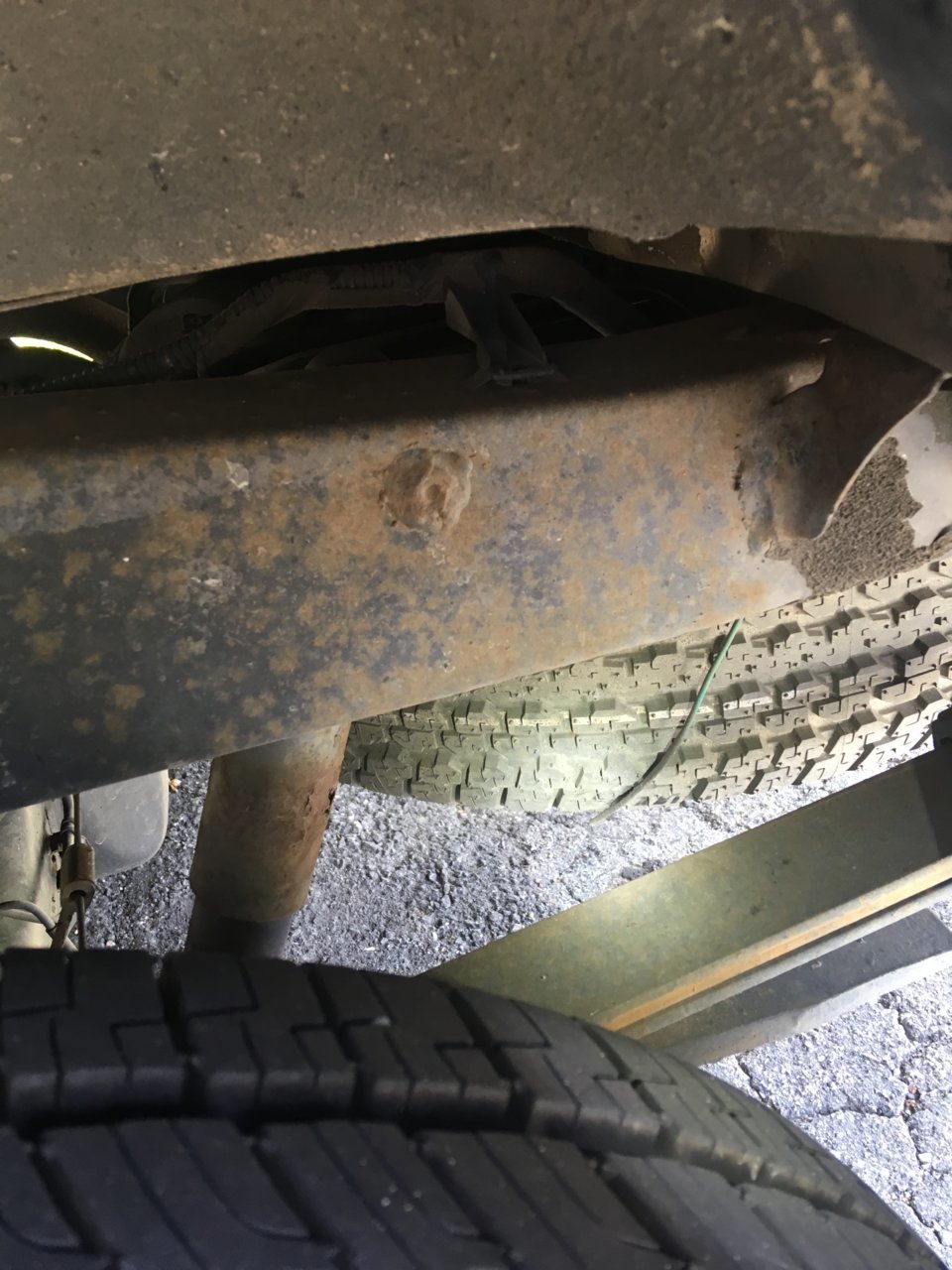

    I worked the graveyard shift last night and read everything I could about putting rust prevention on my frame. I did get it sprayed by Toyota, but that’s starting to come off. Here are some pictures where you can see where the spray Toyota put on is perfect and some where not so much. Any personal experience would be great with whatever products y’all recommend

    Most common theme I see in here is wire brush as much of the rust off as you can, spray area with rust conversion spray paint, treat with fluid film once or twice a year.

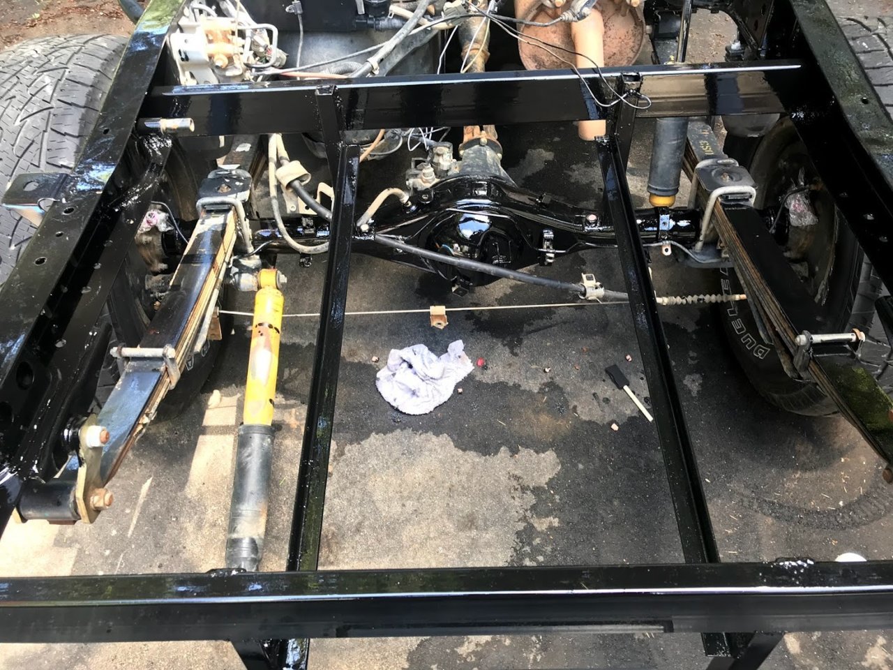

    I recently POR 15'd the rear part of my frame and my axle housing. I only had surface rust from driving and camping on the beach in Baja. It turned out pretty well. At some point I'll need to paint the front of the frame.
    Before I go down there again I'll coat the frame in Fluid Film

    How hard of a project was this? Looks like this is the route to go as far as getting the whole frame
  9. Jul 17, 2019 at 6:38 AM
    otis24
    otis24 Hard Shell Taco
    Dec 3, 2012
    #92402
    6,484
    Mark
    California
    OtisBound Outdoors Bodonkadonk
    OtisBound Bodonkadonk
    Most of the work was in the prep. It was mostly surface rust so that wasn't too bad.
    I took the bed off and I have a second gas tank where the spare used to be so I took that out. The second tank got painted as well. I removed all the bolts and nuts in the axle housing and the cross member the spare hangs from. I plugged all the bolt holes with ear plugs. Eventually I'm going to replace my OME leaf springs with either Deavers or custom Alcans. I'll paint the rest of the housing then.
    I pressure washed everything to get the bulk of the dried mud and sand off.
    Next I wired wheeled as much as I could.
    Then I used simple green and green 3m scrub pads and scrubbed everything twice.
    After that I used the POR15 degreaser and the POR15 metal prep.
    Lastly I painted it. I waited until the POR15 was just slightly tacky and added a second coat.
    Some things I learned along the way -
    I used maybe a third of a quart size can. A little goes a long way. Get a bunch of the 2oz cans. Once a can is opened and you pour some out when you replace the lid you'll never be able to open it again. Put 2 layers of plastic wrap on the can before replacing the lid to prevent this. The smaller cans will reduce the need for this.
    Read up on how this stuff cures with humidity.
    Paint out of a small cup, not the can. Any debris or unnecessary air on the paint in the can will contaminate it.
    I used cheap foam brushes I got on Amazon. Maybe spend a little money and get less cheap foam brushes.
    Make sure you have gloves, this stuff stays on skin for awhile. Wear a hat. I got some in my hair. I just cut that hair off.
    There are lots more tips on the internet. These are the ones that I thought of right now.
