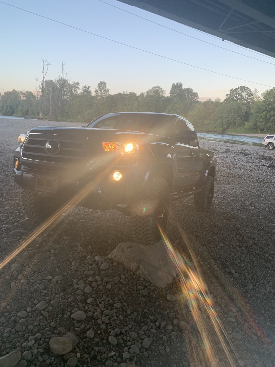

    This is my fitment now. I think the rubbing is worth it :)

    Fitting 33’s on a stock truck is going to rub, unless the are 255’s. You can try replacing the UCA to a more adjustable one like SPC. Then get an alignment with the caster pushed forward. Ypu will probably still rub until :sawzall:

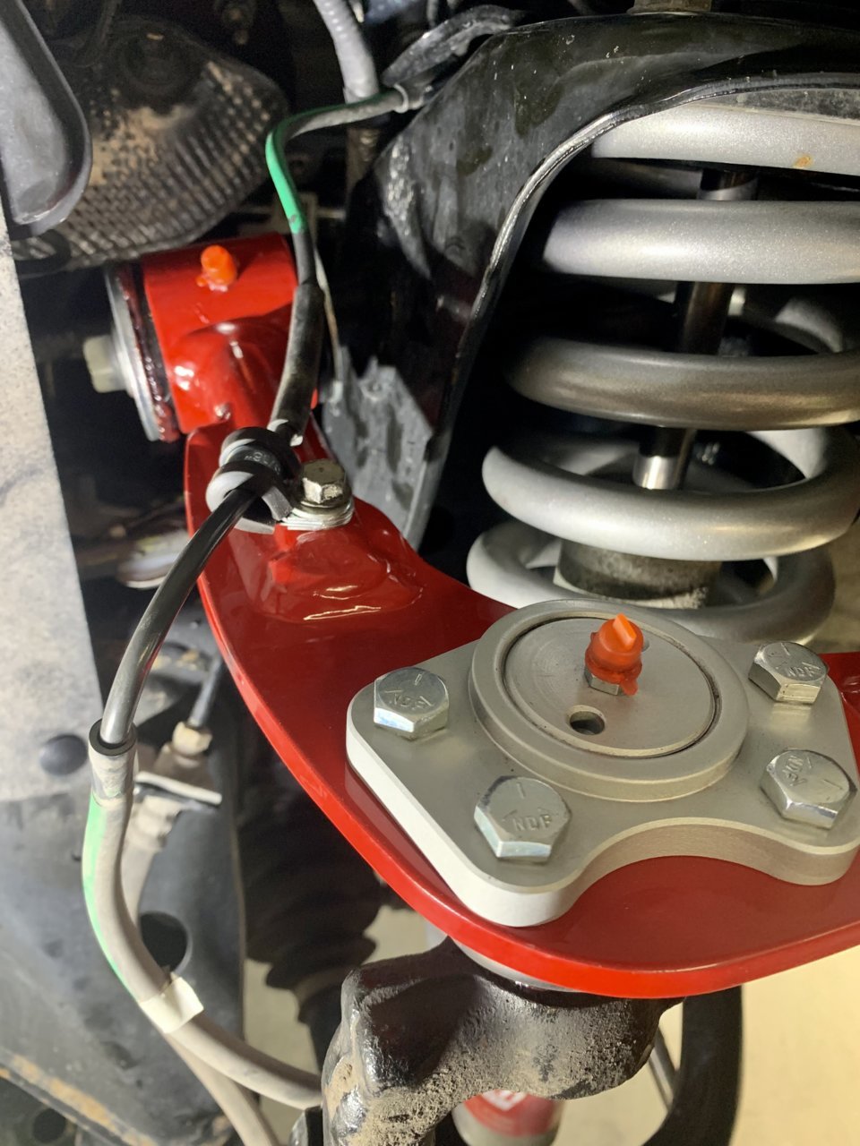

    If you’re doing your UCA homework, JBA are pretty hard to beat. Made in PA with a damn good warranty. Check them out.
