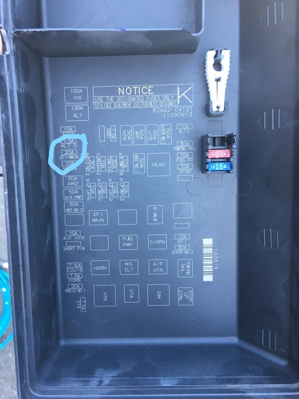

    Remove your ignition fuse..i.e. take away power to your coil and plugs

    Just pull your 20A EFI Main fuse then turn over the engine to ensure you bleed any residual fuel pressure.
