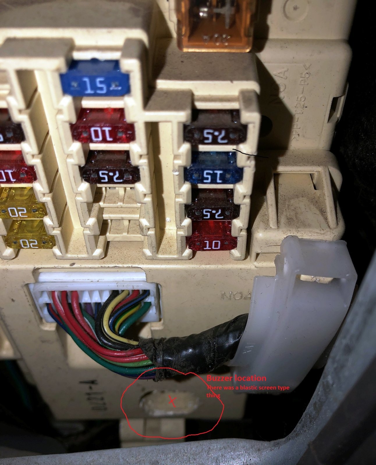

    I looked and looked and tried! First thing is my plugs are under the drivers side and on 2 wire one 4 wire. Unplug option suggested did not work, no key, key in, key out etc...
    So ha! I found my solution and easy! At the bottom of the fuse box will will clearly see the buzzer grill, just like a speaker, simply take a very small screw driver and break the grill you will see the round black buzzer, then inset that screw driver in the hole that is found in the center, push and wiggle just a little and vola! buzzer broken!
    I did not get any codes or other problems doing so.
    God I'm happy, no more annoying buzzer yayyyy
    Ending this reply with = I am not a mechanic and this is simply what I did and it worked (finally) I take no responsibility for what you do nor what ever happens if you try this.

    https://www.tacomaworld.com/threads/3rd-gen-door-open-key-ignition-bell-delete.485704/#post-14882872
    This guy took the beeper apart, but all you need to do is pull the connector. piece of cake, easy-peasy. it is under the steering cowling right next to the key if you have a manual. my guess is that it might be in the same spot even if you do not have a manual

    Ha not so true! Mine 2001 Toyota Tacoma 4 door SR5 the buzzer IS inside the breaker box :)
    I'll check and see if I can get a pic
  13. Feb 23, 2024 at 12:29 PM
    #53
    Tacoma red X
    Tacoma red X Member
    May 20, 2022
    #397636
    12
    C
    2001 4 door Tacoma V6
    You say that like I'm dumb. I'm no dummy! and it's not my first rodeo.
    Darn I tried a short video but still too long. So here's a pic. See the bottom circle below, well that is the buzzer location on my 2001 four door V6
