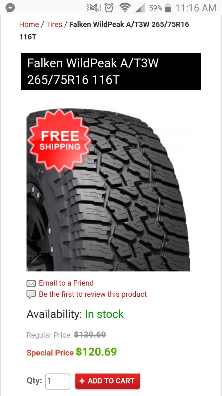

    Found this Performance Tread
    $120 a piece 265/75/16 Falken Wildpeak A/T3W.
