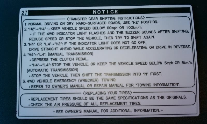

    Hopefully this helps. It is the slip that is in the visor for my 2003 double cab.

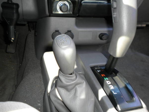

    ADD were both bush putton and j shift.

    Maybe the automatics had the button on the lever and the manuals were lever only? I had an '01 automatic, like the OP... The button engaged the transfer case (and ADD) into H4... then the lever was moved to get into L4.

    Nope. I have test-driven 01 5-speeds that had the button (straight shift pattern) and the non-button (J-shift pattern) transfer case shifters. Mine is the latter. Some trucks got one type of shifter, and others the other, and I have not been able to determine why this is so, but I haven't tried hard either, because I don't care. Probably some production quirk.
