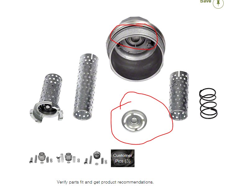

    Is there supposed to be rubber washer under the portion of the press-release mechanism for the drain bolt? I'm not talking about the rubber washer under the drain bolt itself, or the one on the upper part of the housing.
    Every time I unscrew that drain bold, oil just starts dripping/leaking out, and by the time I get the plastic cap in I've got oil down my arm and on my skid already. I even purchased the motion tool and it still makes a big mess everytime. When you guys unscrew the drain bolt, nothing leaks out?

    I did not remove the inner parts on my OEM Aluminum...and it does not leak.

    Mine doesn't leak either as I installed it as Toyota packaged it.
