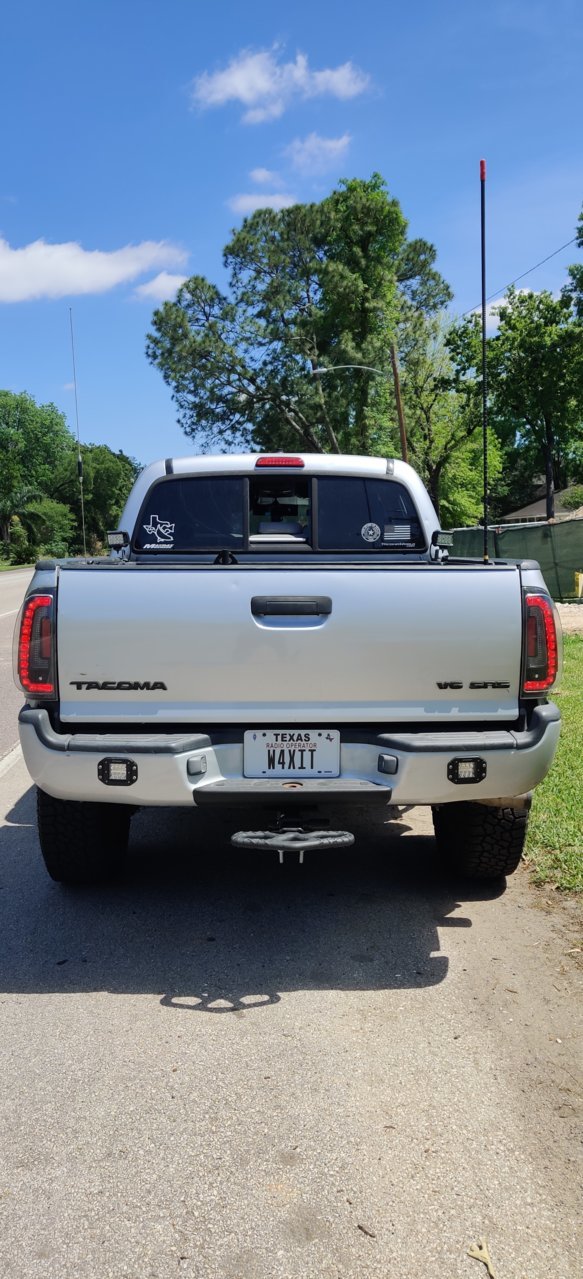

    I have my reverse LEDs running to a relay which is triggered by the reverse light wiring and a switch. Both are diode isolated so I can switch on my rear lights independently than activating through reverse. My upper side shooter pods and bumper LEDs all turn on during reverse.
