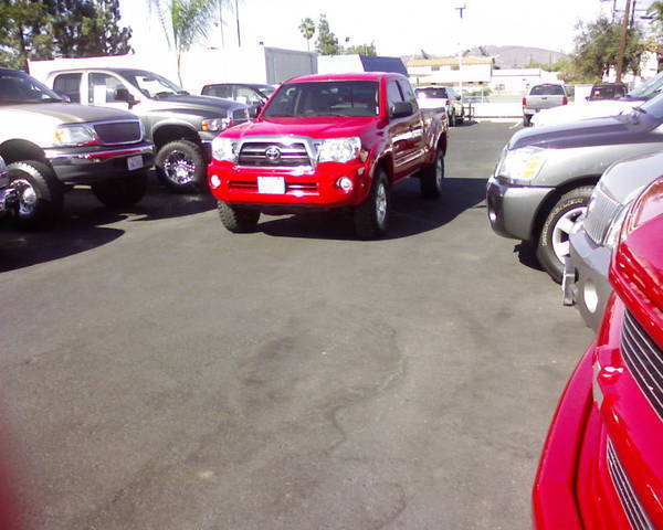

    I got mine on a fluke. I knew i wanted a tacoma and saw it on the lot and loved it.. actually.. heres after my first test drive. I walked away that day and came back 2 days later and haggled her to be mine!

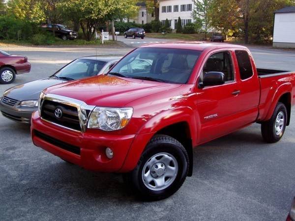

    Love that truck. I would send a pic if I could only figure out how to attach it to this site.

    Here's my truck, taken a few years ago outside my apartment. Thanks unholycumulus for the tip!!
    Jeff , 06, V6, 6spd, SR5

    Fixed it for ya ;)
