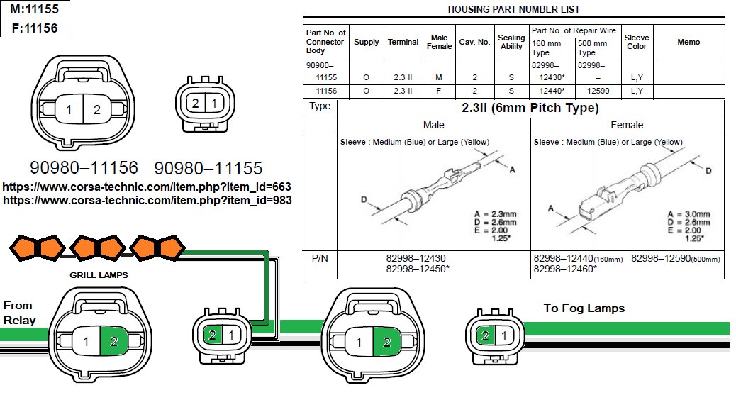

    I just recently got the Taco Vinyl raptor grille and was hoping to wire the raptor lights to my fog lights. I wanted to be able to turn on and off the raptor lights along with the fog lights, independent from the head lights... unfortunately, it seems that this may not be possible from what I've noticed.
    If anyone here knows if this is possible and/or how to do so, please let me know!?!

    Buy parts and assemble a T harness to the fog lamp connector on the lower frame in front of the radiator. (EN1)
    or get these:upload_2020-12-6_7-6-6.jpg
    Green is (+), White with black stripe is (-).
