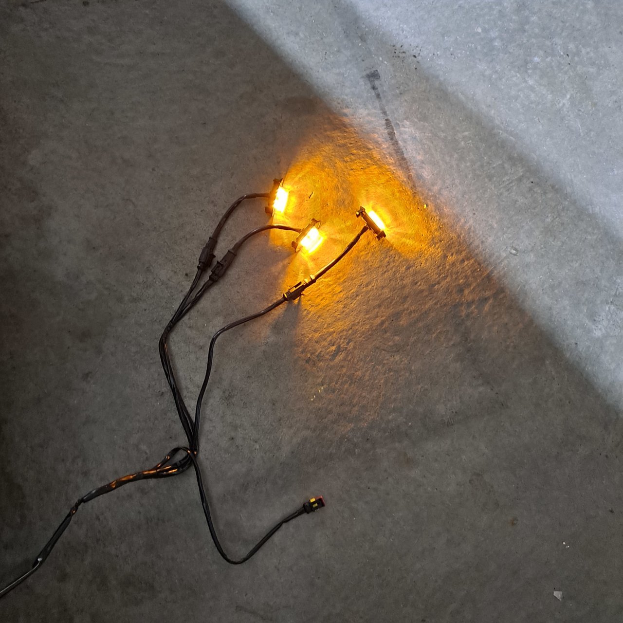

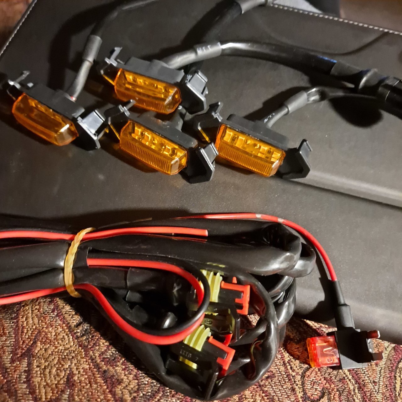

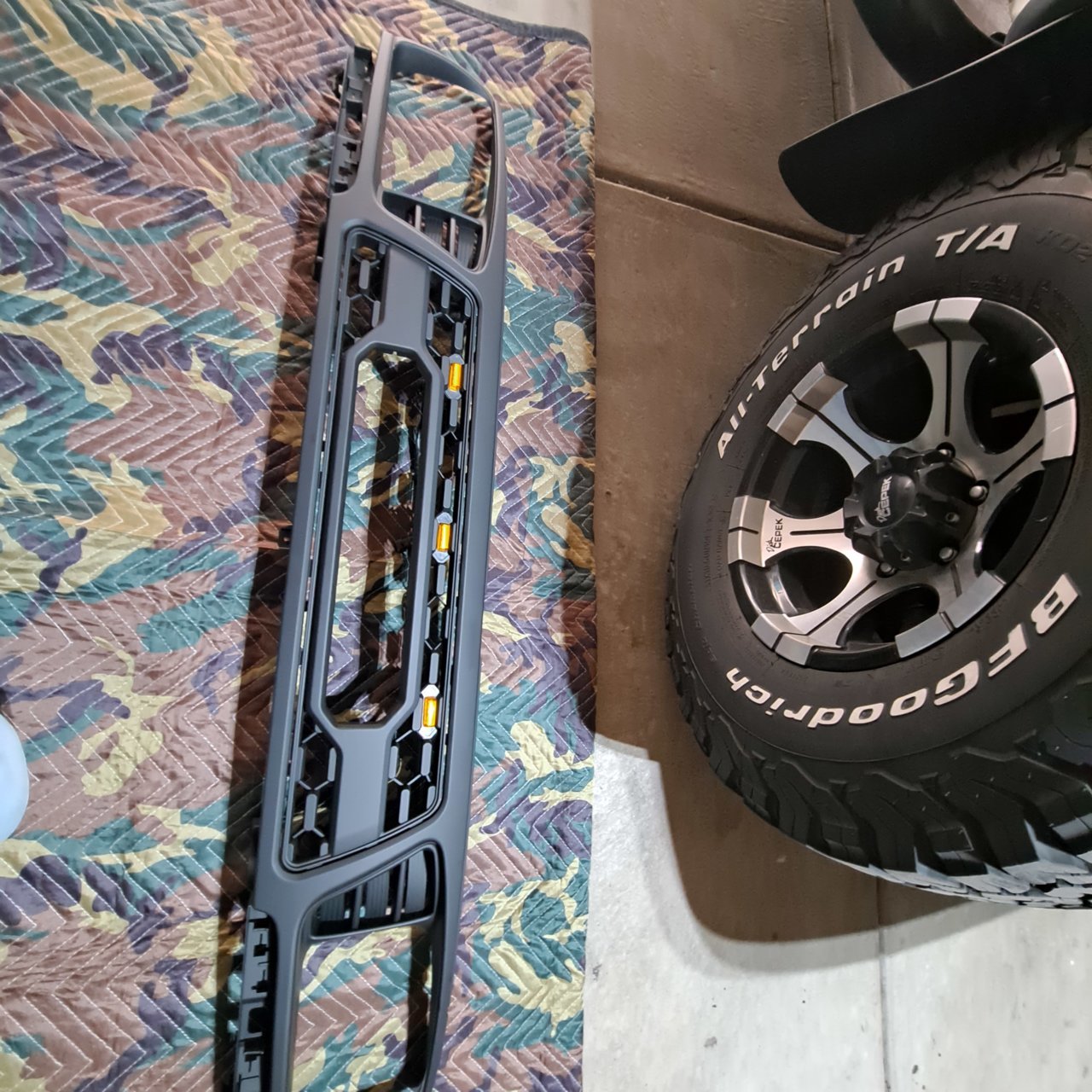

    Where would I run raptor lights, the power wire to for power to turn on when running lights are turned on?
    3 LED lights so not alot of power drain.
    If I tap into one of the fuse box fuse will it be consistent power or only when that fuse is activated by that device like headlights.
    EDIT:
    Answer is,
    The 10 amp panel fuse actually will work, just tested it,
    It has no power at the fuse box till you turn on the parking lights.
    So that’s my answer, will tap into that fuse.

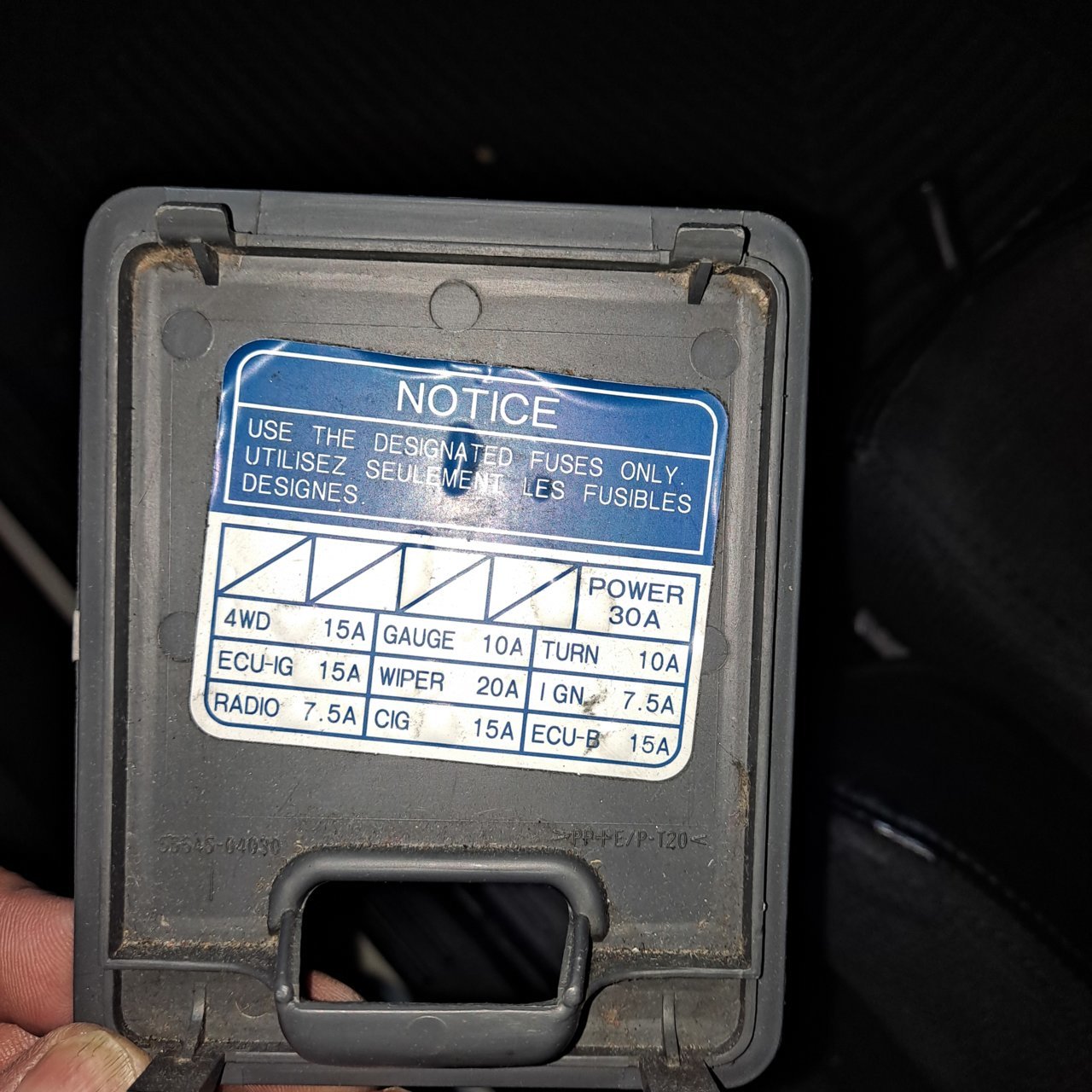

    ECU-B is the fuse that your daytime running lights will be operated through, if that helps.
    I would think that if you want them on with running lights you would want to trace the actual running lights wires after the fuse and tap directly into that running light wire, so that if a short happens, it still gets caught by the fuse.

    ECU-B controls;
    SRS airbag warning light, daytime running light system, cruise control system, anti-lock brake system

    Ok, thanks, so if I tap into the ECU-B fuse with an add a fuse for the lights because it’s not a dedicated running light power wire like the headlights fuse I’m guessing that will not work?
    I wonder if I can tap into the running light wires going to the front running lamps then without drawing to much current on the stock fuse?

    hmm, I would think that the draw on those would be small enough to basically piggy back off the existing fuse for ecu b.
    I would imagine that You could also do it off of the 10 amp “tail” fuse, if you wanted to do it in the fuse box under the hood. That controls tail lights and license plate lights
    I think the tail lights and license plate lights also come on when you set the switch to daytime running lights if I remember correctly? You’d have to double check.

    Yup, I just stripped back the wire plastic to expose the wires and they are super thin.
    Can’t draw much current at all! Being LED.
    It has no power till you turn on the parking lights.
    So that’s my answer

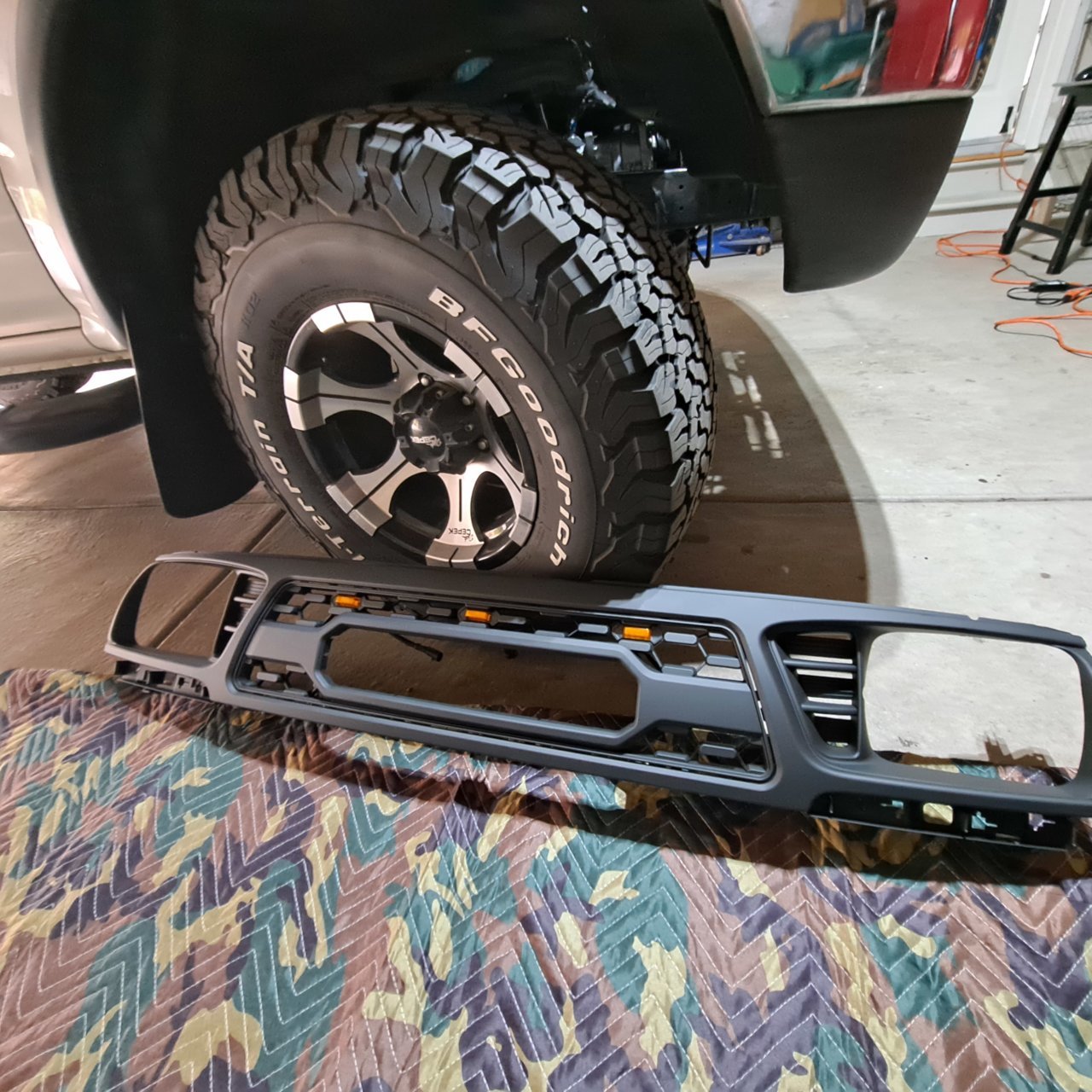

    I'm going to see how I like this grill installed.
    Waiting on the center TOYOTA section

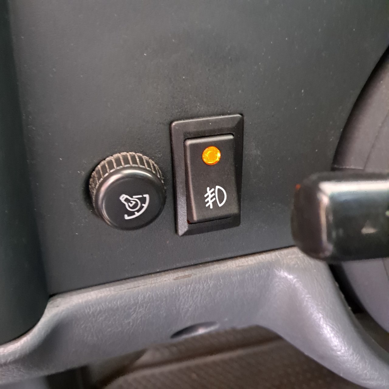

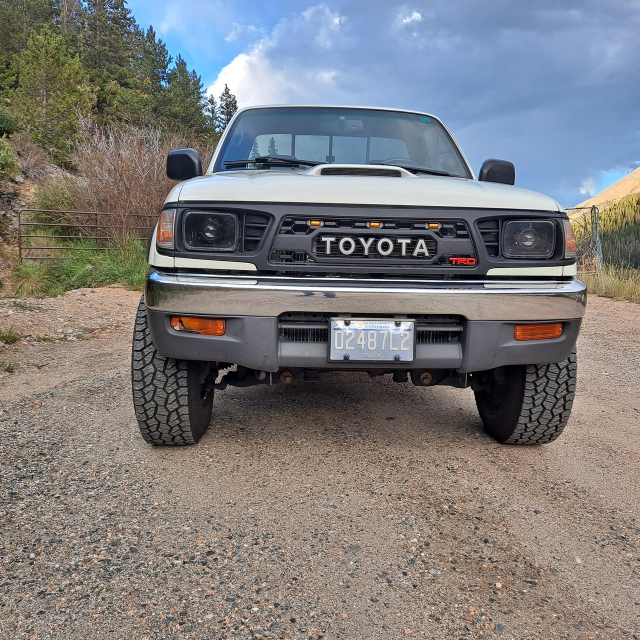

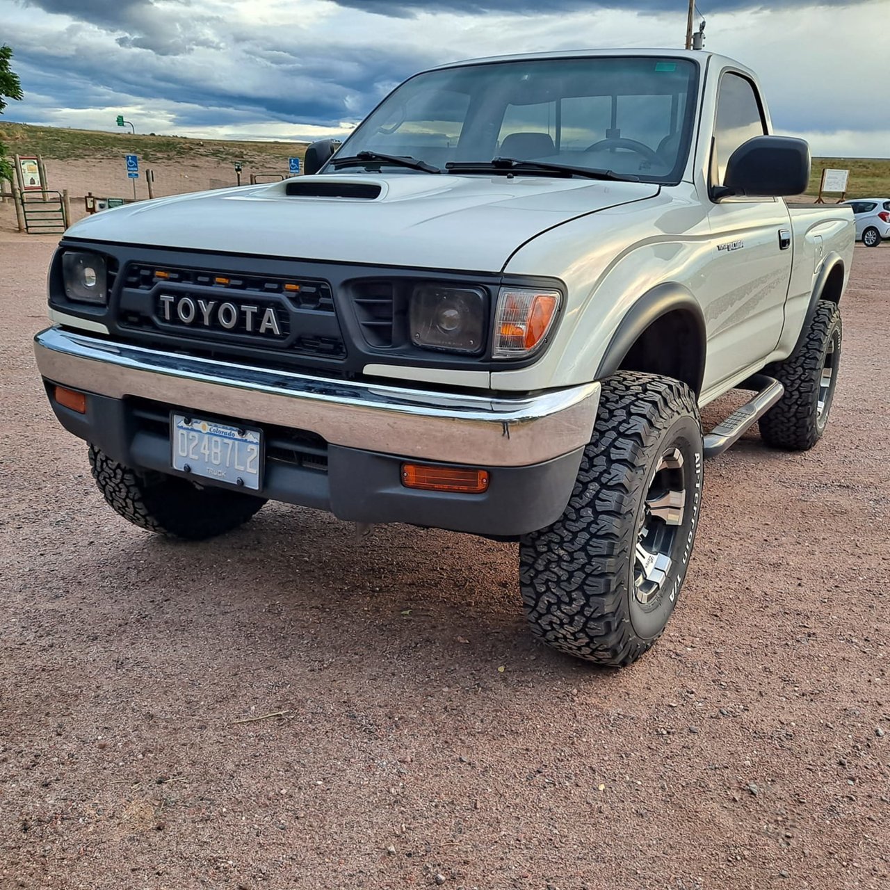

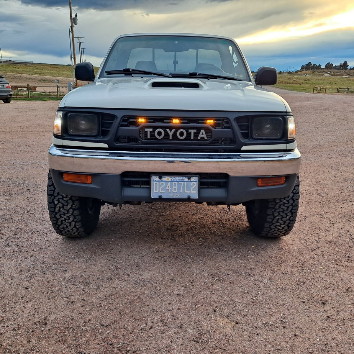

    Got it installed and got a separate OEM fog light switch with led power light indicator for the lights,
    Fits like a glove,
    But didn’t come with the grille clips so got new ones from dealership

    I love it! That looks really good!

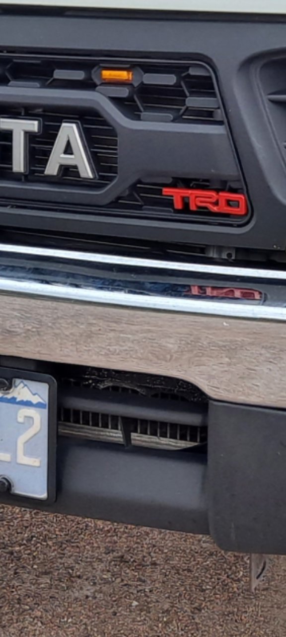

    Added a TRD badge today,
