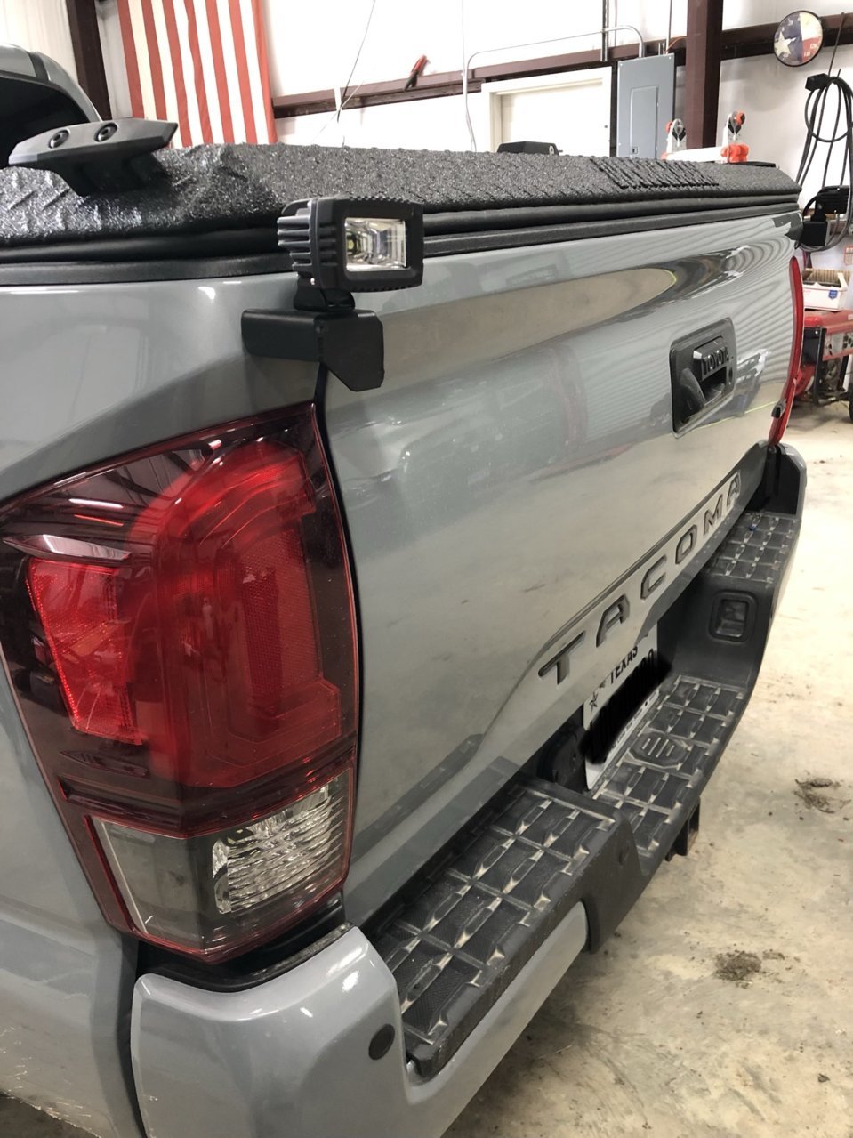

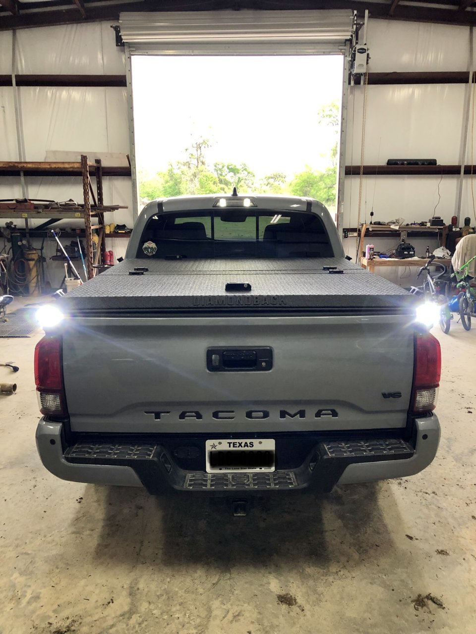

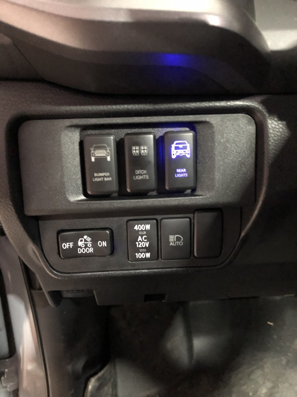

    I just wired these yesterday, on/off switch.
    Surfinjoe, Pwhis, AxisCab and 3 others like this.

    did you use the link above for reference? can you post pictures of how you ran the wires and where you tapped into? Thanks!!
  12. Apr 2, 2019 at 12:11 PM
    savin yours
    savin yours Well-Known Member
    Sep 18, 2018
    #266644
    831
    Bryan
    SE Tx
    2018 TRD Off Road
    Didn’t use the link, I just used a wiring harness with the lights. I’ll try and get some pics, but it’s as easy as can be. I ran most of the wire along the frame, with the factory wiring harness.

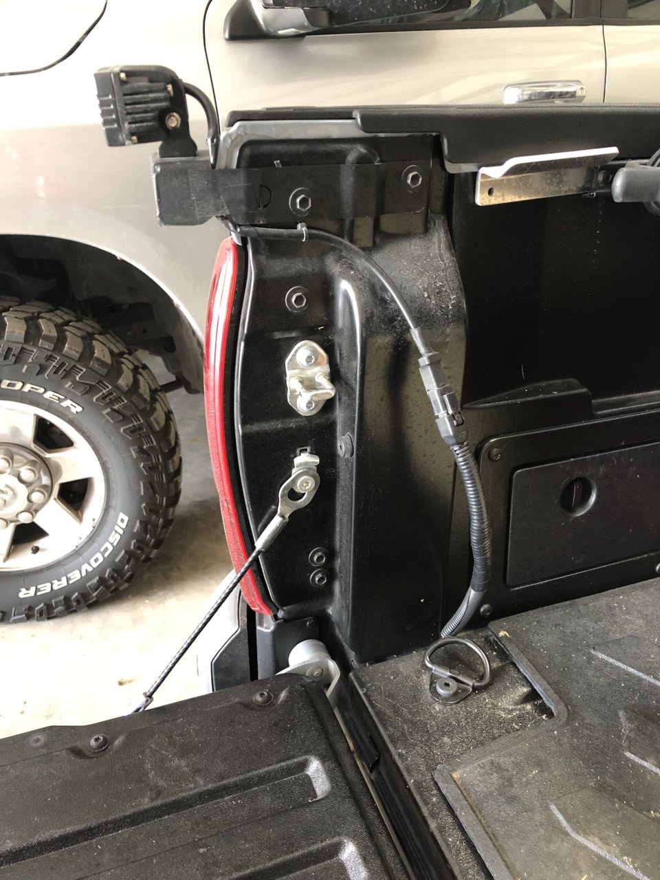

    This is how I have my lights so far but I haven’t wired them in yet. How did you wire the pods from the outside to inside the cab?

    But how are you running your wires? Just on the sides of the truck bed? Or underneath or how?
  16. May 21, 2019 at 4:40 PM
    #16
    savin yours
    Sep 18, 2018
    #266644
    831
    Bryan
    SE Tx
    2018 TRD Off Road
    Sorry. I went under the bed and along the frame rails. There is a factory harness that runs most of the way, I followed it. Under the engine bay the into the grommet that comes out by the break pedal.

    Were you able to use the one harness for both lights? or did you need to splice into it with more wire? I'm surprised there was enough length to get to the cab.
  19. May 27, 2019 at 12:34 PM
    #19
    savin yours
    Sep 18, 2018
    #266644
    831
    Bryan
    SE Tx
    2018 TRD Off Road
    I spliced them together, I also added wire in the middle of the harness.
