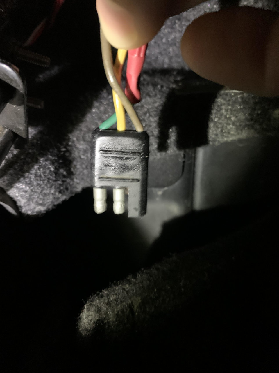

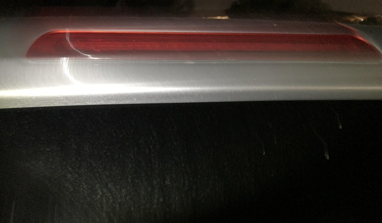

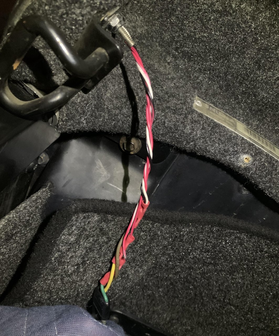

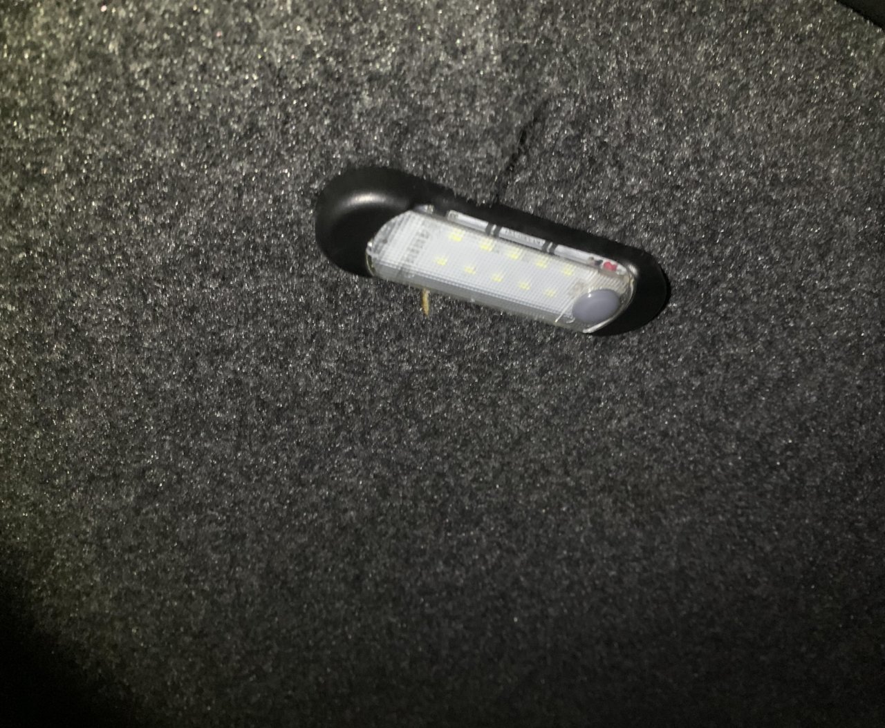

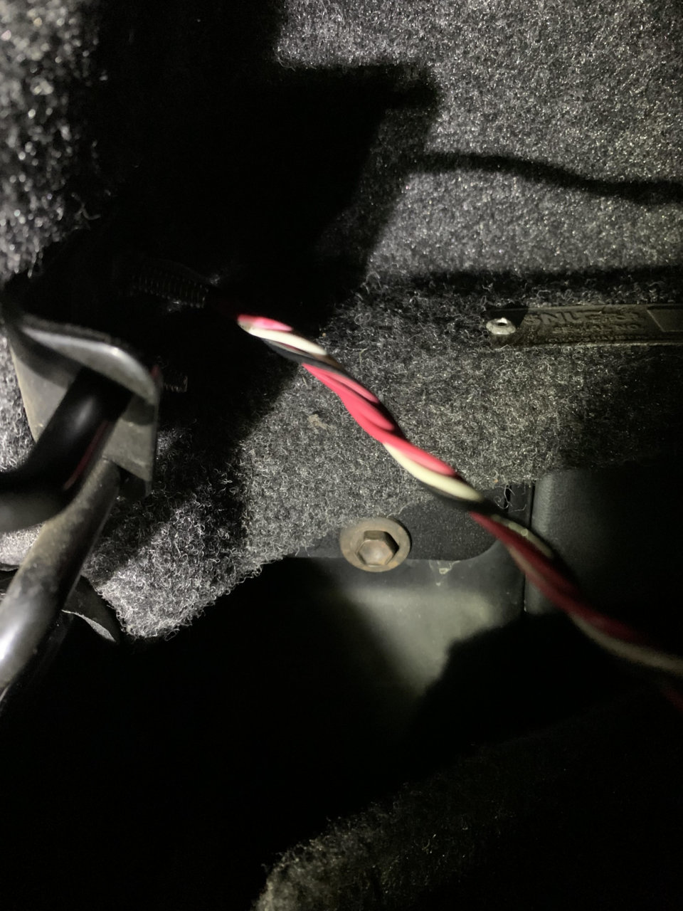

    shell brake.jpg camper shell overhead light.jpg wiring.jpg more wiring.jpg shell plug.jpg
    To remove the shell, we simply unplugged from the guy's truck. He had a hole drilled into the plastic side of the bed; behind which I didn't get a chance to see exactly how his wiring is set up.
    What I don't get, is why whoever wired it, spliced 4 wires into 3.
    I'm assuming they are two pairs of pos/neg, Pair 1 coming from Dome, Pair 2 coming from Third Brake.
    Which means previous installed made two wires combine to one, to use something in common. No idea what that would be.
    IF positive tail source acts as a signal wire to illuminate third brake,
    then probably, the "both" splice is not Positive.
    It has to be either ground, or negative.
    If it is sharing ground/negative, then maybe an eyelet bolted into the chassis isn't necessary
    Maybe I can undo all this shit, peel back the headliner that looks glued on, or unbolt the two lights to see what color wires go to them, to "trace" and know what they are, where they're coming, what they power.
    I *did* buy for a few bucks, a 3-way connector pigtail to plug right into this.
    But, I can always cut the crap all off, start over, and order to install a 4-way that separates into two paths. One twin wires for the dome, one twin pair for the brake.
    Has anyone dealt with this? Getting a shell used that comes with a 3-way?
    I'm used to YouTube tutorials showing 4-way.

    The stoplight switch at the pedal has constant power. There's no constant power at the back that I'm aware of. Maybe if you dug into the trailer package wiring at the tailgate.
    I ran a fused wire from the battery back to the left rear corner for the dome light.

    Oh. So that probably means if only the stoplight switch has power, that the tail only gets power to illuminate when the pedal is depressed.
    AKA Dome wired to that, would only come on if someone is pressing down the brake to activate the circuit
    which would make no sense to wire that way
    Or, if potentially previous installer had it set up where dome only can come on with key in ignition ON position, which would also be dumb
    Sounds like I may need to order a 4-way loop
    undo the shenanigans on the shell and start from scratch
    and to separate the two pathways
    1. Pair One wires, trace/confirm colors from third brake, tap them into tail using adapter
    2. Pair Two wires, trace/confirm colors from dome, run power/post to battery (fused) and either tap them into negative on the tail (which technically the old 3-way may be setup/intended to do) or simply find a ground stud behind the tail to put it on with an eyelet and add a nut to retain it

    For the dome ground I just used a sheet metal screw and eyelet behind the taillight
