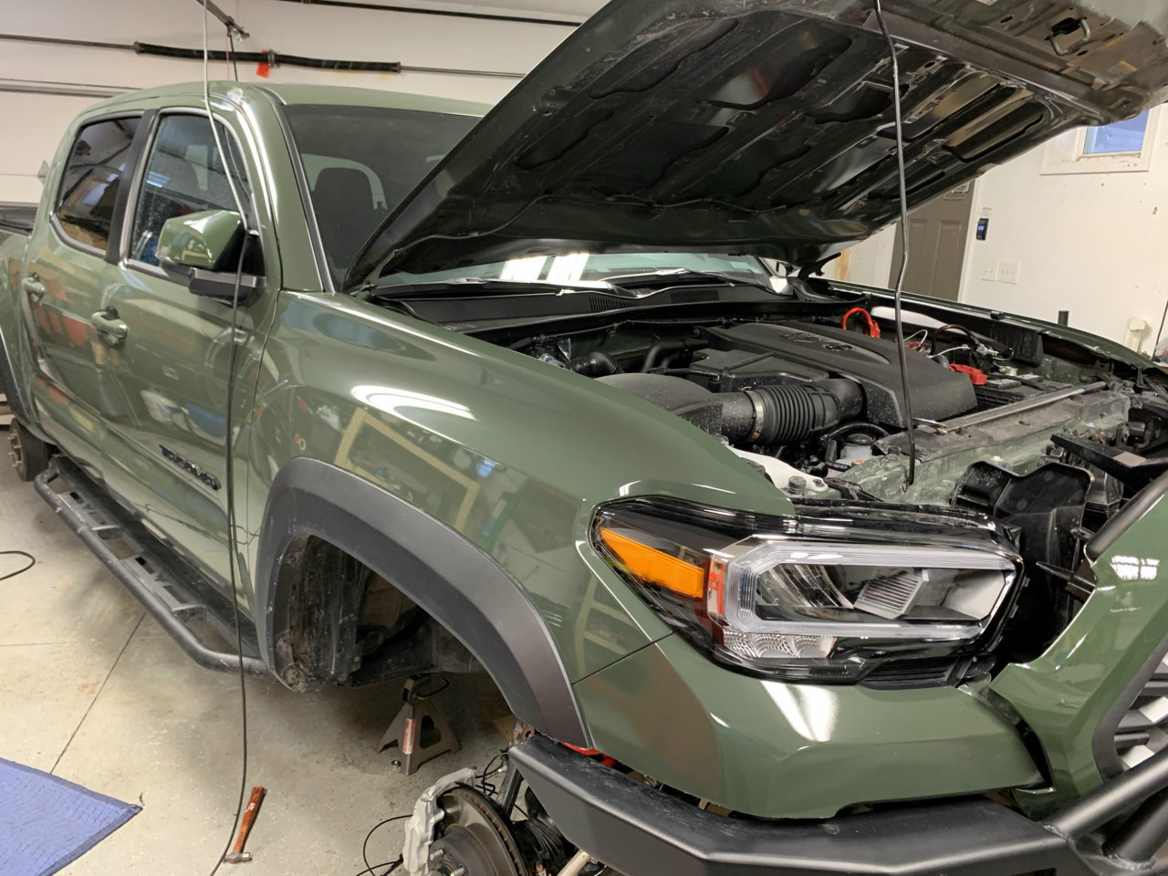

    2020 Army Green TRD PRO - 2023 Genesis GV70
    Stock FOX 275/65/18 At3w 18X9 Fuel Vapor's
    Don't forget the jewel cup!
