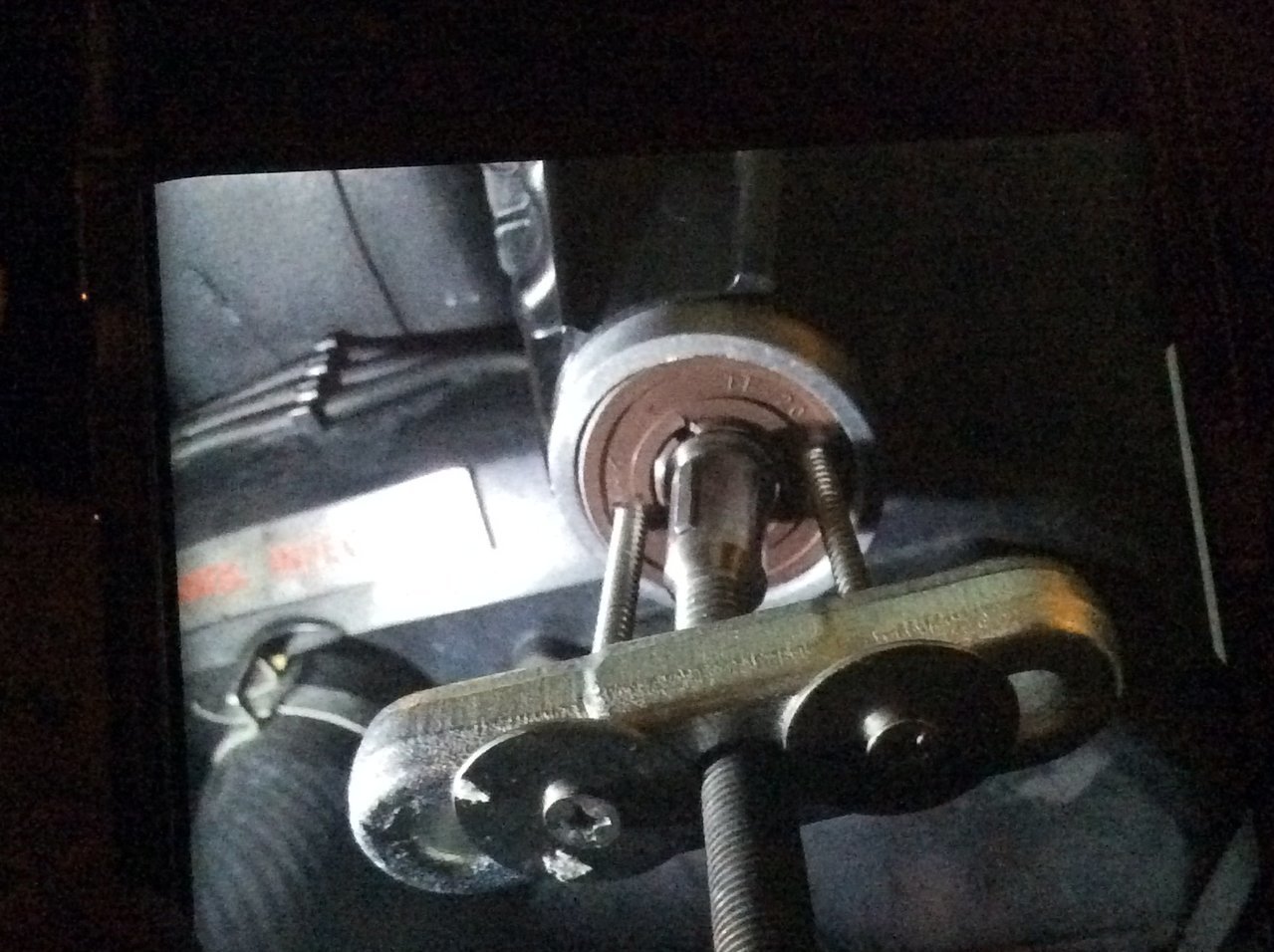

    Anyone know the easy way to remove the nose seal on the trd supercharger while it's still
    in the truck without hurting the shaft or housing. I have seen some people struggle getting
    it off. Any secret? Mine is leaking and I don't want to take the supercharger off or the nose off. I have heard the nose seal get stuck in there pretty tight.
    I have a butt plug in the top so I can suck the supercharger oil out and refill it.
    The bottom photo is of a member trying to remove his old seal.
    Thanks in advance

    Well I figured it out, bought a cheap 10.00 puller, then bought two long screws for sheet metal and 2 washers
    Drilled two small holes in the seal and used the puller to get the seal out, took 5 minted to do, easy easy
    And no harm to the snout housing seal rim area or the shaft

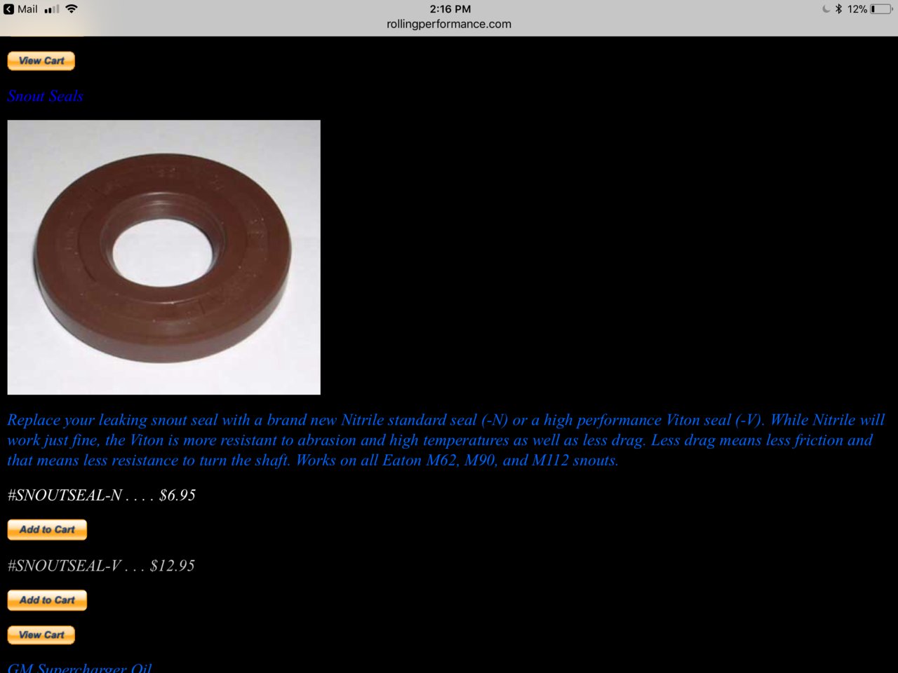

    Yup I bought 3 just in case, still on the 1st one
    The HIGH TEMP seal I bought is for the grey 1st gen, you can call them to see what you need
    the Viton high temp seal for the front of snout.
    http://www.rollingperformance.com/scoil.htm
    #SNOUTSEAL-V . . . $12.95

    Remember when you take the seal out you probably will have oil leaking out the front, so you will probably have to drain the oil and put new oil in also FYI
    They make some special grease for the new seal when it gets installed so as not to burn the start up
    from friction between the seal and shaft if I remember. Might want to google that.

    When you drill the holes in the seal to remove it just dill a super small hole that just starts to go through.
    If you drill all the way shaving will get on the other side and the bearing are right there on the other side
    of the seal so go really slowly when doing this part and the removal screws need just a small turn to grap the seal as it’s made of steel with a rubber coating To pull off with the puller.

    When you install the seal make sure you have a LARGE socket the size of the seal that you use as a pressure block against the seal when you pressure fit it so it goes on evenly and that the socket center is larger than the input shaft so it can slid over the snout shaft. good luck

    1) get 3 seals high temp from rolling performance just in case one gets messed up or doesn’t seat
    correctly.
    2) a small puller as shown
    3) some sheet metal screws as shown
    4) washers for the screws
    5) take the new seal to parts store to find the correct size socket to use as your pressure block for the
    pressure fit of the seal
    6) get a new GATE supercharger belt
    7) new oil for supercharger
    8) if you have a URD pulley inspect it for wear, they are made of aluminum and wear out and the belt will slip and ride on the ears. If the URD pulley is worn you will see the red paint gone from were the belt rides on the pulley.
    You might also see burn belt marks on the inside of the pulley
    All done

    The high temp Viton seal is rated at -40 to 400* F and 20,554 rpm

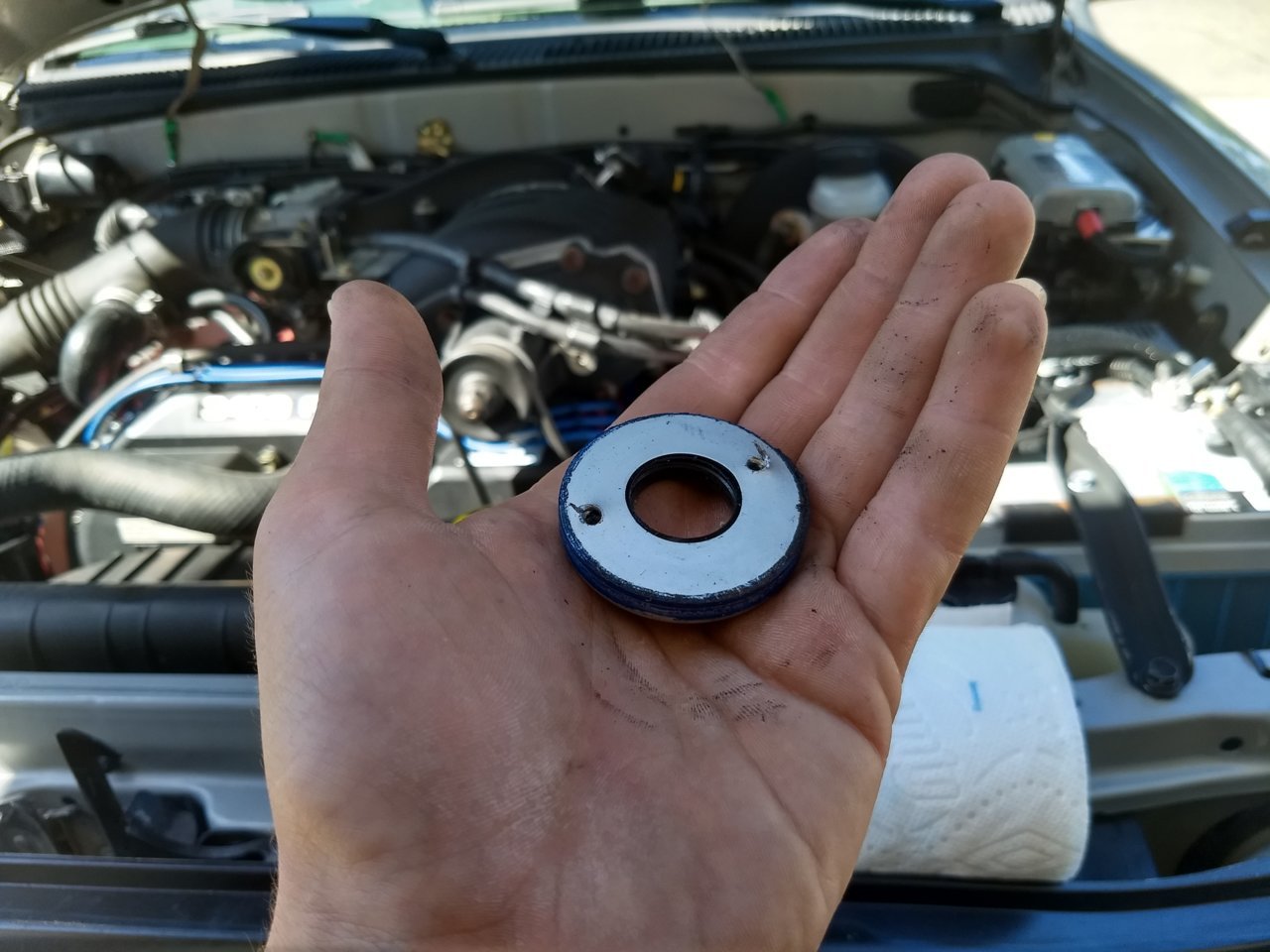

    Just finished. Used your screw/washer/pulley trick. Worked great. Used a 1/16" drill bit to predrill and there's a little less than a 5/32" space from the outside of the seal to the bearing surface
    Front was elevated on an eight inch inclined driveway. Didn't lose a drop of oil. When I dig up a 4.5mm hex I'll check oil level. I didn't have a full-on leak, just a small amount of dirty film under the snout. I'm at SL so I put back on the stock pulley and figured to replace the seal.
    Inner seal lip didn't seat upon assembly, but turning the nose shaft seated it. I'll keep an eye on it. It may have ruined it. But ill put back my 2.1" pulley when im back @ 5500' so I'll obviously see a leak then. Used Mobil 1 syn red race grease on the lip surface.
