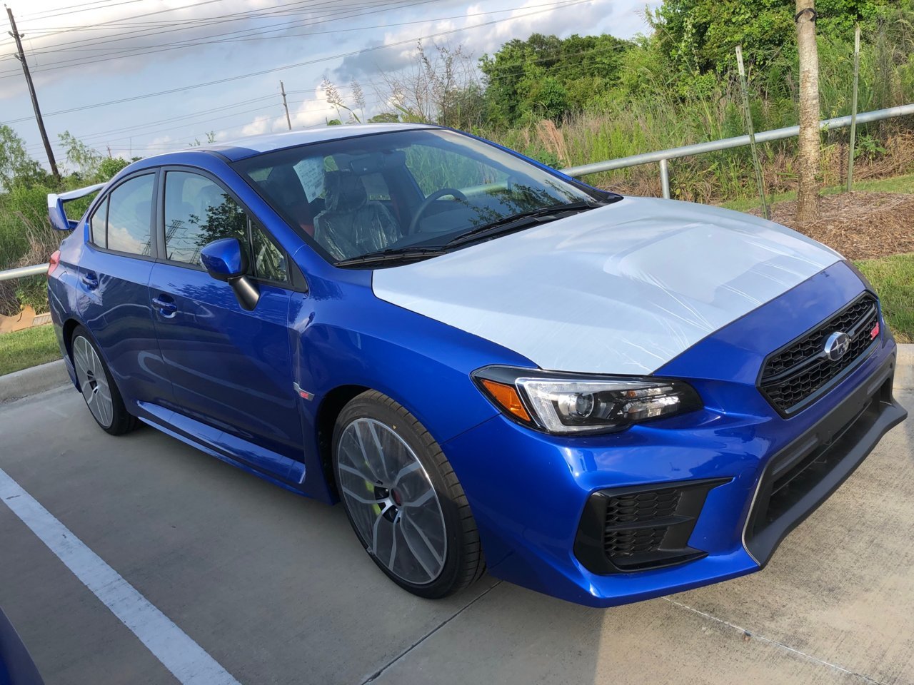

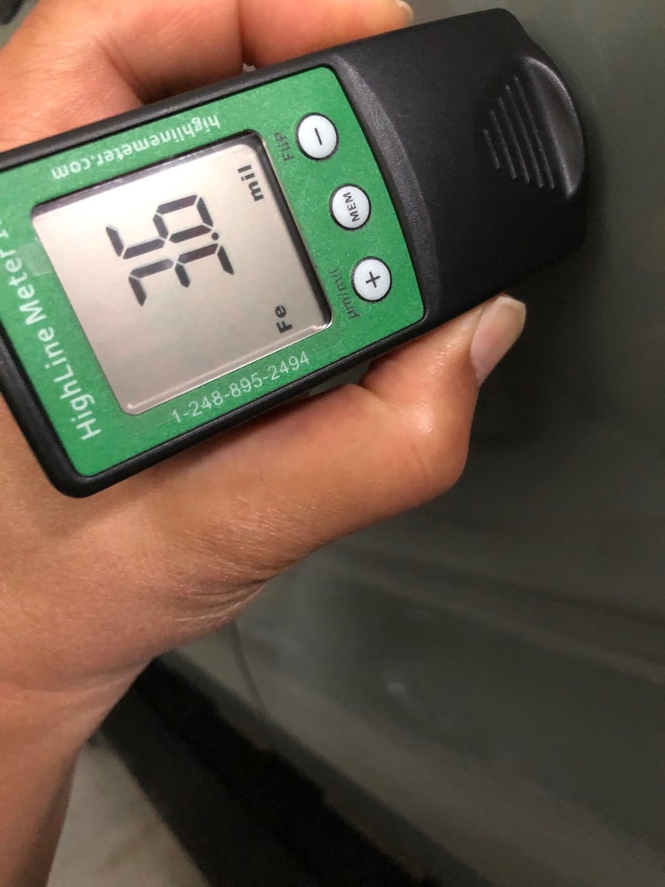

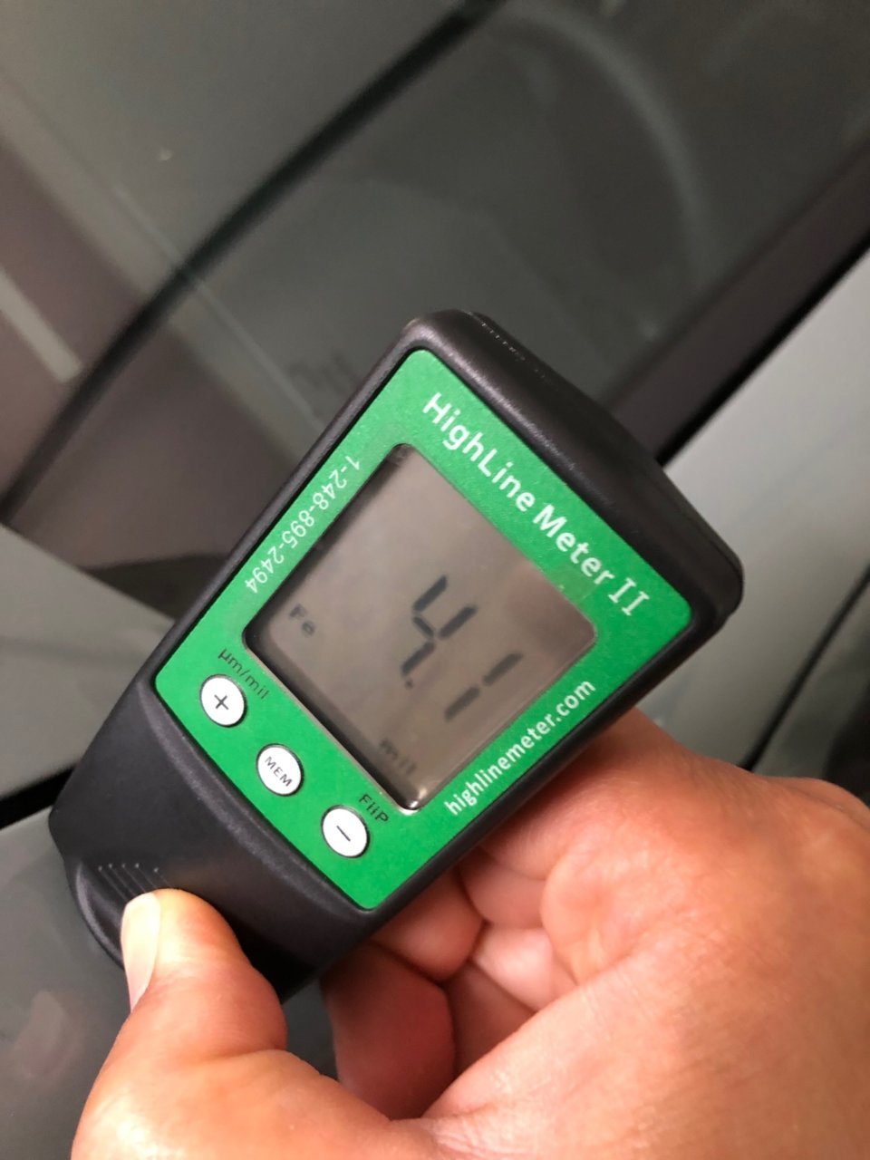

    A few things:
    1. If you hate swirls, have the paint corrected and PPF then ceramic coat it. The entire front of my LR has PPF and entire truck has ceramic.
    2. If you don't want to spend that much, have the paint corrected and entire truck ceramic coated.
    And if you want to be 100% sure a dealership "detailer" doesn't rek your paint, tell them not to wash your car.
    Or better yet, some enthusiast friendly dealers will let you take the car like I did with my STI.
    One last thing, if you are going to have a detailer fix it, ask if he has a paint meter, if not, find a different guy. Taco paint is extremely thin and I did not have the dealer "detail" the car. a good detailer will meter the paint before he starts work and carefully meter it again, especially on paint so thin.

    Sorry, 100% disagree with saying someone needs a paint thickness gauge. I have been doing this for 15+years and if you are doing a simple polish on a brand new car there is 100% NO need for it. If you are going nuts and doing like a heavy cut correction to try and make it perfect and not knowing the history and not new then I can see the need for a thickness gauge. But saying you need someone who has one for a light polish to remove some light swirls is not needed and most of the time I feel it makes people act like they are a better detailer because they have a gauge. When in reality its not needed at all and just added fluff

    Sorry, I have put meters on 100's of cars, and based on the readings I have seen from cars being "detailed," I would rather trust someone with one than without.
    We are talking what? 500 bucks for a really good elcometer and 200 bucks or a budget meter?
    I can't tell you how many panels for example that I have seen with paint in the low 3's from "detailers" that "I got your paint smooth like butta."
    And Taco OEM is already in the 3's from the factory, there is not a whole lot of clearcoat to be taken off.

    So you put meters on a bunch of cars. So what does that mean? A light polish to remove some very light marring is NOT going to cause any issues even with some thinner factory paint. This is a useful tool for serious corrections but it is also a tool to try and act like they can charge someone more because they have a paint gauge that isnt needed. It's a tool ONLY needed for certain scenarios.

    It means most "detailers" shouldn't even detail a matchbox car.
    In my previous life I was in the bodyshop business. And I would tell you that most painters also shouldn't paint a matchbox car let along a real car.
    In the case of Taco's, a truck with paint already in the 3's from the factory, there isn't a lot of room to begin with to take some clearcoat off to get rid of the swirl.
    DetailerS I have used always take before readings before they begin work, not really sure why that's such a bad thing. It sets the expectation and covers everyone.
