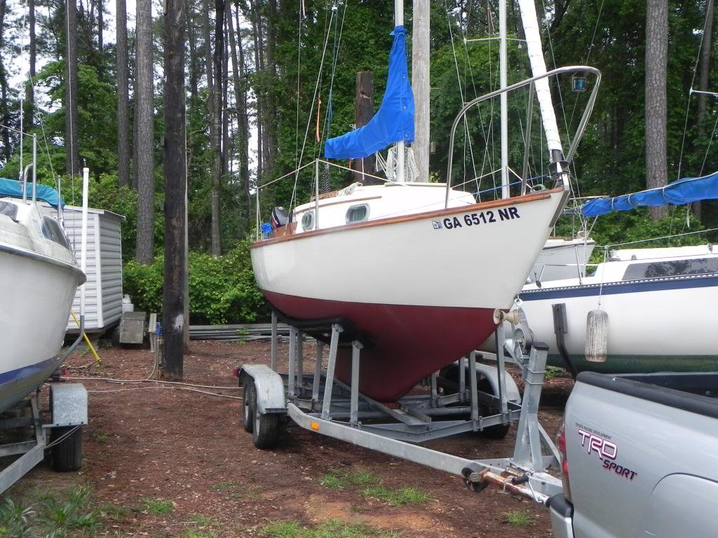

    I tow a 22' sailboat, weighs 3200 lbs. Trailer is another 1200 lbs. Was towing with a 2010 Access Cab Sport m6. Just traded it for a 2015 access sport m6.
    Last May I towed the boat from here in middle Georgia to the Fla Keys and back, about 700 miles one way. No problems, but as Bubba bud says, towing capability is more about stopping ability. My trailer has hydraulic surge brakes which are marginally OK. Electric brakes would be better. Obviously gas mileage sucks towing that much weight - 10 mpg.

    DSCN1074_zps746bbb25_405d9544285f3161c633339934053086cf0c2599.jpg DSCN1074_zps746bbb25_405d9544285f3161c633339934053086cf0c2599.jpg

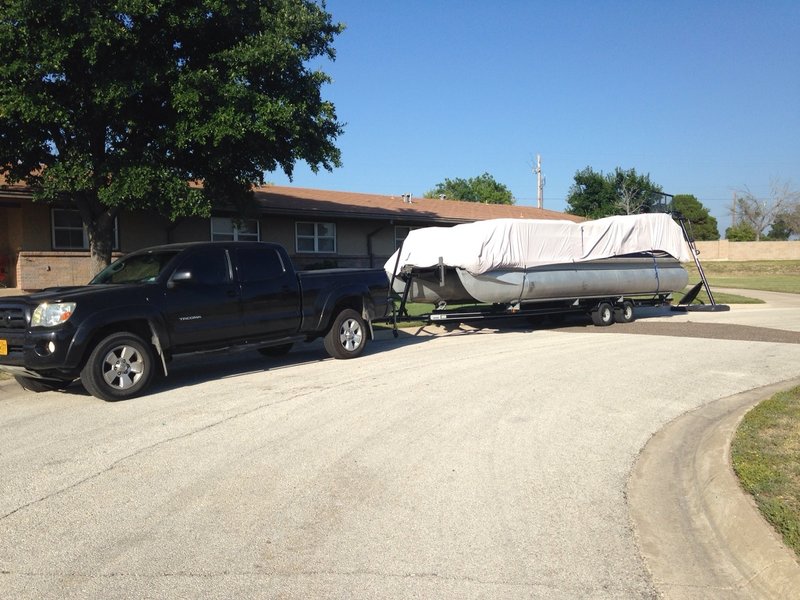

    Here's what I tow. I can cruise at about 60. It really depends on the hills though. It works fine.
