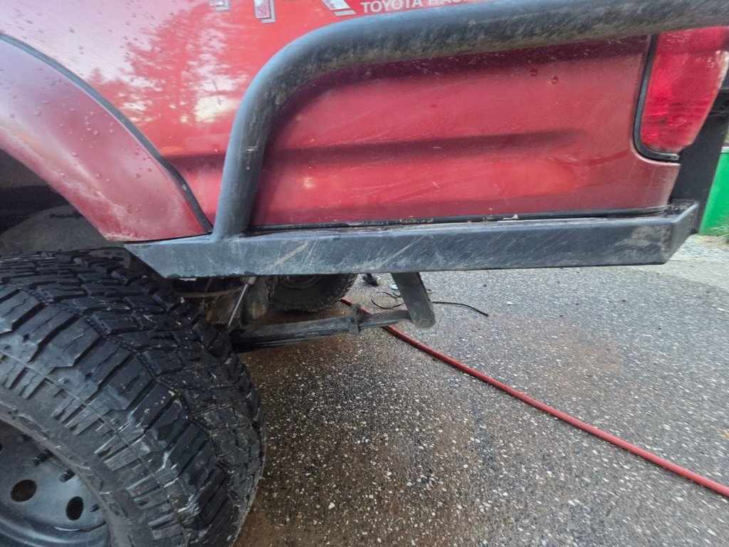

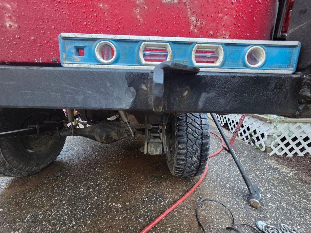

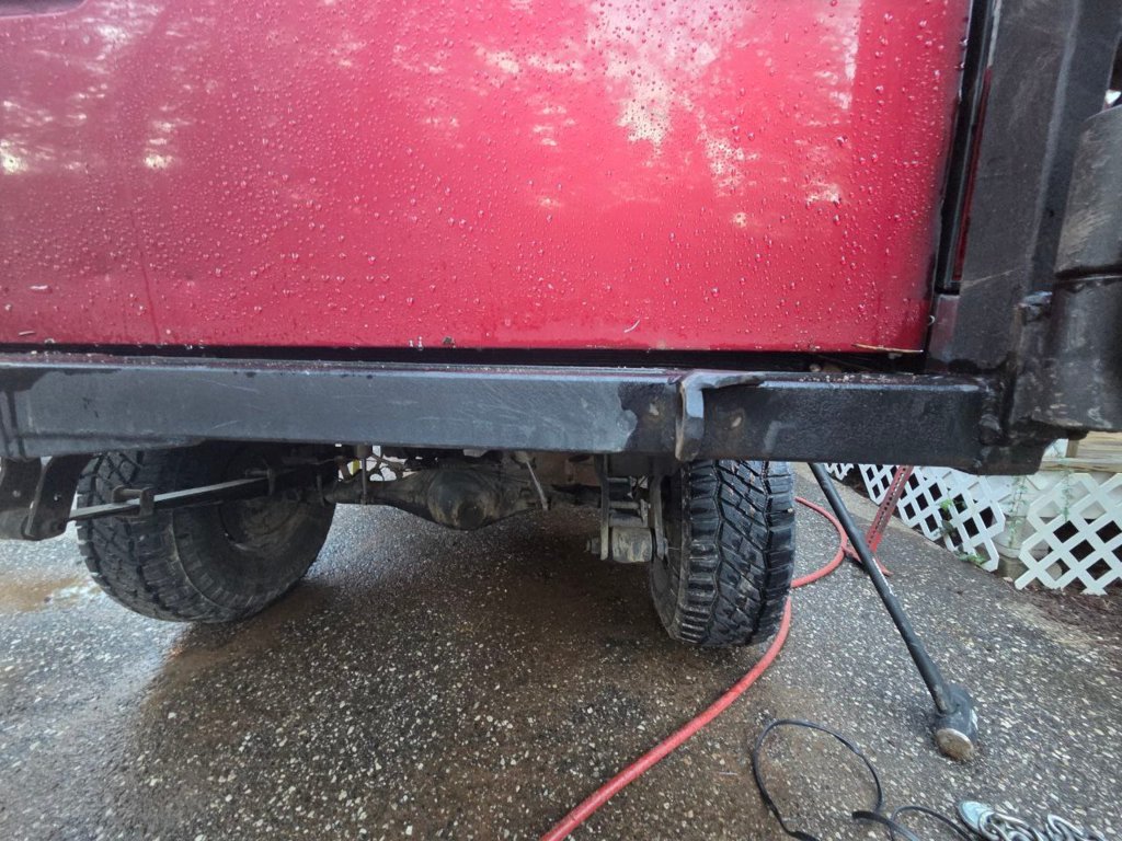

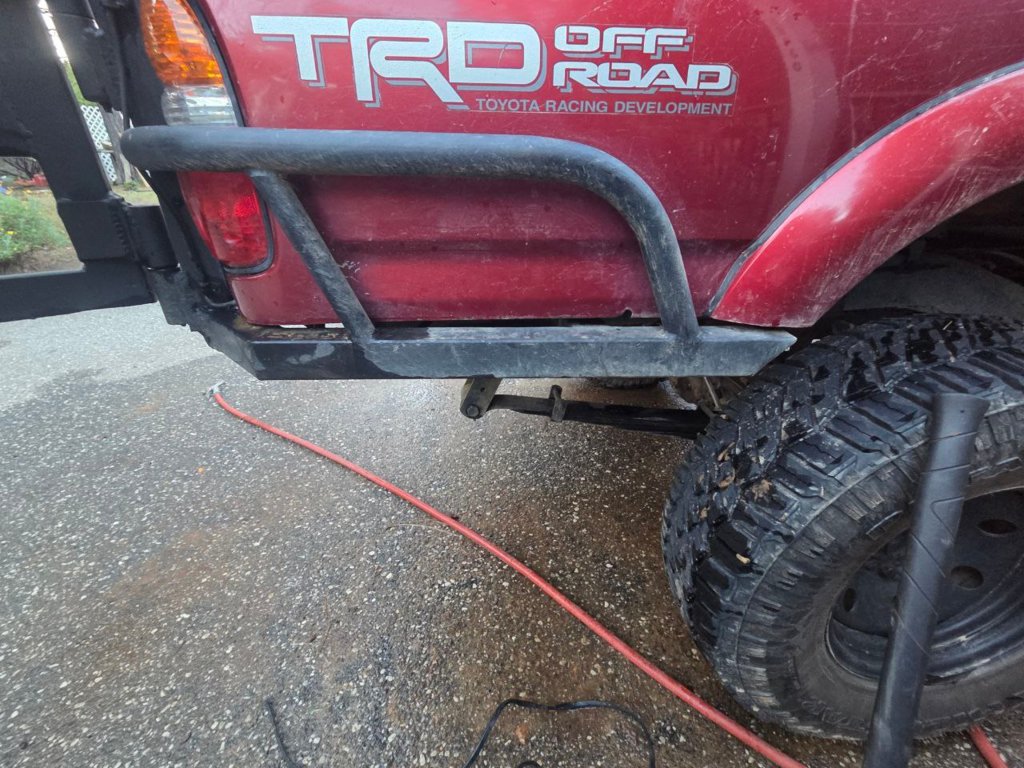

    Learned my lesson with using non elastic tow straps, bent the bumper even more downwards. It was never perfect before but I say it moved a decent bit.
    How would you bend this upwards?

    Loosen the bolts and lift up with a jack, then tighten the bolts back down?

    Personally, I’d just leave it. Doesn’t look bad and hey… road warrior damage - right? :cool:

    Welded onto the frame :)

    My ARB had sustained an impact from a stump which gave it a little dent. Not really a big deal but the alignment on an edge (interior side close to where it mounts to the frame) was a bit off. I took a mini sledge and gave it a couple of solid whacks and it was good to go. Not saying that will work for you but maybe experiment a little. :notsure:

    I've tried using a full size sledgehammer to it with ratchet straps holding the bed onto the bumper and nothing would budge. My next step is wrapping a chain around the bumper and using a hi lift. Thoughts on that?
    I need a way to like use a jack directly onto the bumper while having enough force to make the truck not rise with the jack.

    The problem is going to be that the steel will spring back... you will have to over bend it to get it to spring back to where you want it. Off the top of my head I am thinking loosen the bed bolts and get the bed up 5 or 6 inches in the back, wrap a chain underneath a large tonnage floor jack and put a 4X4 or some 1/4 wall rectangular tube on the lifting pad and start jacking and see if you can move it. The scary, really really scary thing is that if the lifting bar/post slips out it will be a missle so some sort of containment will be necessary.
