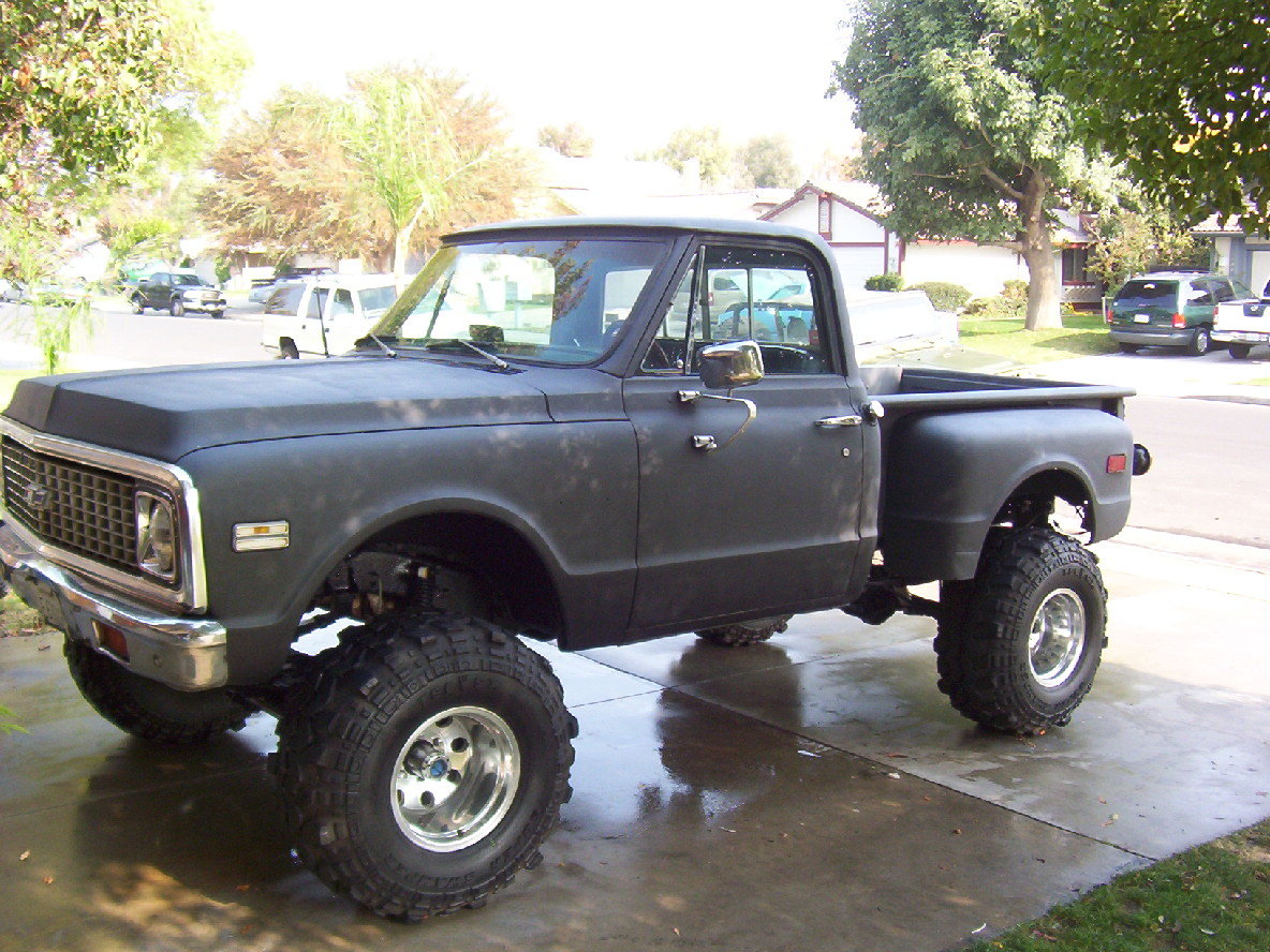

    Done it for years, it's an off roader. Bondo rock rash, rattle can it, makes for a good time the next time you brush up against the rocks and bondo shatters and flys everywhere. Then do it all again.

    Lots of bondo on this beater. 350 small block on Nitrous Oxide. E-ticket ride, bondo, then lots of primer. Do it all over again.

    Look closely at the bottom of the door and rear fender. Fixed it. Winning.
