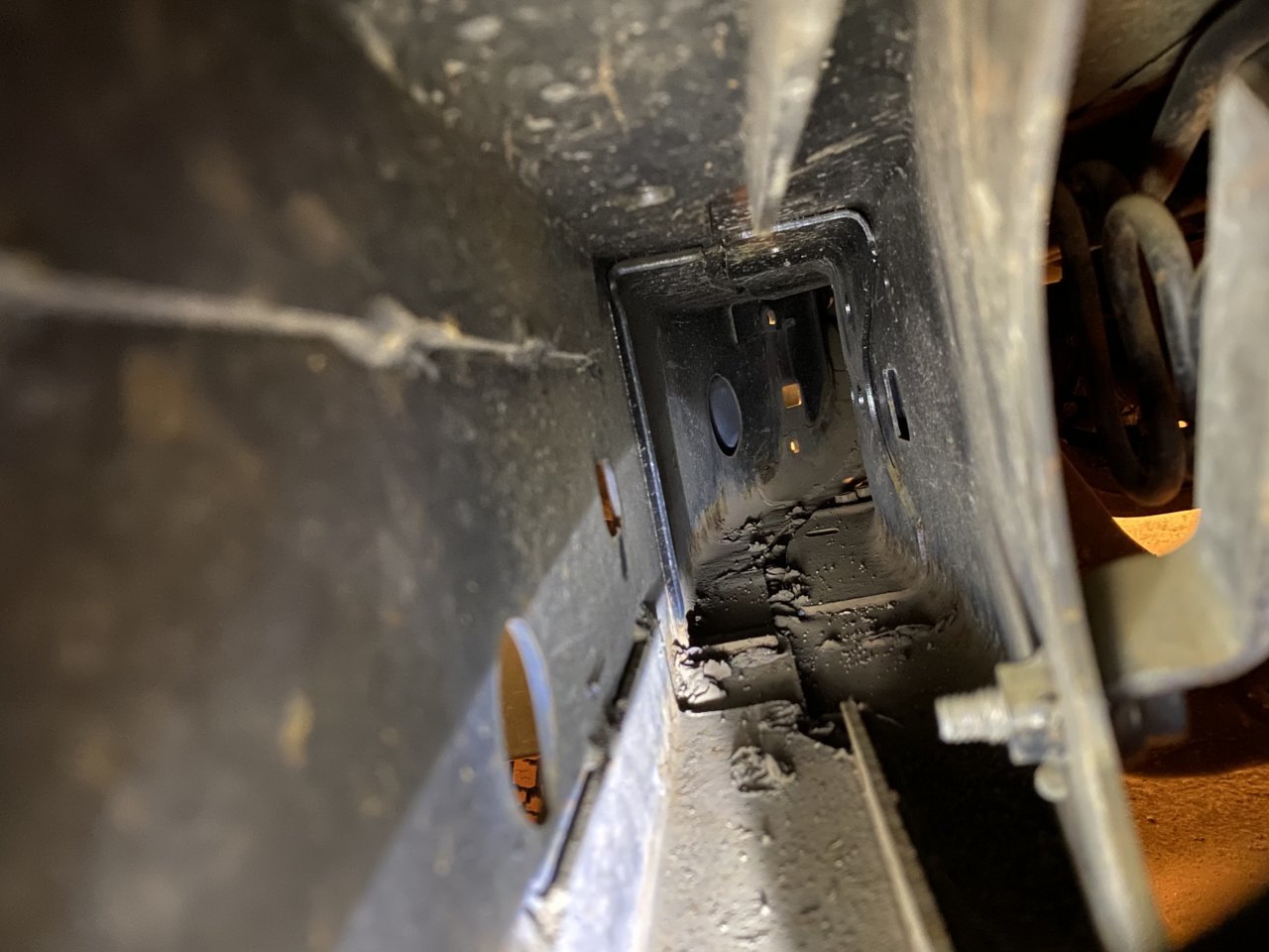

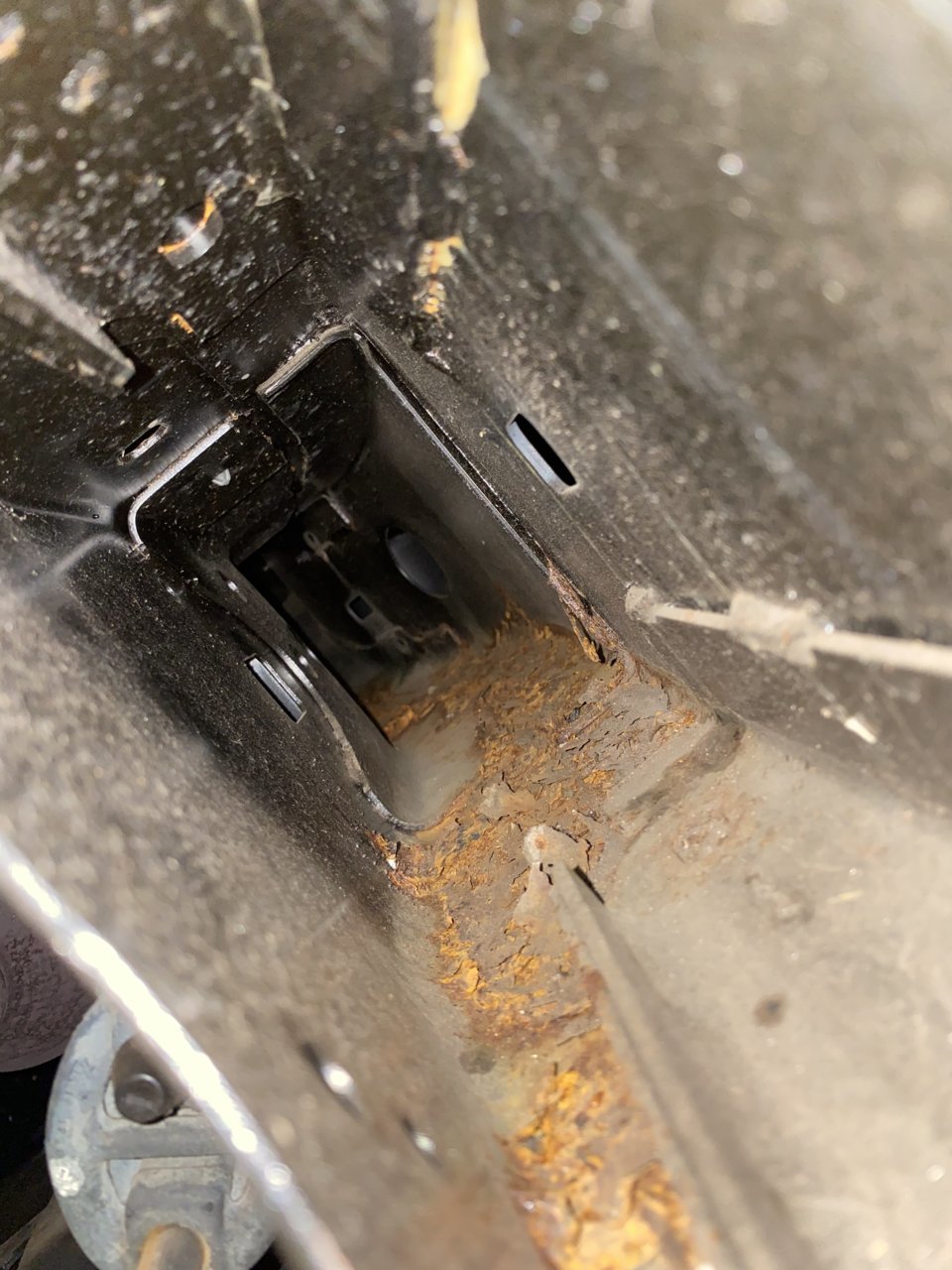

    Just got done greasing my u joints and was shocked to find my frame rusting from the inside, near the front part of the frame where it becomes fully-boxed.
    I know rust issues are common on our trucks, but I always obsessively took great care of this truck. It’s never been driven/parked near salt water and I washed and waxed it weekly when it was my daily.
    How would you repair this? I’m not sure how one would properly remove the rust since it’s such a tight fit in there. The passenger side is much worse than the driver’s side, I’m assuming due to the AC drain (I should have relocated the drain.) However I address this, I want to make sure it’s a good-quality repair that lasts for the long-term, as I plan to keep this truck for many, many more years.
    Truck info for those curious:
    2010 Access Cab TRD Off-Road
    Original owner
    22k miles
    No aftermarket undercoatings
    The rest of the truck is pristine. No other rust on other parts of frame or on body.
    Photos of the rust. Passenger side frame rail (looking toward the front of the truck where it goes from c channel to fully-boxed)

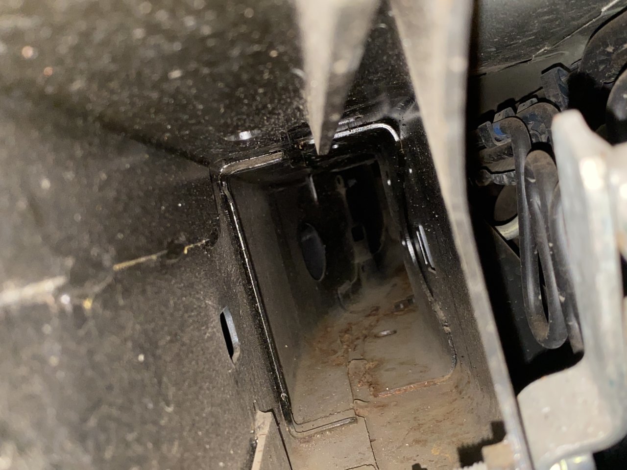

    Driver’s side:

    Damn . Need to check mine now . Like whatstcp said scape as much as can and also try to chip off all rust scales you can( long pry bar etc.) . Rust will keep forming under the rust scales . Worked by ocean by airport (Honolulu ) and man amazing how much rust can develop under rust scales . That eastwood internal frame coating looks like good stuff . Only problem is shipping to the islands .

    I'd get some Fluid Film and hose it up in there. I spray mine a couple times a year and sometimes follow up with some Liquid Wrench rust inhibitor or something with a little lower viscosity.
    I think it's important to do it while it's still warm outside so the fluid/spray can wick into the sandwiched areas of the frame.
    Before I knew this was 'a thing' I used to do this with WD-40. It's not much but I did this pretty regularly on my old T-100 and it's still rolling around Des Moines with my nephew today and has well over 300,000 miles on it.
    I even spray up into my rockers, cab corners and door weep holes. I also hose down my rear leafs and some suspension components from time to time. For that, I use the Liquid Wrench or something a little thinner than FF.

    Think I’ll give Eastwood’s a try. Sounds like the perfect solution to get deep into the nooks and crannies of the inner frame.

    i am currently treating my old taco to that product, the green stuff
    it will dry near instantly on the crusty when it touches, it has very low viscosity to creep into crevices better, so it WILL run like a river on any 'normal' painted surfaces
    this is also a magnet tool i found helpful to dig out loose coating and crusty specs
    https://www.amazon.com/gp/product/B000H5QRV4/ref=ppx_yo_dt_b_search_asin_title?ie=UTF8&psc=1
    its also very strong, will lift a full jar of cinnamon right off the table several inches
    so far it has not snapped on me with the bends and twists it has been subjected to

    Wow, appreciate the great info! Can’t beat real-world field testing. Looks like the Eastwood internal frame coating and fluid film may be my best bet.

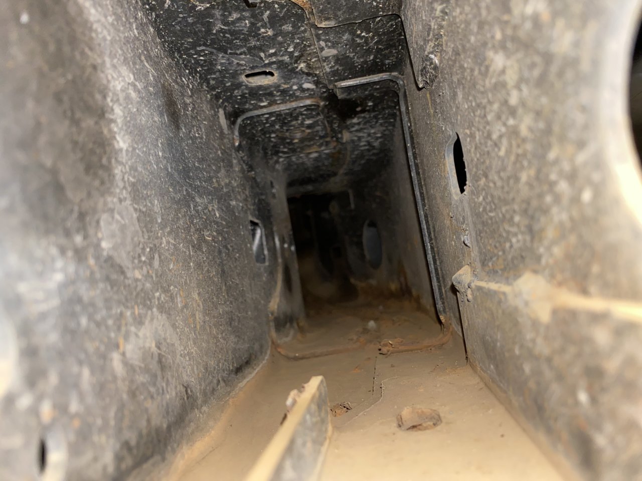

    Had some time after work today, so out of curiosity I checked under my other 2nd gen, a 2008 regular cab. I was surprised that it wasn’t as nearly bad as the 2010. I regularly use the 08 off-road and it’s frequently been driven to the beach and near salty air.
    739E008C-2202-4F76-A2D3-81415C267D43.jpg 06B4596B-19FA-43B8-B64A-AC736037A2D5.jpg
    I also checked under my father’s 2007 DCLB and it had quite a bit of rust. For the 07 however, the bulk of the rust was on the outside of the frame, near the front cab mount. Also saw some on the inside of the c channel section of the frame under the doors. The 07 is a farm truck and pretty much only used on hard dirt roads and the highway. I should have taken photos, but unfortunately did not.
    For anyone reading this, check your frame! It’ll only take a minute and you could save yourself from a potential headache down the road.

    you sprayed the CorrosionX HD inside an internal frame cavity?
  18. Sep 22, 2020 at 5:12 AM
    #18
    JdevTac
    JdevTac Well-Known Member
    Jan 8, 2012
    #70234
    6,305
    Josh
    GA/WA
    2nd gen
    Yes
  19. Sep 22, 2020 at 5:13 AM
    #19
    GQ7227
    GQ7227 mw survivor
    Dec 6, 2018
    #275019
    29,298
    J A Y
    2 passes with the green, and am planning to final coat with the black IFC so that it might be easier to scope it out down the road a number of years and see how its still holding up and not peeling or anything weird
    the included wand did miss some spots. even on two passes. and I have to carefully use a straw to touch some of this up in corners
    but i don't know if your internal frame has these big support braces whatever pieces in the middle throughout the channel?

    that is very HardCore stuff! i sprayed some on the outside of my frame last winter to check it out, its the most resistant product to road washoff
    and the most difficult to remove, even with a 100psi abrasive media blast gun pelting away at it
