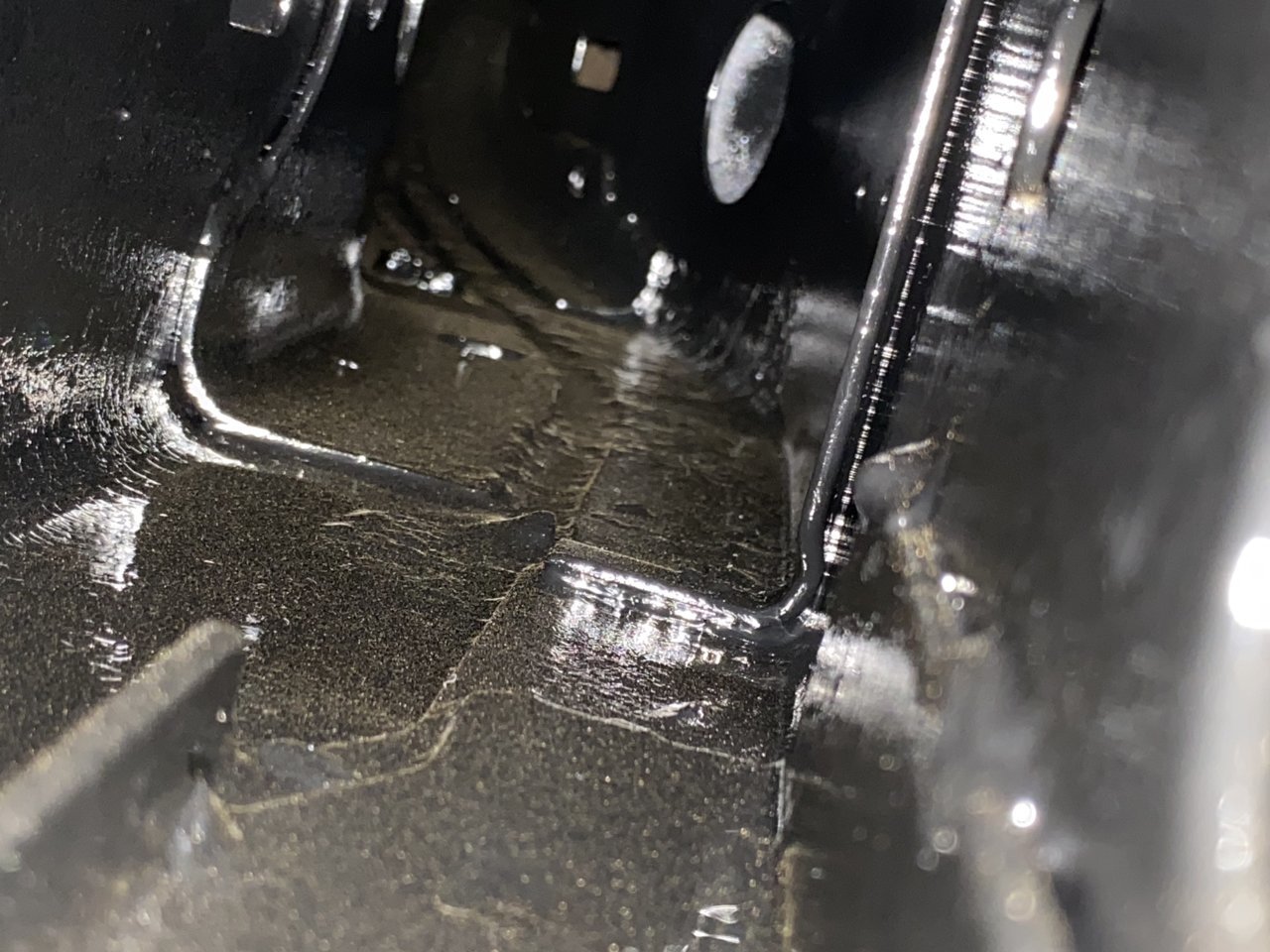

    In order for the product to work properly, it is necessary to first use a degreaser to thoroughly clean the work area, then use their metal prep product to etch the metal. In my case, I added a step before the degreaser. POR-15 offers a rust dissolver product that supposedly helps convert heavier rust. For all three of the above products, I first taped up the drain holes on the bottom of the frame, then used a garden sprayer to apply the product inside the frame. For good measure, I also poured the product into the frame and let it sit before thoroughly rinsing the frame out.

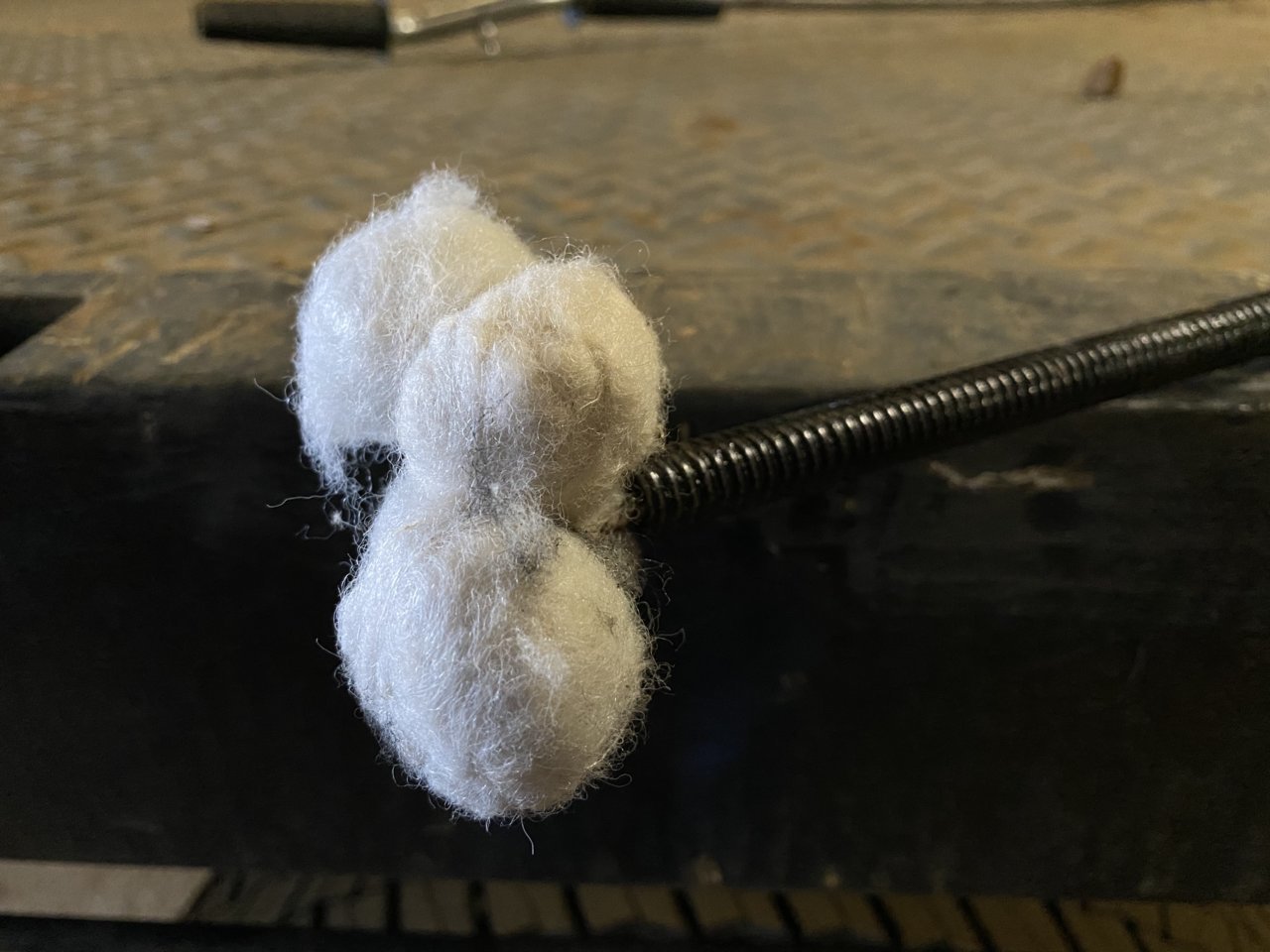

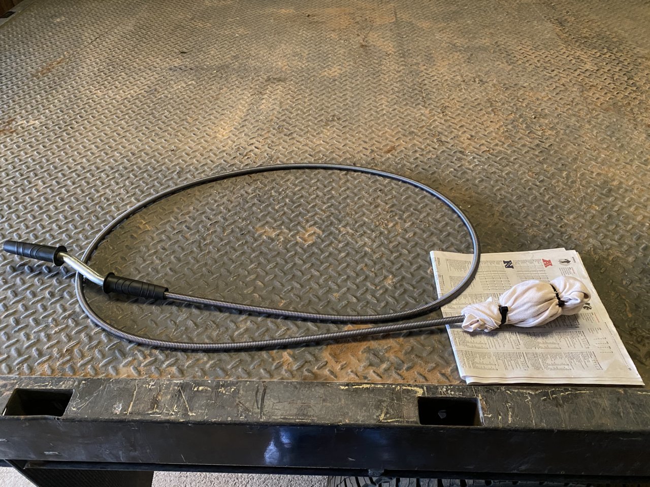

    The only problem now was deciding how to apply the POR-15 itself. I’ve never used air spray equipment for paint, so I didn’t feel comfortable going that route. POR-15 has “daubers” which are basically a length of flexible metal with wool attached on two ends. They allow you to paint hard to reach areas. To paint deep inside the frame, I ended up using the daubers attached to a length of flexible plumbing auger. I also wrapped a large clean rag onto the end of the auger to get any areas I may have missed with the daubers.
    Although it was probably not necessary for my application, I also used POR’s Top Coat product as well as Rust-Oleum’s High Performance Enamel spray paint as a final top coat and to cover any nooks and crannies I may have missed before. In all, I ended up applying 5 coats of POR-15, 2 coats of the Top Coat and 3 coats of the Rust-Oleum to the frame. It helped living in a humid environment, as the POR products were tacky and ready for another coat in about 30-45 minutes, so applying multiple coats was easy.
    I feel confident that this will stop the rust. Wish I would have checked my frame more regularly, then maybe I would have caught the problem earlier and all of this work could have been avoided.

    Wool daubers attached to the auger.
    A rag zip-tied to the auger that I dipped in POR-15 to apply the product.

    All better. Ignore the dust. The paint was thoroughly dried before it was exposed to dusty conditions.
