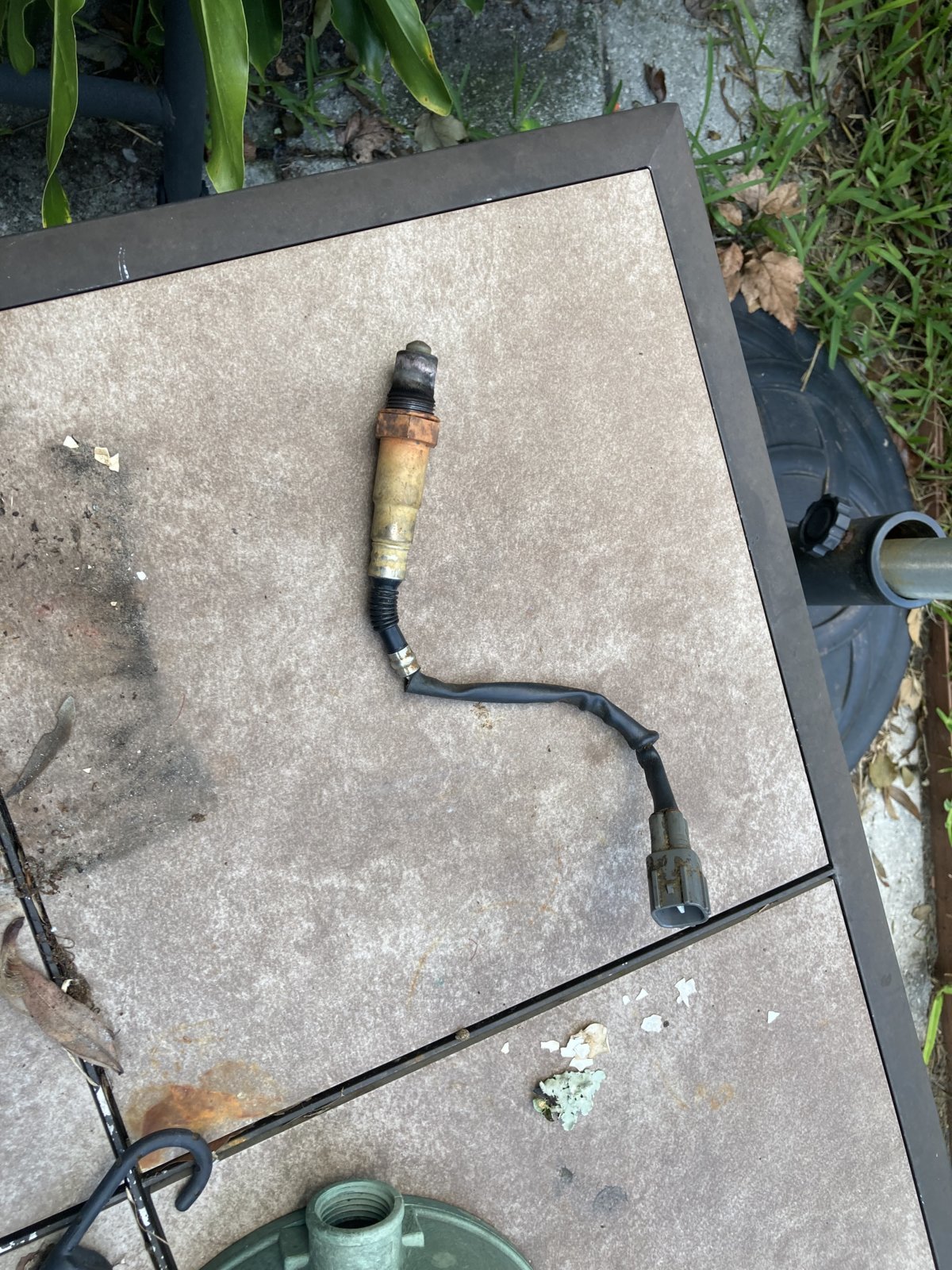

    This is the factory 02 sensor from my 95 2.7 .

    This is upstream or downstream, or the same principle applies to both?
  20. Aug 11, 2024 at 7:01 AM
    #60
    F.I.LetsGoFishing
    F.I.LetsGoFishing Well-Known Member
    Nov 9, 2011
    #66729
    160
    95.5 4wd 3rz mt
    Neglected Original
    Mine is 4wd so both sensors up and down stream are the same.
    I did needed to use a line wrench to work between the studs. But in looking a your sensor from RA, I think theirs may have been pressed together but I can not see the top of it. If it looks like a bolt at the top of that bracket then it will unscrew but you may have an issue with the probe length which would be what that spacer is for
