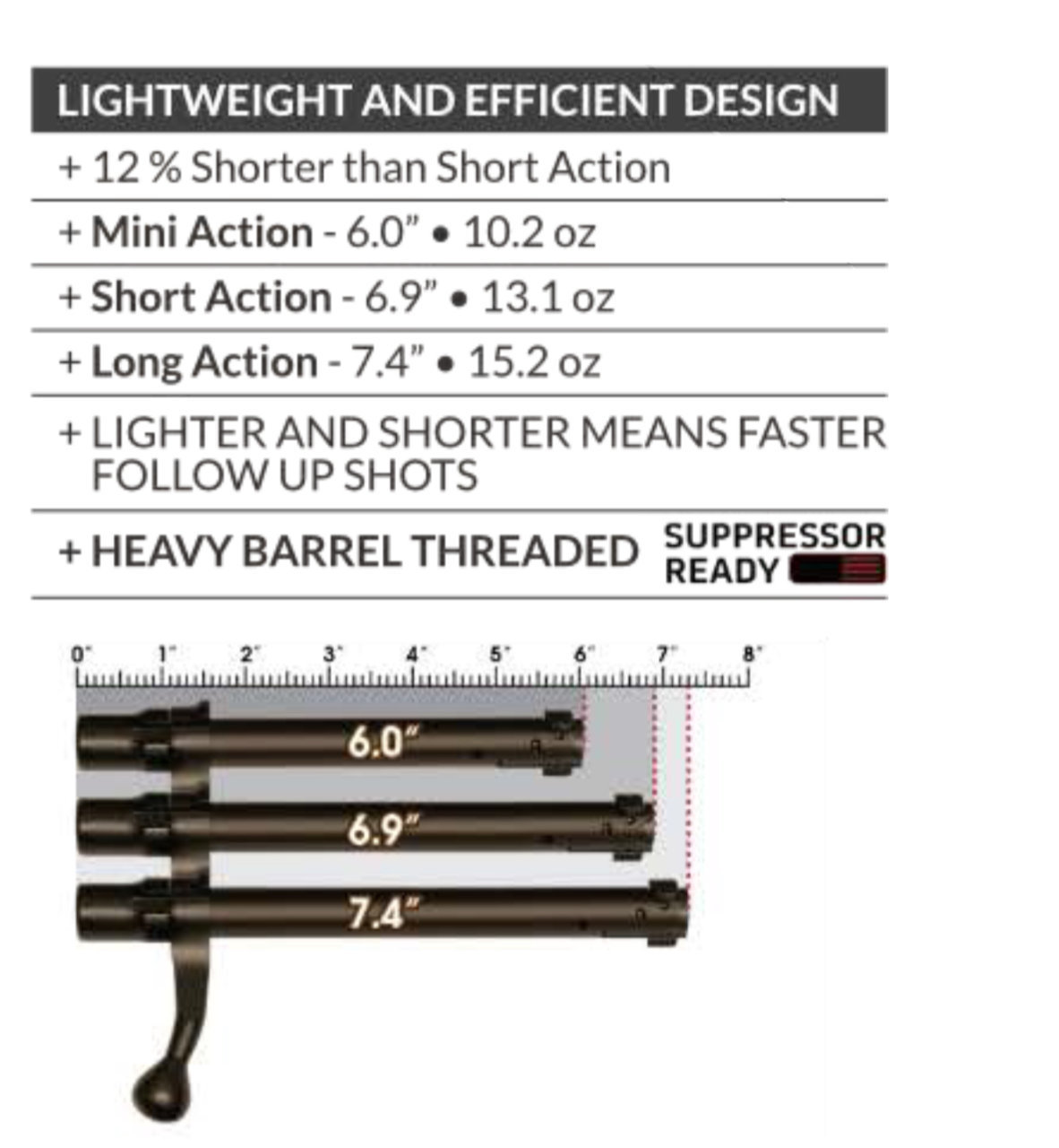

    This is the best I can do as for “How to” know what one you have
    Found it in their catalogue.
    https://www.howausa.com/wp-content/uploads/2022/01/2022_LSI_Howa_Catalog_LQ.pdf
    Kyle_[OP] likes this.
  10. Jan 29, 2023 at 8:51 PM
    Kyle_
    Kyle_ [OP] A guy and his expensive hobby
    Sep 3, 2021
    #376085
    755
    Kyle
    SoCal (805)
    2021 TRD OFF-ROAD 4X4 DCSB
    @tacoma.kyle on IG
    I have not yet received my howa 308, however I just measured the bolt on my fathers howa 308 and it came out to be:
    6 15/16 inches
    Just one small hash mark on a ruler away from 7 inches so I would assume it’s the short action.
