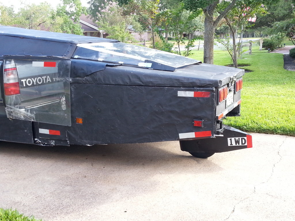

    Belly pan in white... ;)

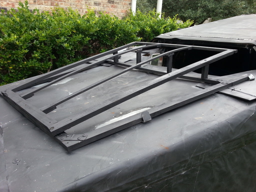

  9. Sep 11, 2015 at 11:57 AM
    #189
    BamZipPow
    BamZipPow [OP] T-100 visitor
    Jun 15, 2014
    #132028
    219
    The Woodlands, TX
    Aerodynamic T-100 and trailer
    Custom aero cap, full length belly pan, adjustable rear diffuser, side skirts, aerodynamic trailer

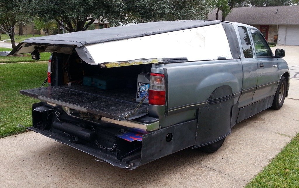

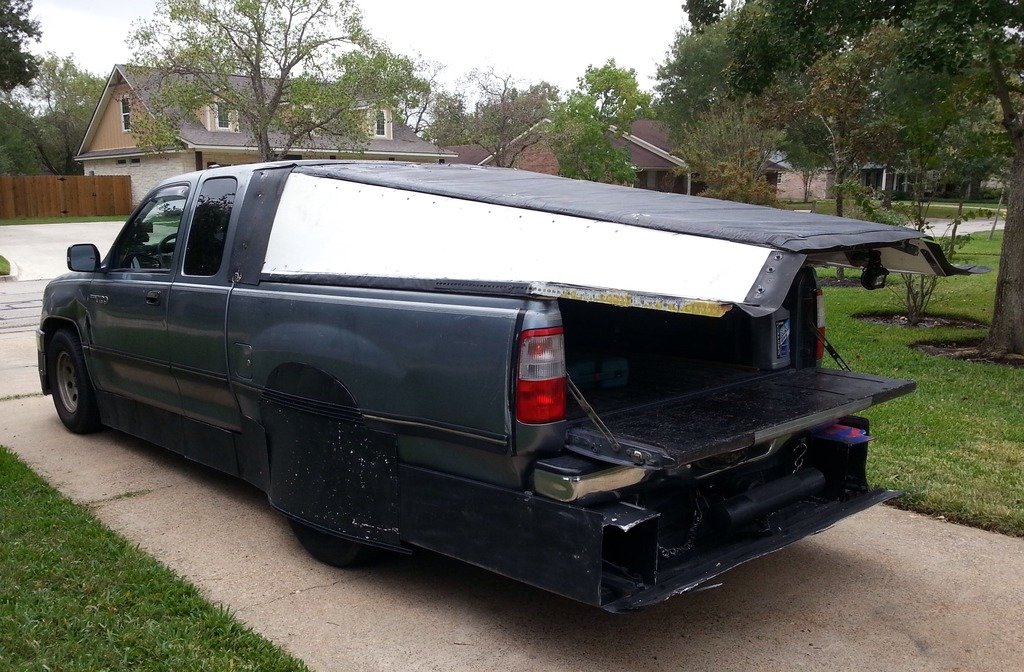

    The rear canopy has been rebuilt with the top portion tapering back. Looking through the canopy is a little bit clearer now. ;)
    After I took the last shot, I went ahead and installed the remaining side pieces to the rear. ;)

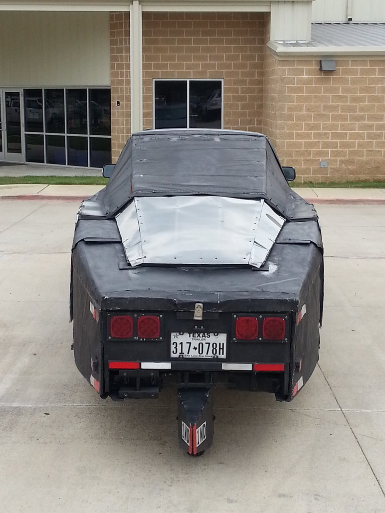

  11. Sep 11, 2015 at 2:07 PM
    #191
    BamZipPow
    Jun 15, 2014
    #132028
    219
    The Woodlands, TX

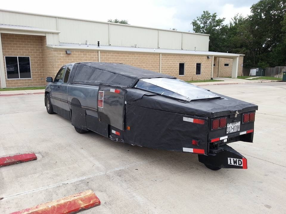

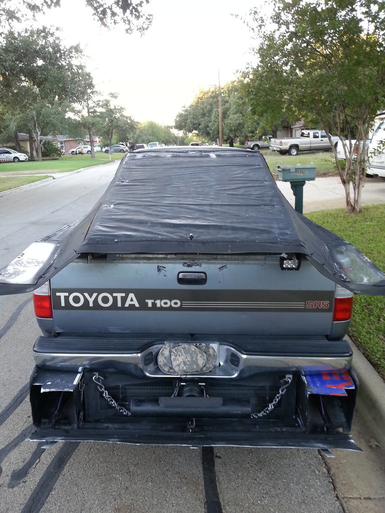

    Rear view... ;)

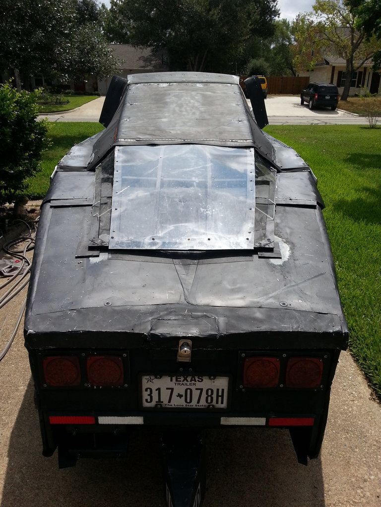

    Current rear quarter view... ;)

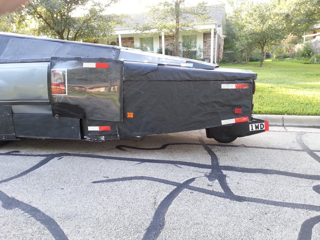

    Here's my belly pan thread that I started back in 2009.
    http://www.toyotanation.com/forum/60-t-100-forum/325836-under-belly-pan.html
    I would not recommend riveting your belly pan directly to your frame as it will be very difficult to remove when you have to do maintenance. I would try to go with a frame setup or even a skid plate setup depending if you do any off-roading. ;)

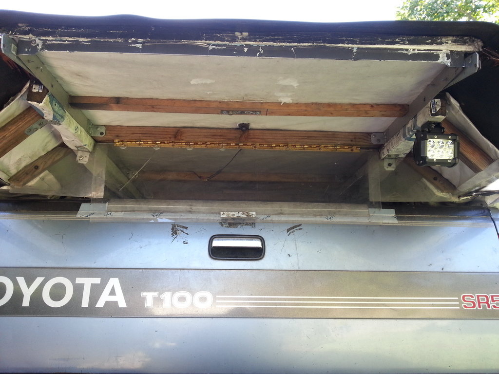

  16. Oct 28, 2015 at 9:07 AM
    #196
    BamZipPow
    Jun 15, 2014
    #132028
    219
    The Woodlands, TX

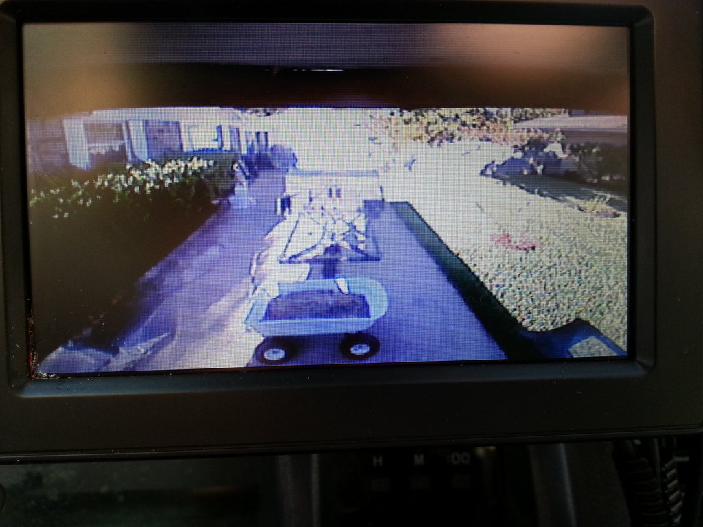

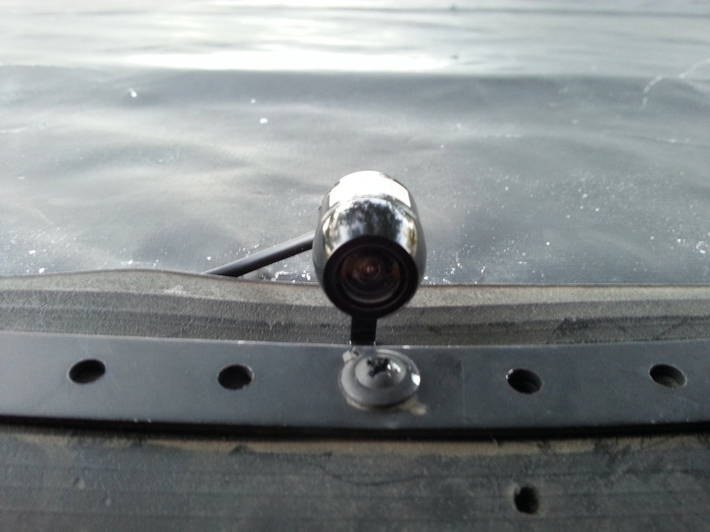

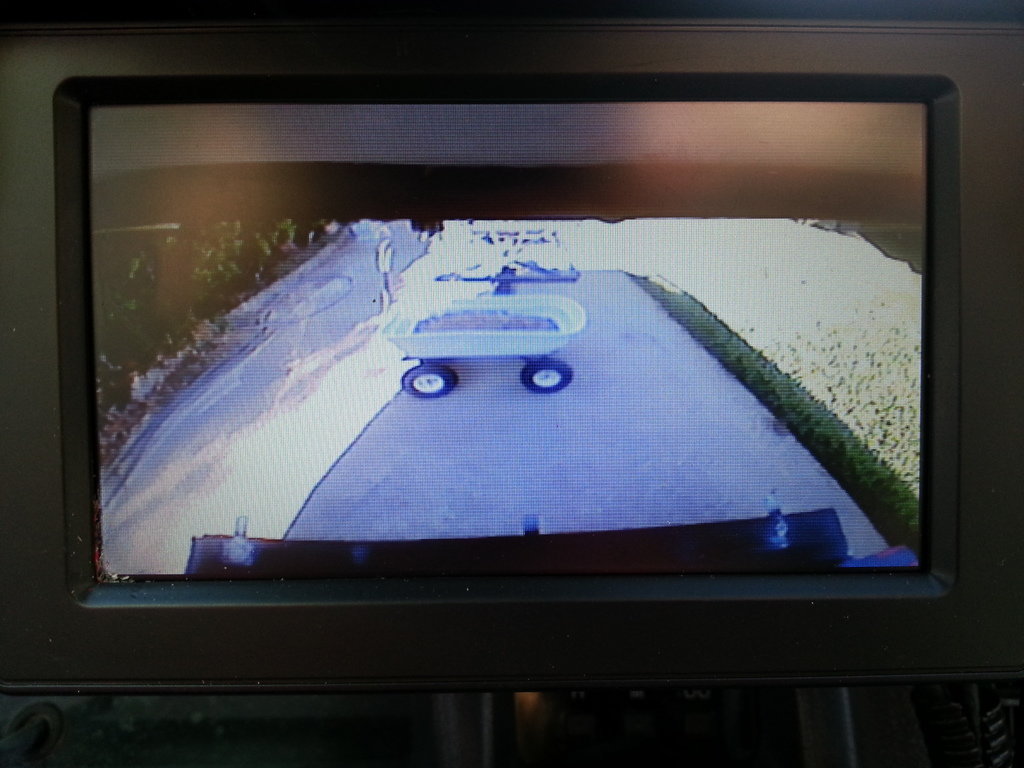

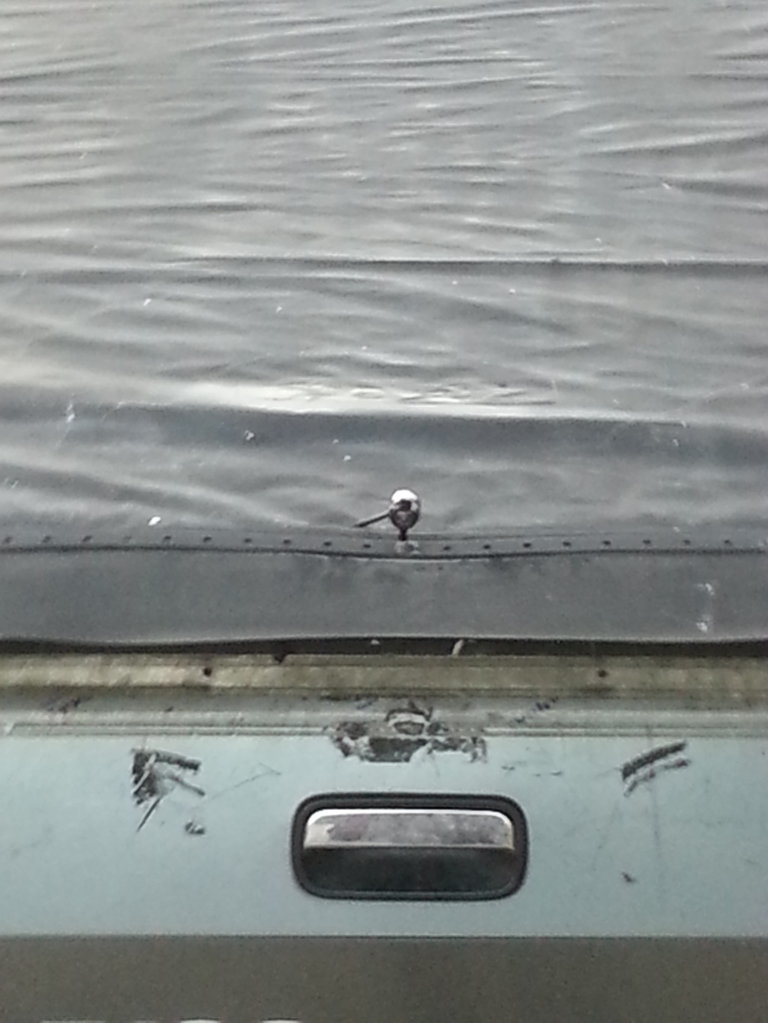

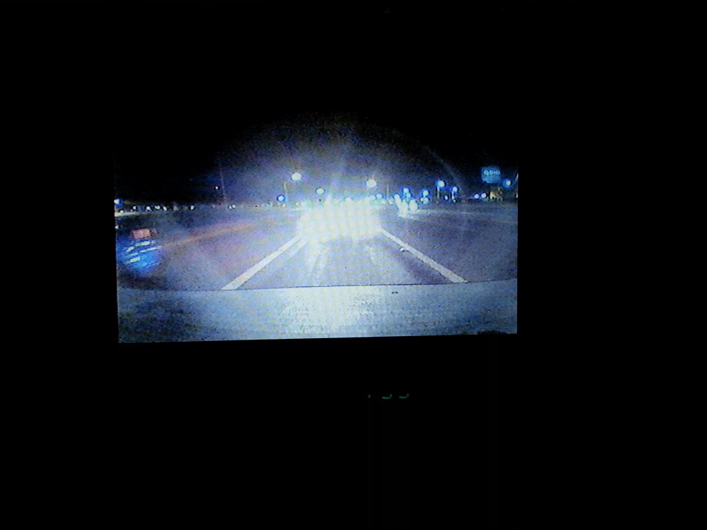

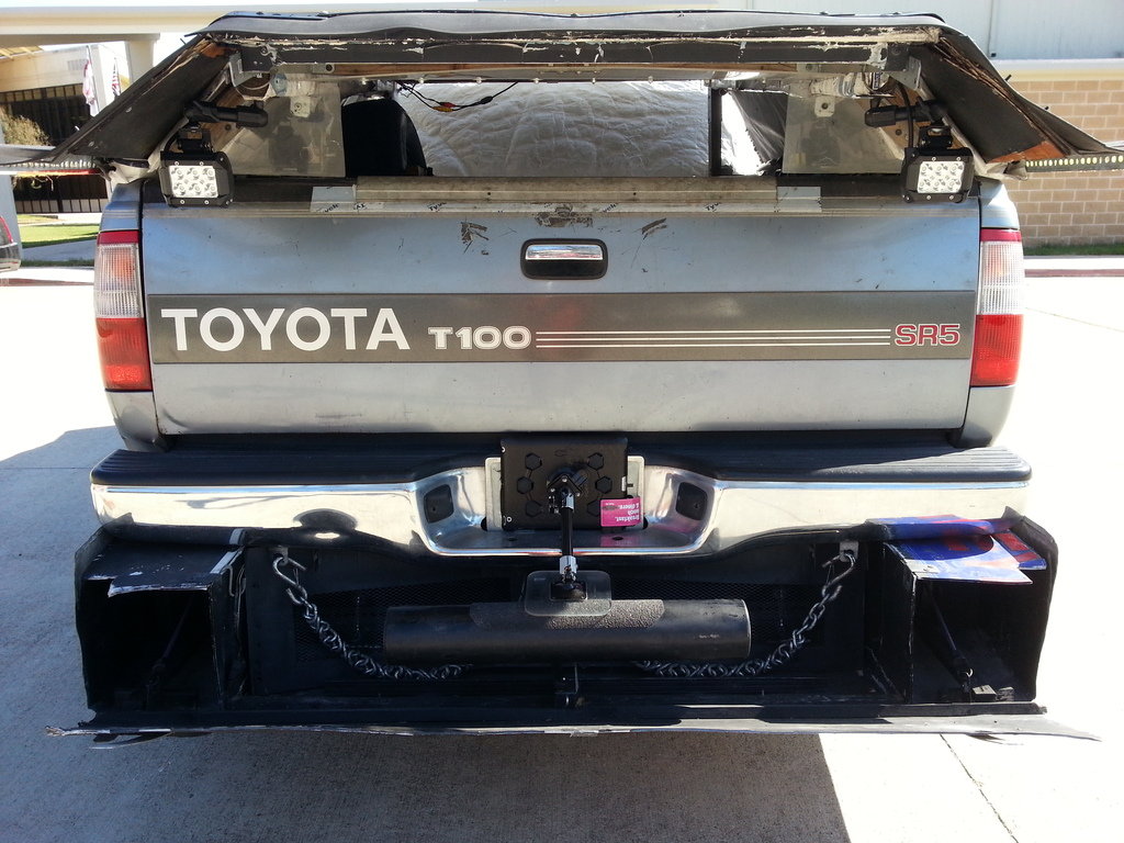

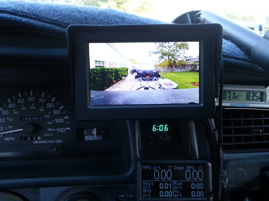

    Trying out a placement for the rear camera...
    For this backup camera, it had a very poor low light performance along with a terrible glare issue when used a wide-field camera. :(
    I ended up putting it under the hatch so it would perform best in the environment that it was designed for. ;)
    Hatch closed...
    Hatch opened...
    I will have to look into a bigger camera that will have better performance fer a wide-field rear camera. For now, this camera will be just fine to see directly behind the tailgate. ;)

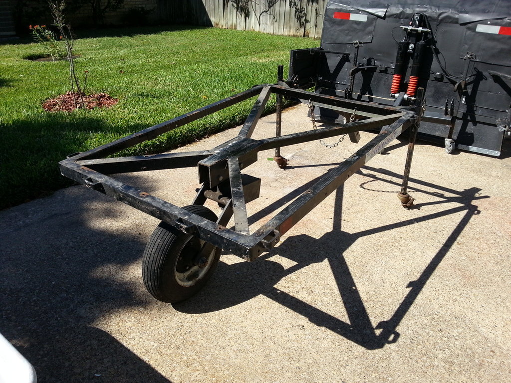

  17. Oct 28, 2015 at 9:15 AM
    #197
    BamZipPow
    Jun 15, 2014
    #132028
    219
    The Woodlands, TX

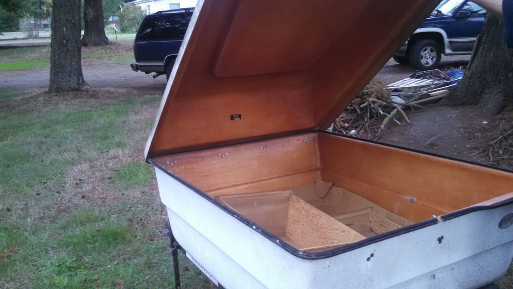

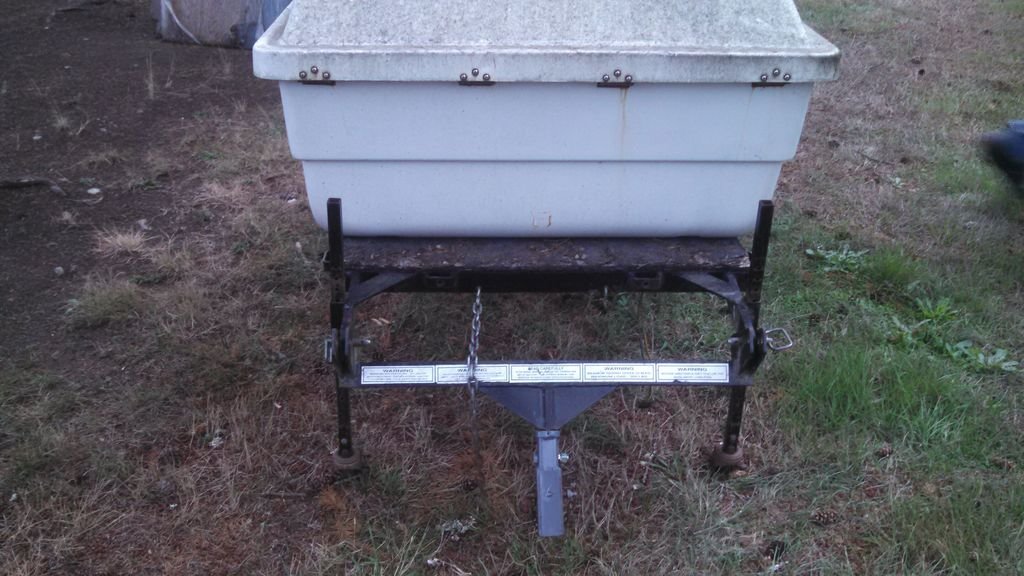

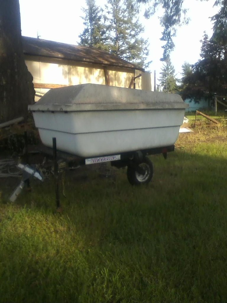

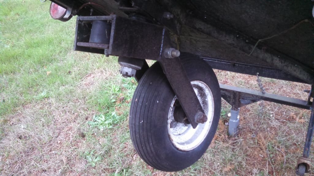

    My new single wheel trailer frame is here! It only has about 200 miles on it when it was parked about 20 years ago! This baby is practically brand new! :D
    It was shipped disassembled so I had to reassemble it so I could roll it out of the street and into the driveway...which was a better choice than trying to drag it. ;)

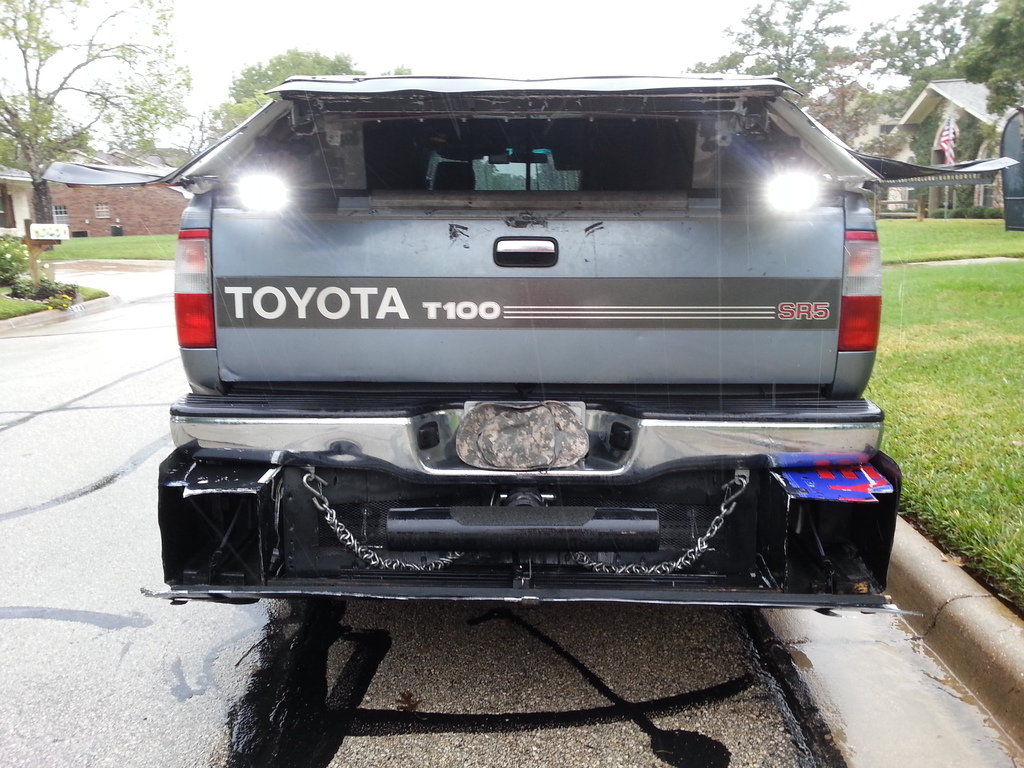

    Rear auxillary lights are now mounted on manually adjustable mounts. ;)
    I'm going to install 3-way switches so I can turn the lights on either in the cab or when I'm in the back end of the truck. ;)

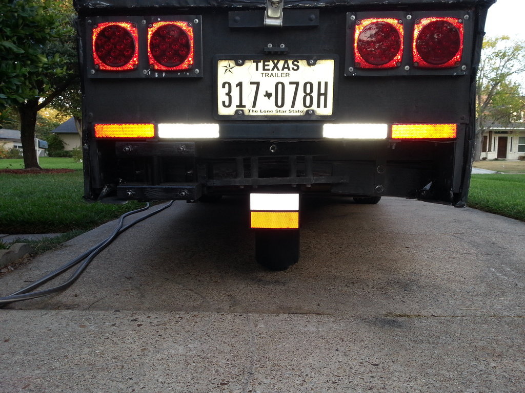

  19. Nov 5, 2015 at 10:23 AM

  20. Nov 7, 2015 at 9:36 AM
    #200
    BamZipPow
    Jun 15, 2014
    #132028
    219
    The Woodlands, TX
    Hooked up the rear auxiliary lights with 3-way switches so now I will be able to see more behind me at a flip of the switch from either the cab or from the bed. ;)
