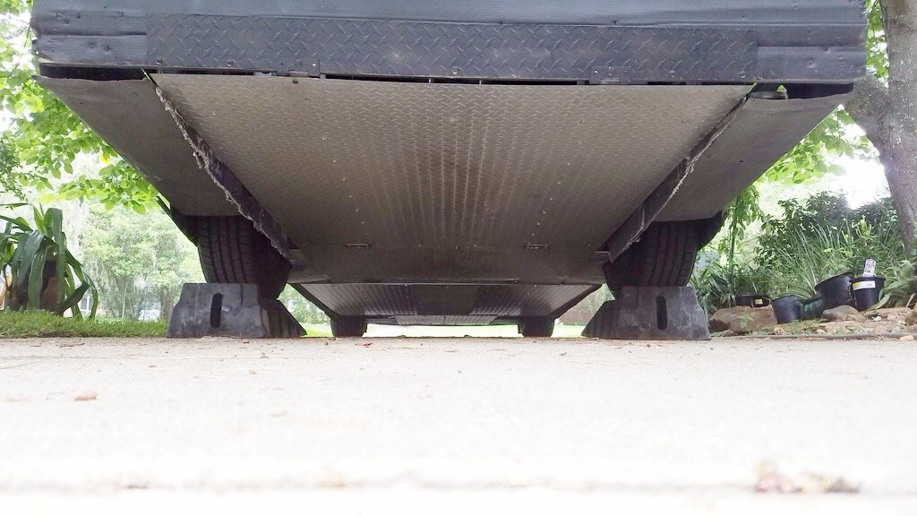

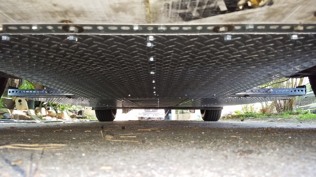

    All belly pans completed in aluminum diamond plate (except for a small section in the middle)! This view is from the front. ;)

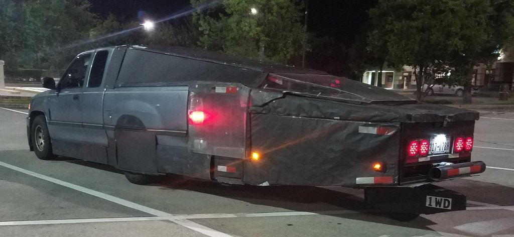

    Fully rigged up and ready to go scare some locals up North with the new configuration!

    Nice touch with the 1WD.
    Need some disc hubcaps up front.

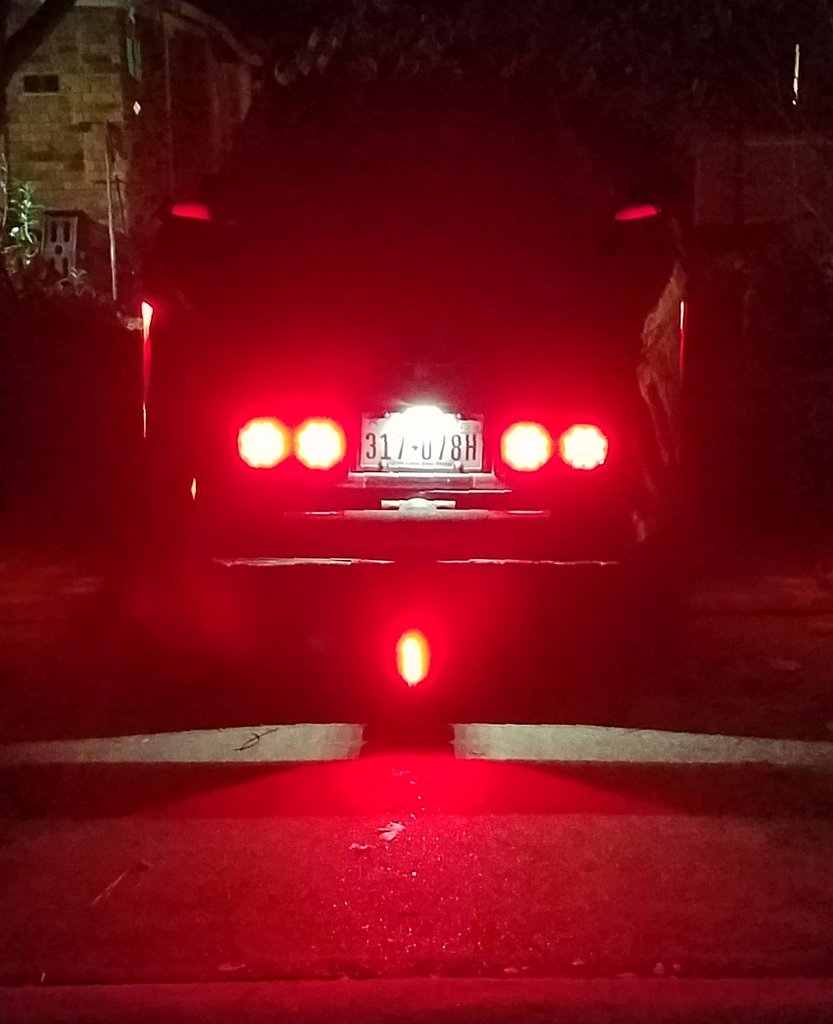

    New rear light...

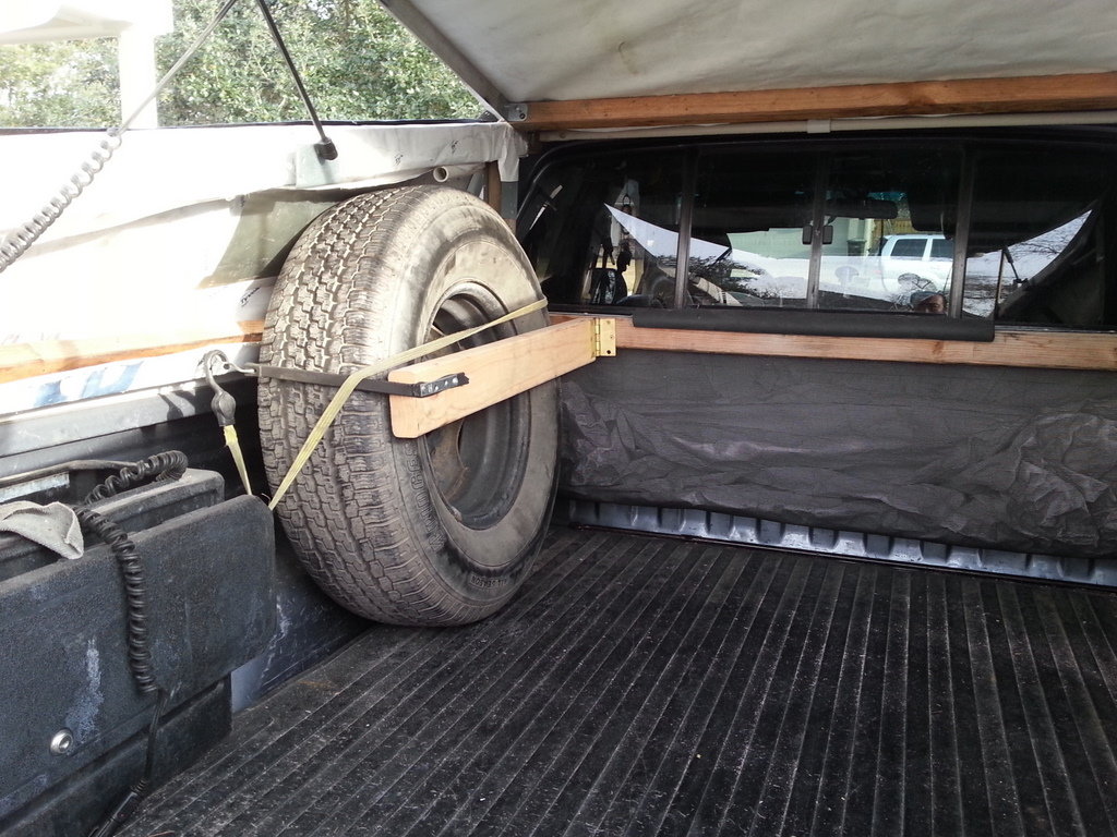

    I see a lot of S-hooks, is that how you get the spare tire down should you need it?

    The S-hooks you're seeing is for the safety chains when the trailer is hooked up. I was keeping them on the truck but now I just keep them on the trailer. ;)
    I had thought about the spare tire which was located under the bed and decided to mount it in the bed instead. ;)

    Okay. Then another question; did you put the tire on driver side to not obstruct vision? I would have put it on passenger side to offset weight of the driver, but it is rather tall.

    Yes, the primary reason was to not obstruct the driver's vision as much as possible. I tried mounting it centered but it restricted vision as well as access through the sliding window. I even tried laying the spare flat in the bed but I had to keep moving the spare around when I had to carry stuff in the bed. There are times where I have to take everything out of the bed including the spare tire to carry stuff but I only do that for local runs. If I really need the spare tire and space in the bed, I'll just stuff the spare tire into the trailer. ;)
    I guess I've really never considered mounting the spare tire under the cab but I do have space under there between the belly pan and the bottom of the cab. I'd have to come up with a special mount to make sure the spare tire was secured really well. ;)

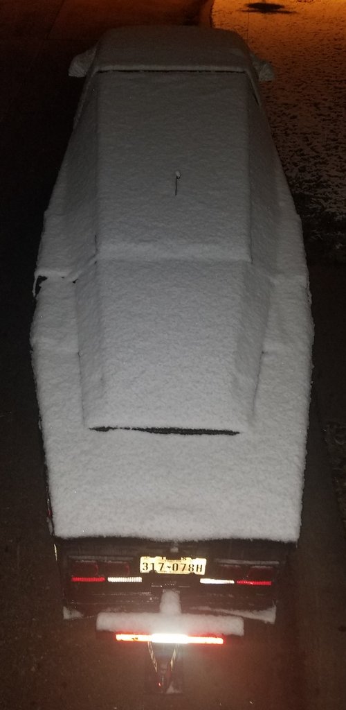

    Got a little bit of snow here in Houston. ;)
