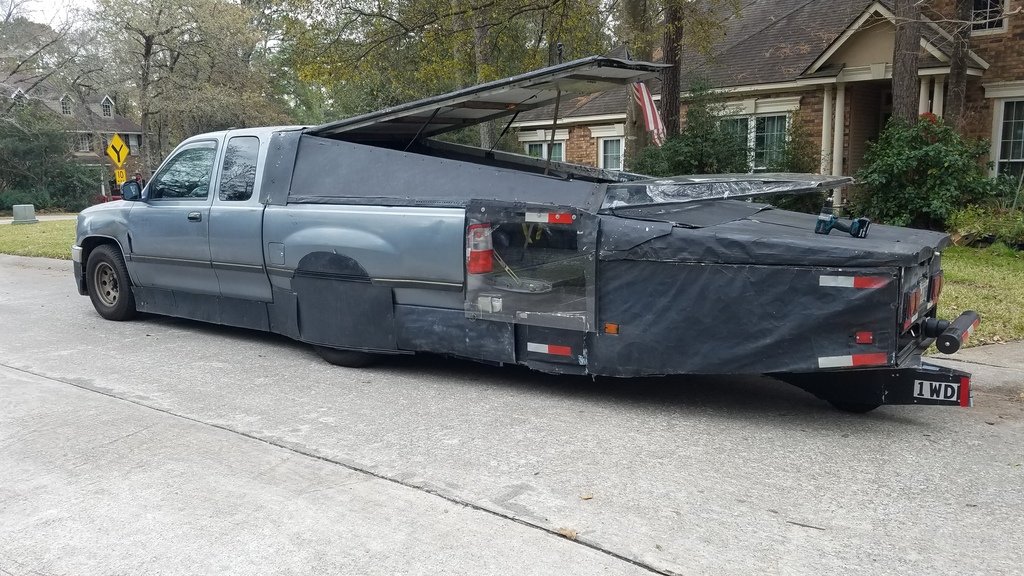

    New air brakes! ;)
    I've moved the rear window canopy attachment points from the aero cap hatch to the aero cap main support rails. Now I can open the hatch without having to take the rear window canopy off first. This will allow me to easily open the hatch to load things into the bed instead of trying to squeeze it through the clear gap cover space. ;)

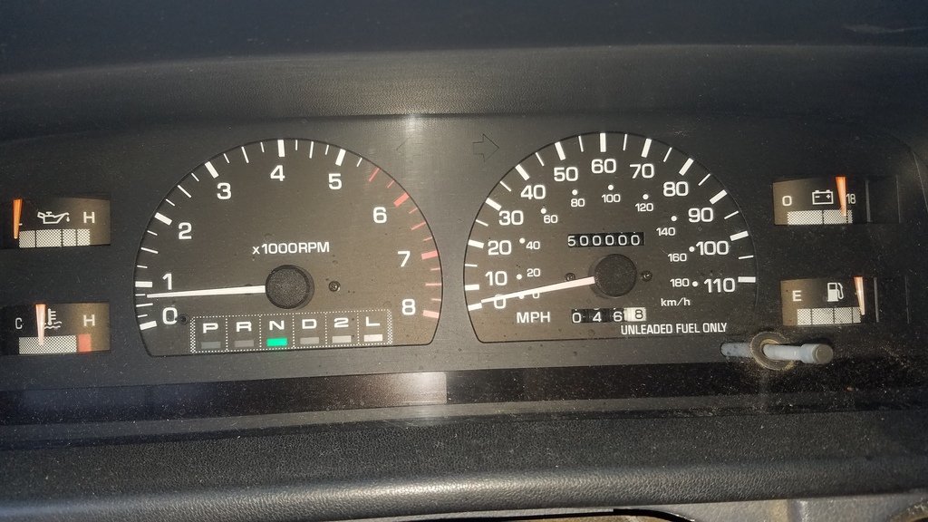

    Half a million! :)

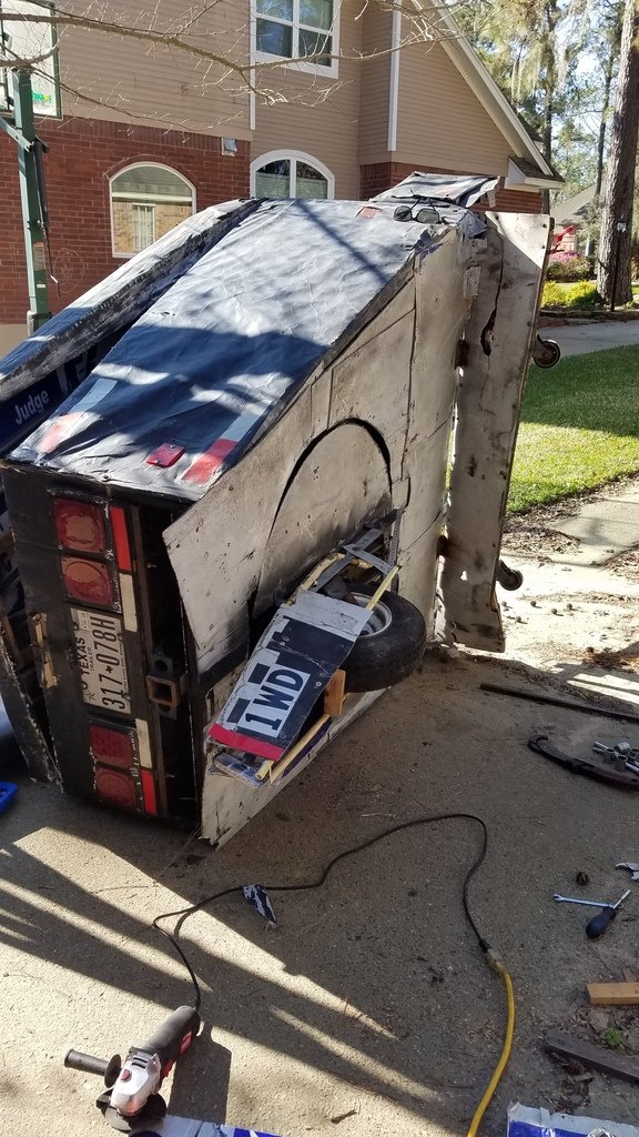

    Teaching the trailer to roll over! :p
    I'm actually rebuilding the wheel pant but the swivel had locked up due to the winter salt during my trip to Lincoln, Nebraska so it was easier to work on it by tipping the trailer on its side. ;)

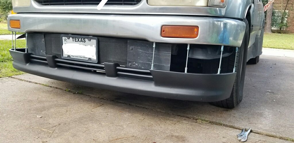

    I just modified it again using some threadall and some couplers. I used some pipe dope (Rectorseal Tru-blue) on the fasteners to keep them from rusting together or backing out. My previous attempt worked okay until it came time to take it apart. Everything was rusted together so I had to cut stuff out. ;)
