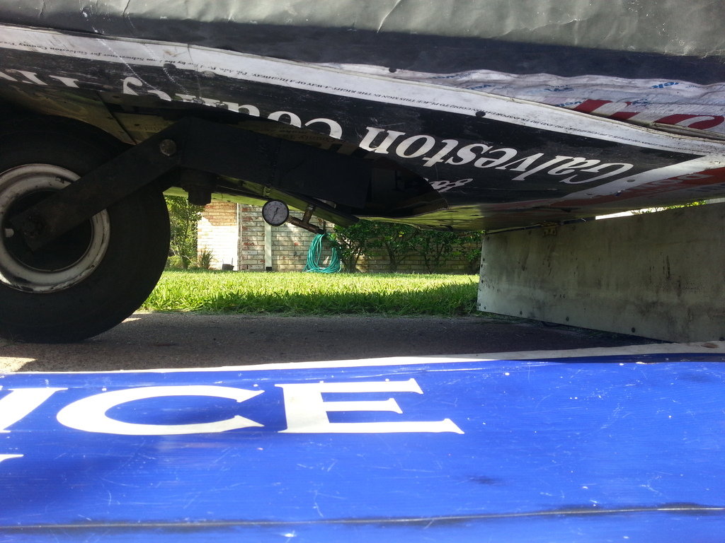

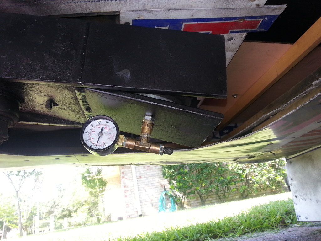

    Finally got around to using some Rectorseal Tru-Blu on the air bag spring fittings and I'll see if it will hold the air better this time around. I used some Rectorseal 5 on the fittings when I first installed the air bag spring and the air must've leaked out as I was traveling back home. :(

    My first attempt with the air pressure gauge on the first air bag spring didn't turn out as well as I expected it to so I'm going to try installing the air pressure gauge again using the Rectorseal Tru-Blu thread sealant this time around. This air bag spring seems pretty happy around 25-30psi with a minimal load in the trailer. ;)

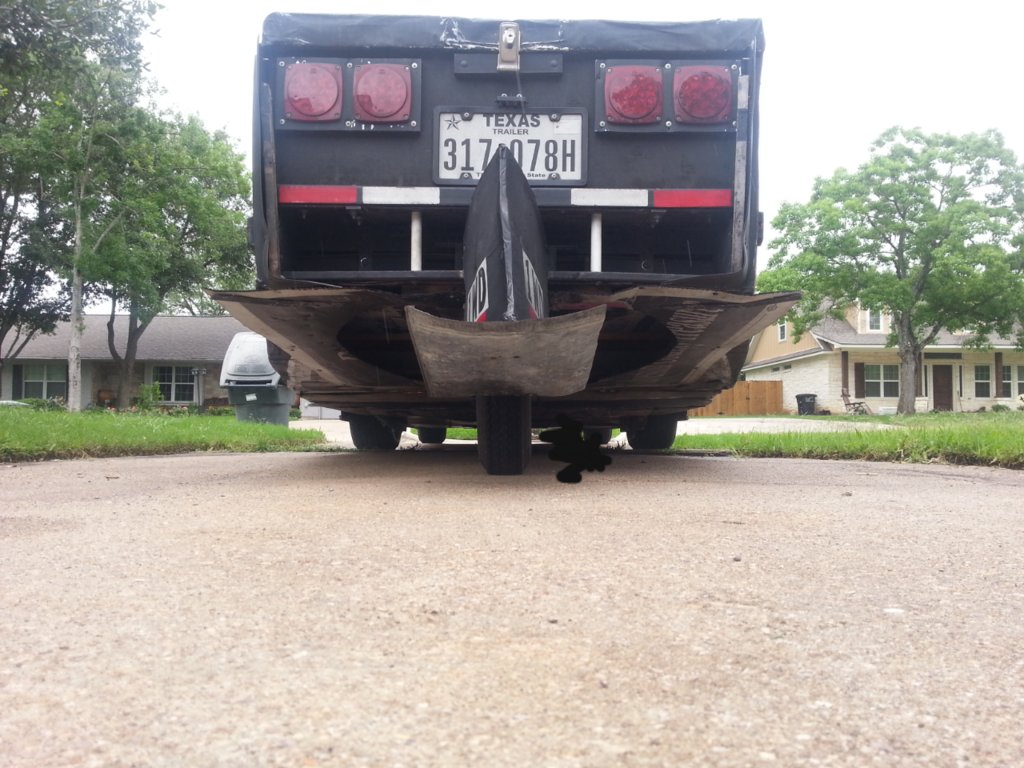

    Added in a skid/wing plate to the bottom of the tail cone. ;)
    Got an indicated 27.3mpg at 65mph for the run from Navasota to Hearne (best ever) and an overall of an indicated 26.6mpg at 65mph for the run back to College Station! Possible potential for better aero? ;)

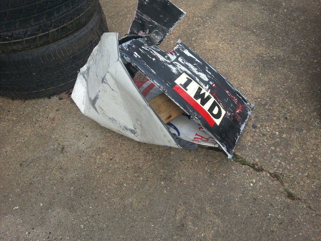

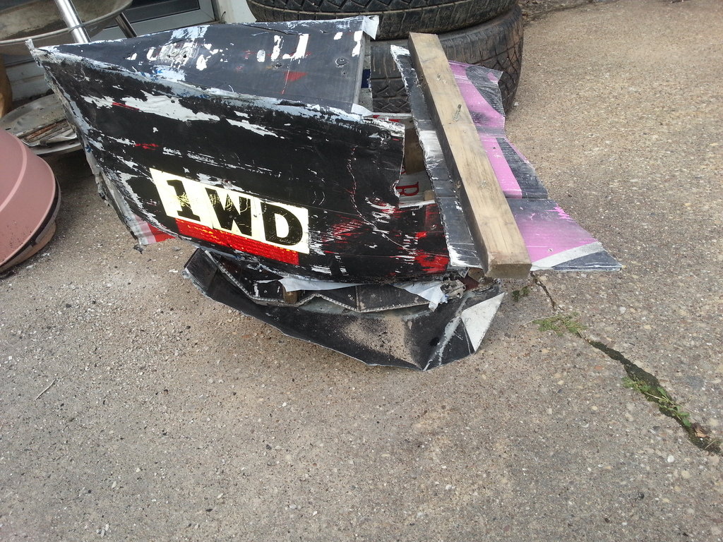

    Crushed the tailcone backing out of the driveway the other night and the road finished it off by ripping it from the support frame. :(
    Needless to say, I'm going back to the Coroplast mudflap and will probably stick with it as it is simple and I don't have to worry too much about damaging it too badly. ;)

    Crunched and munched... :(
