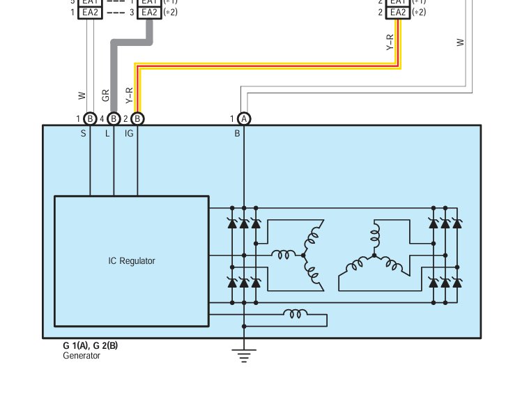

    When I got the "new" junkyard engine bay fuse/relay box the ALT plug was broken so I just crimped & soldered some female spade connectors on the wires in place of the plug and stabbed them onto the male terminals on the ALT. (They are tight)
    So just to make sure I've got it wired right. The way ive got it on the ALT itself is...
    Top left...white (7.5A ALT fuse)
    Top right...yel/red (Ignition)
    Bottom left...nothing
    Bottom right...gray (charge light)
    Is this right?
    my plug was the green "G2".
    Generic diagram screenshot attached
  13. Jul 10, 2024 at 2:55 PM
    #33
    TnShooter
    TnShooter The TacomaWorld Stray
    Sep 2, 2010
    #42625
    21,321
    Deogee
    07' TRD Off-Road, Auto
    STOCK
    Looks like you got it right to me.
    1 - White
    2. Yellow/Red
    3. Not Used
    4. Gray

    Are we 100% sure that those are pins 1, 2, and 4 on the altenator itself tho?
  15. Jul 10, 2024 at 3:03 PM
    #35
    J4R
    J4R [OP] Well-Known Member
    May 29, 2024
    #450615
    76
    2005 4R 4.0 4X4
    2009 Tacoma motor
    As in physically where I have them
  16. Jul 10, 2024 at 3:05 PM
    #36
    J4R
    May 29, 2024
    #450615
    76
    2005 4R 4.0 4X4
    2009 Tacoma motor
    It looks to me like 1 and 2 should be on opposite sides as in1 on the top roe and 2 on the bottom row but hell idk
  17. Jul 10, 2024 at 3:06 PM
    #37
    TnShooter
    Sep 2, 2010
    #42625
    21,321
    Deogee
    STOCK
    It will be "mirrored" on the alternator.
    It's hard to explain. What would be on the left, would be on the right when plugged in the alternator.
