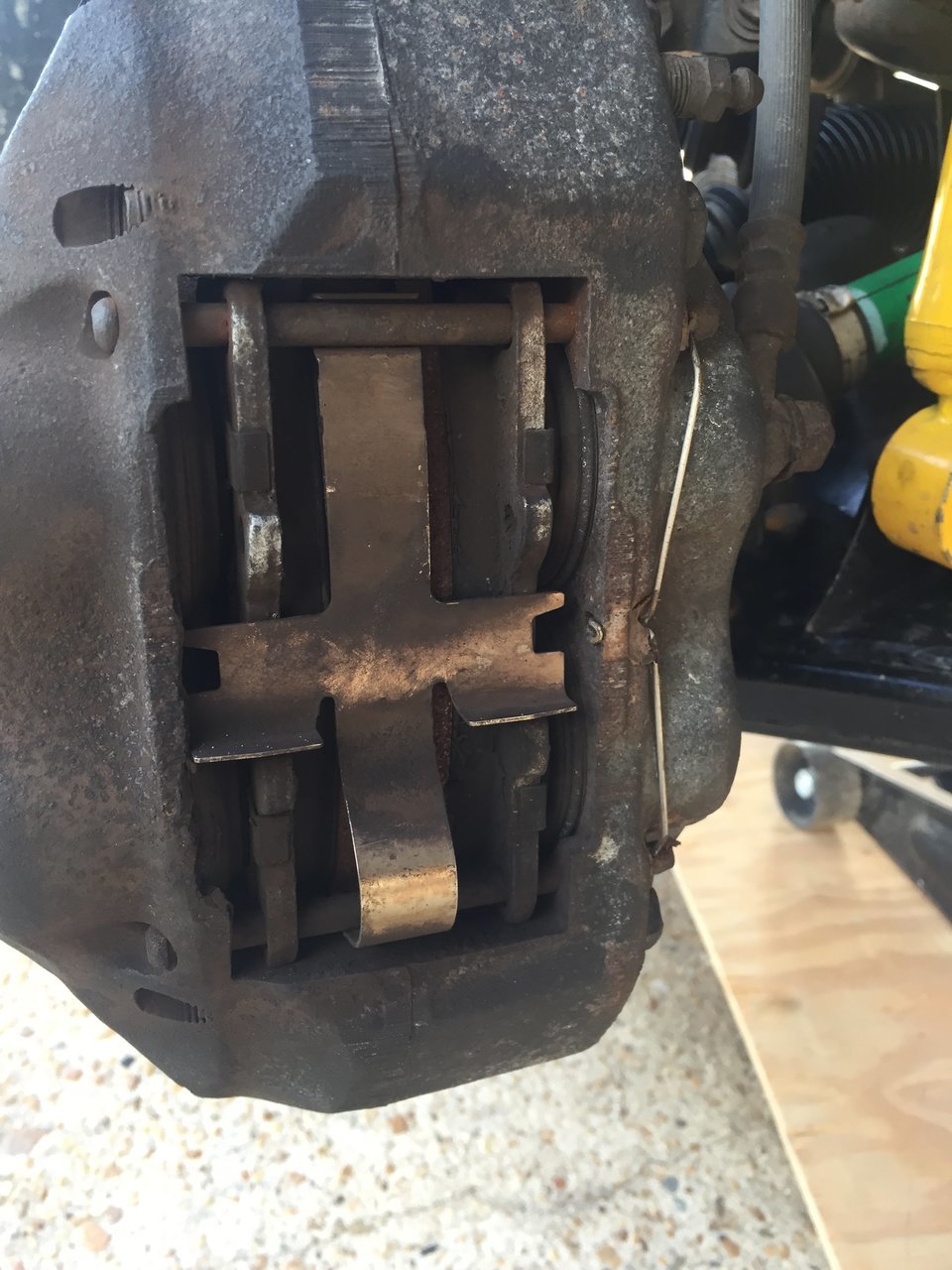

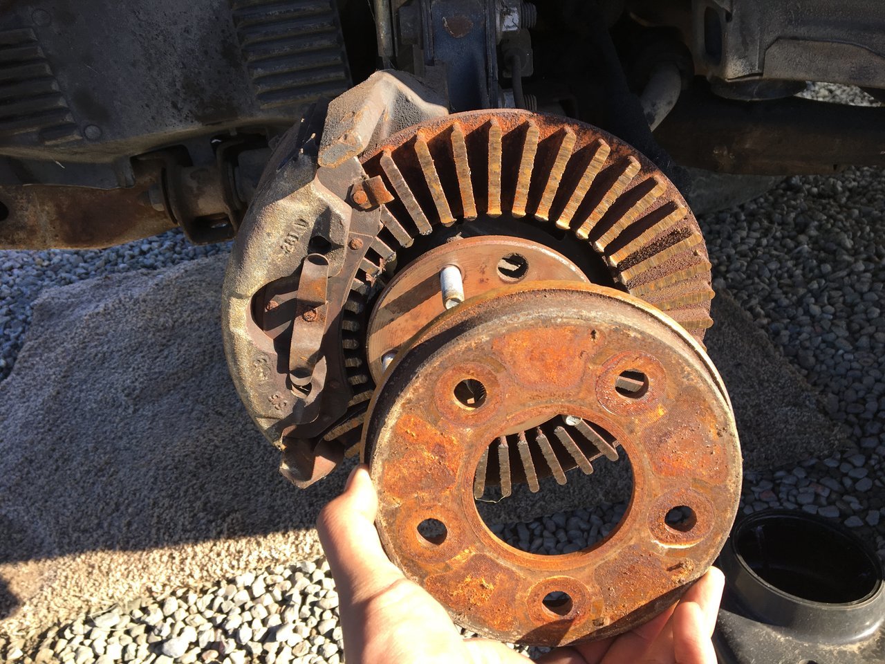

    Alright guys - so i jacked it up, and spun the wheel. There was noise, like what i would think a wheel bearing would sound like...
    but i thought it sounded like the brakes to me - so i did it on the other side... same noise. ...both wheel bearings bad?
    then i took the wheel off and decided to check the brakes, they were contacting the wheel. so i took a screw driver/pliers and pulled the pads off the rotor and spun them - no sound...
    so back to the drawing board i guess..
    here are the videos - in order
    jacked up - spinning
    picture of brakes close/contacting rotorIMG_9409.jpg
    video after i separated ( you can hear my cv boot a little and a pad is contacting every so often)
    any other ideas - maybe stick a gopro underneath the car?
    thanks guys -

    The pad wear indicators look like they are deformed and rubbing on the rotor, even though the pads have some thickness?
