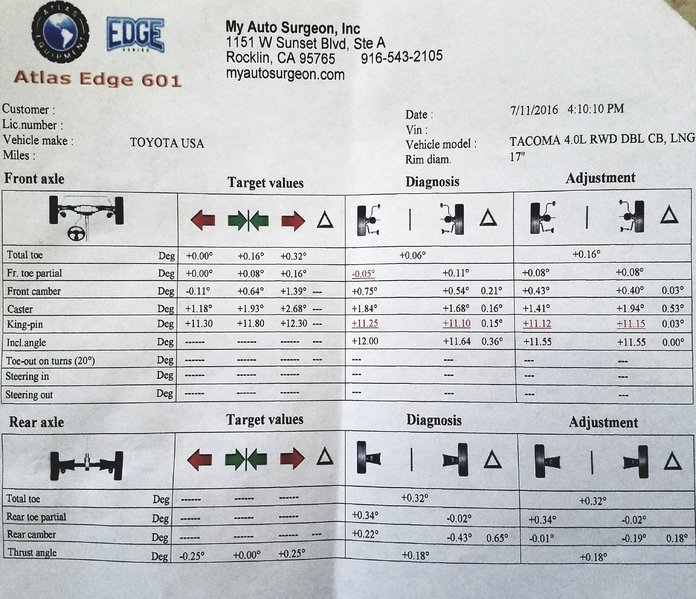

    I just got realigned, and I told them my truck was lifted and they said they had experience with lifted trucks. Anyways I know nothing about alignments and was wondering if this looks right...

    Ill try to get a better pic of the paper vertically...

    You have 1/2 degree more caster on right side which is good for crown in road. I like over 2 on caster with bigger tires and lift but sometimes its not possible without changing stuff. Everything else looks good.
