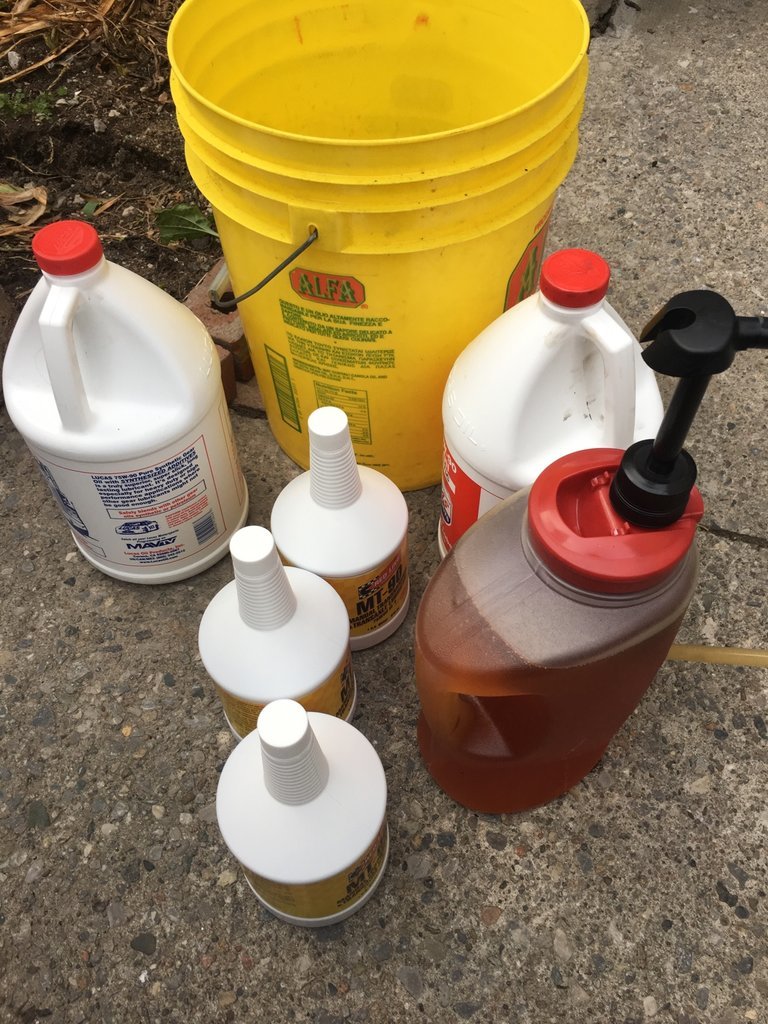

    I ordered the following.
    2 gallons Lucas Oil Synthetic 75W-90.
    3 quarts Red Line MT-90
    1 pump thing.
    By my calculations that should allow me enough to flush some through the cases as well.

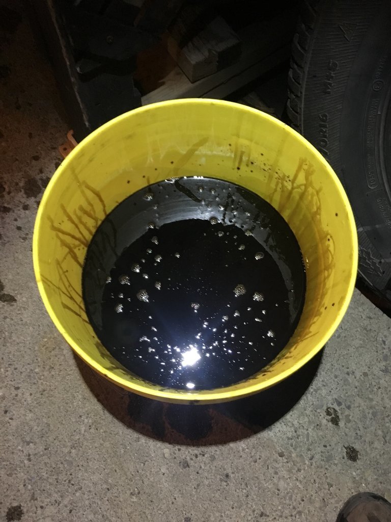

    So I got everything done but the front diff. It was quite easy. Gave the bolts a little PB blaster love prior to attempting it. One thing I noticed was the inevitability of oil everywhere. The pump I got fit perfectly into a 3qt Rubbermaid juice mixing jug that I got. This allowed me to measure. Most spec measurements were fairly close. The transmission I was around 1/4qt shy of the measurement. It started to flow out despite my best efforts to put the correct amount of fluid. I let it drip a bit then put the cap on. I suspect there was a bit left that didn't drip out when I flushed it. All in all it was quite good.
    My calculations were good. It left me with 1/2qt of MT-90 and just over half a gallon of the Lucas synthetic. This was with flushing a bit out before I put the drain back on.
