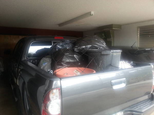

    My net came in today earlier than expected. Sender used a flat rate package so I was able to get it for $10 on Ebay. As expected the plastic clips are crap, but overall I'm pleased. I stretched it out to see how it fits over the bed and it's perfect for my intentions. I'll be going to Home Depot this weekend to get some new clips and will post a pic. Here's the net stretched from corner to D-Rings by tailgate:

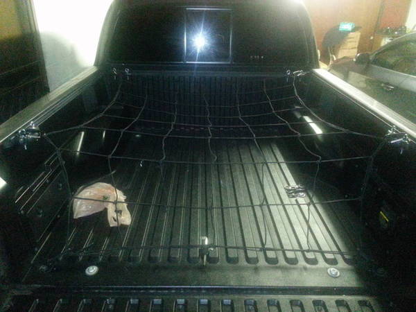

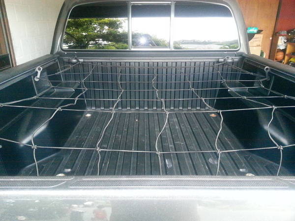

    Got some hardware at Home Depot and did this:

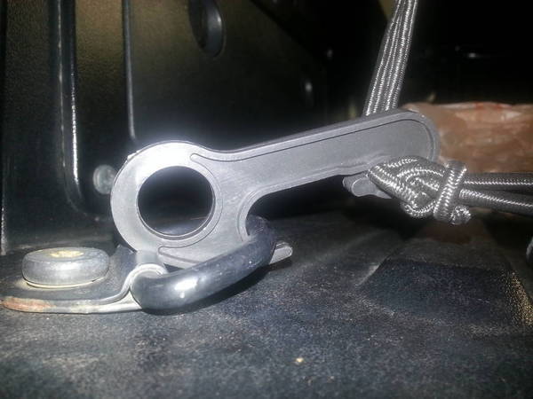

    Here's a close-up of the crappy plastic hooks it came with:

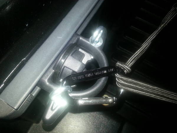

    I used eye-bolts and some spring clips for the new set-up. I like it better than clipping straight to the cleats:

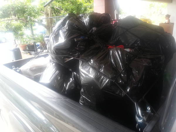

    The next day I tested it out and hit the freeway to see how it holds:
    I'm please with the overall result. All together for the net and hardware was around $20-$25, well within my cheapo budget :D

    Sweet look.
    Did the clips go right on the cleats and you just chose to use the eyelets? If they did, tell me what size clips please..thought of doing the same with mine..

    The clips weren't a perfect fit for the cleats but would have been usable. They are the 3" clips, which is the length measurement. I decided to go with the eye-bolts which are 1/4" x 3" and fit perfectly in the preexisting holes in the cleats.
