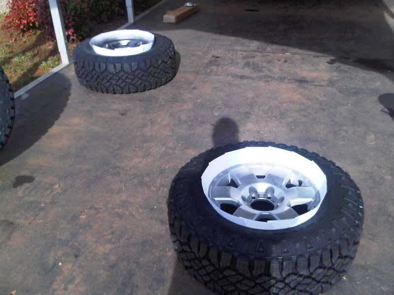

    You should be able to find it at any parts store. I used one can per 2 wheels so 2 cans total and had enough for the center caps too. I also used 2 cans of duplicolor primer sealer and 2 3M red scotchbrite pads to scuff them up. Here is a video from their website.
    http://www.duplicolor.com/training/wheelcoating_training.html
    Oh, I used paper index cards to mask them off with no tape. Here is a pic of the job itself.
    There was no overspray either.
