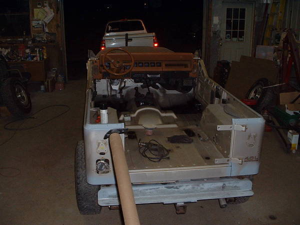

    Here's a couple pics... the day I bought it b4 taking it home -

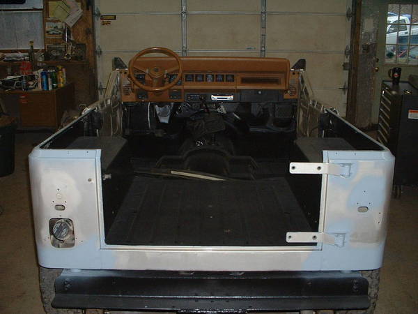

    Half way through the paint prep - (see my old Taco in the back drop?) -
    A little closer to completion -
    Fast forward a couple weeks to driveability -
    There's other pics under my gallery too... but for some reason they didn't stack in order of the repair progress.
