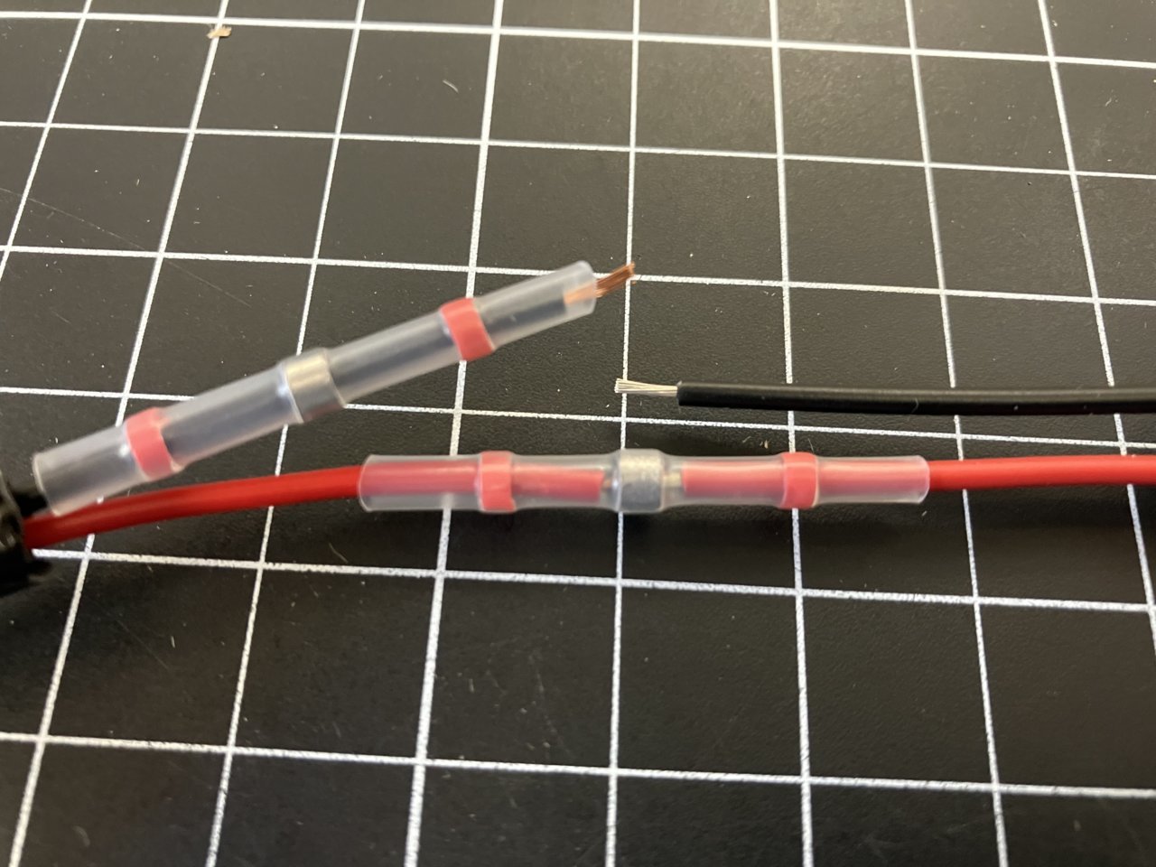

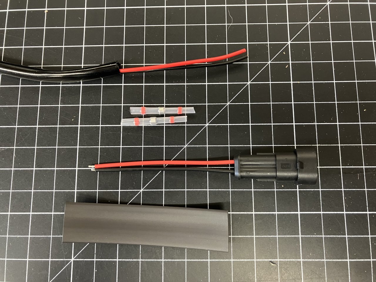

    To start with, the eBay grille lights typically come with vinyl tubing and bare wire ends. Shown here are 2 heat shrink solderless butt connectors, 1/2" outer heat shrink tubing and an AMP 2 position male pigtail, all of which come with my kit when you purchase it will grille lights.

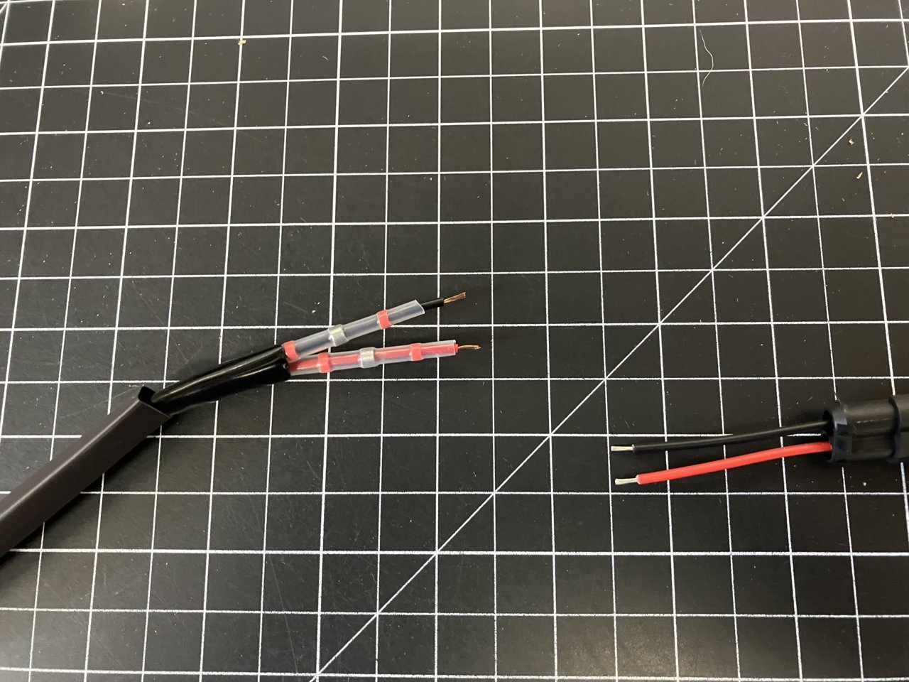

    Start by preassembling as pictured below. Note that I cut and re-strip the pigtail but you don't really have to do that if you don't want to. The lengths of 1/2" outer heat shrink I supply aren't quite enough to cover the entire length of the pigtail and I prefer connecting bare copper wire to bare copper wire rather than using the tinned leads, to ensure the best connection. Also note that you want to overlap the two stripped ends inside the butt connector so that the solder can fill the gaps between the strands. Last, note the color match, red to red, black to black.

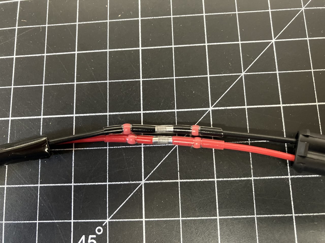

    Then apply heat to melt the solder and seal the connection. Note the bands on either side along with the heat shrink tubing will protect the two ends from being pulled apart. This connection is durable and flexible, it's a good match for this low power use where a tiny bit of extra resistance is negligible given the current draw.
    Since the wires and butt connectors are thin, you don't have to stagger to avoid bulk. Note the differences between this photo and the one above it, you want to apply enough heat to melt the solder evenly through the bare wire. This likely requires the "high" setting if your heat gun has more than one setting.

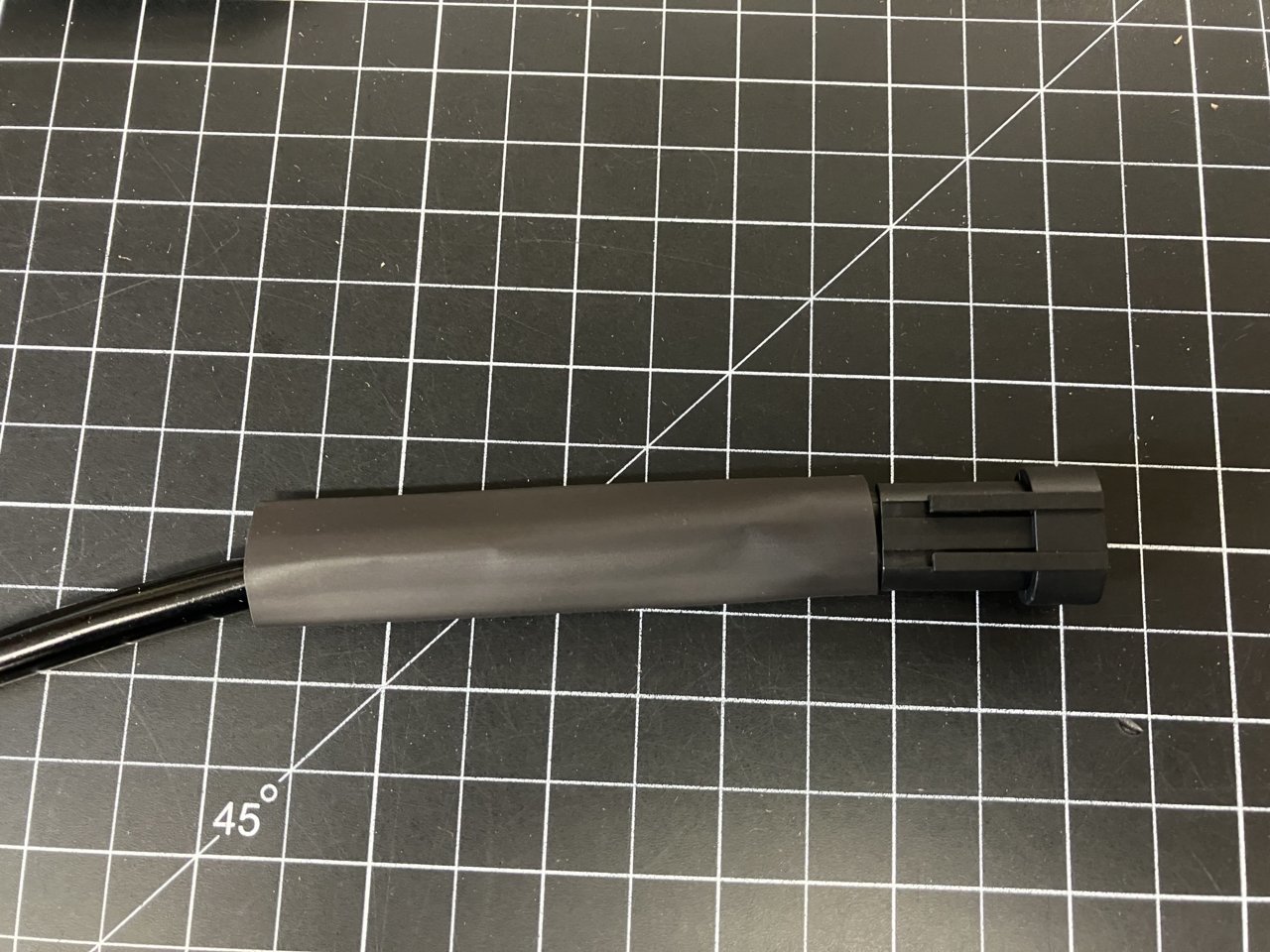

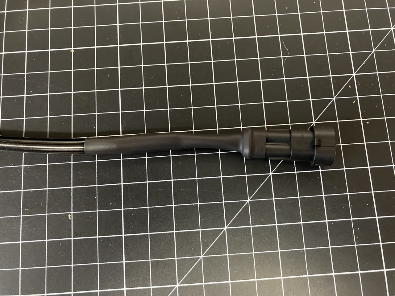

    Slide the outer heat shrink over and shrink it down for a clean finish.
