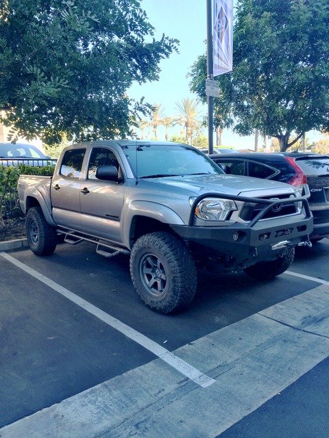

    Happy holidays to the TW Hawaii brothers. After a week here in Cali and driving my sisters van, I'm ready to go home and drive my truck. Nice Taco in the parking lot at the Residence Inn at Anaheim confirmed this:
