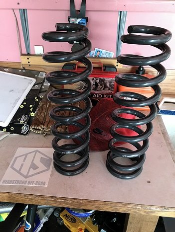

    I IM'd a coworker and guess what?...they are sitting on my desk. I have stuff shipped to work for various reasons (a loading dock being one) and I have been working from home the last 3 days. I was just expecting an email with a tracking number because it says on their web site and in my confirmation email that their process works that way. But, I'm not complaining. I'm off to work to pick it up. Tomorrow morning, I shall start the mounting process. I'm getting kinda giddy about it.

    Oooohhh, shiny. Almost too pretty to mount under my truck. Almost.

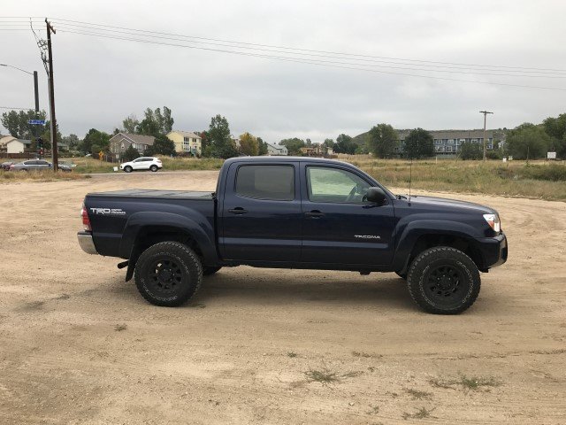

    Got er done today. Excellent product from @HeadStrong Off-Road! I am so happy I did this. I found out my stock springs must have had a little sag which disappointed me for having only 43,000 on the truck.
    Height (measured from center of hub to bottom of fender lip):
    Factory: ~20.25"
    Bilstein at 1.75 setting w/stock spring: ~21.25" (an inch...I know, right? WTF?)
    Bilstein at 0 setting w/HS spring: ~22.5" (gained 1.25 over my previous setup)
    So it's looking like 2.25" of lift (just a slight bit higher on the passenger side, but negligible...like 1/8"). I'm sure, like with all springs this will settle a bit, but the truck looks really good now (imho). Very slight rake because of my Tuff Country AAL in the back. I just added the AAL last weekend so I'm sure they'll settle together. At least that's my theory.
    The ride is fantastic. Rougher in the back with the AAL, but I don't mind at all. And the front...hmmm, I can feel more bumps, but they are dampened well. Hard to describe, but I like it better than my previous setup by a long shot. I am truly happy with these.
    I will post pics by tomorrow evening. I gotta go have a cigar and some scotch with a pal right now. Cheers!
    lo_cash78[OP] and outxider like this.

    Good looking truck, what size tires are those?

    Thank you. 265/75/16 Duratracs...so about 32x10.5.
