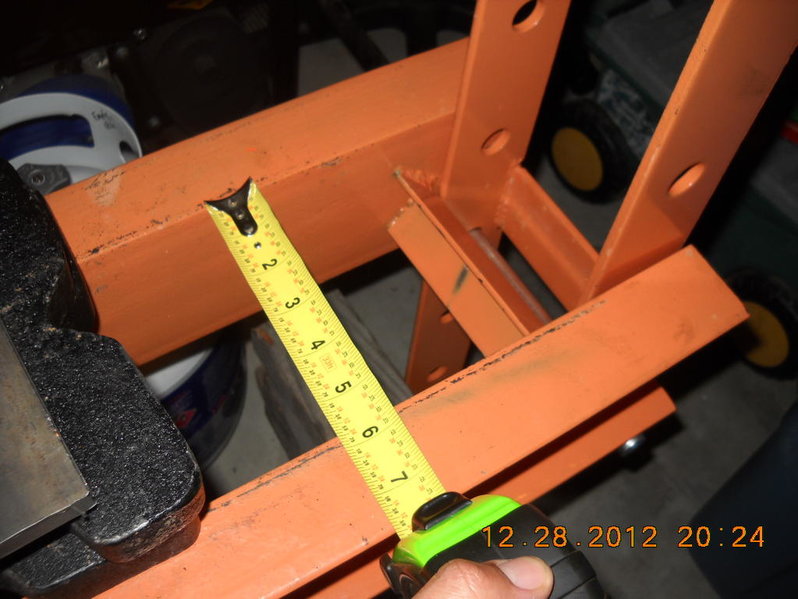

    I bought H-F's A-frame 20-ton press, #37999 . The press rails, or table, if you will, will not accommodate the 6.5 inch hubs. The rails are welded together. So, you either have to saw it apart, or make your own rails. From their current website, it appears all their presses except, maybe, the 50-ton hydraulic press, are designed with welded rails. But, I can't tell from the pics about the inside spacing. I can only confirm for the 37999#.

    Ok just for future reference. Don't cut those rails on the press. They there for support. To separate bearing all you need is two pieces of small cinder block on the top of rails . I have the same press. That's what I did to separate my bearings.
    To pack bearing: use needle for grease gun to fill bearing on the steel seal side. Fill every space with grease. For the side with rubber seal you can use fingers.

    I tried two small bricks I had laying around but they would not hold up to the pressure; neither did two 4X4 blocks of wood. The small contact area was too much for them.
    The V-brace doubles to keep the rails from popping out under pressure, a safety feature, and to be able to lift the respective ends up and down when repositioning.
    What I envision doing is cutting the V-brace; inserting a 7-inch long pipe ; drilling a 3/8" hole at each end and holding it together with a 3/8" bolt of about 10" long to be able to adjust the width as needed.
    That's if my buddy don't come through with two scrap metal bars I can rig together. I also ordered a large bearing Splitter (rated up to a 50-ton press) http://www.amazon.com/Sunex-52BS-Be...10213&sr=8-1&keywords=sunnex+bearing+splitter. That may work with my bricks and/or 4x4.
    If you look at competing presses, most appear to have adjustable rails. I wonder if cost is the reason H-F presses have welded rails.
