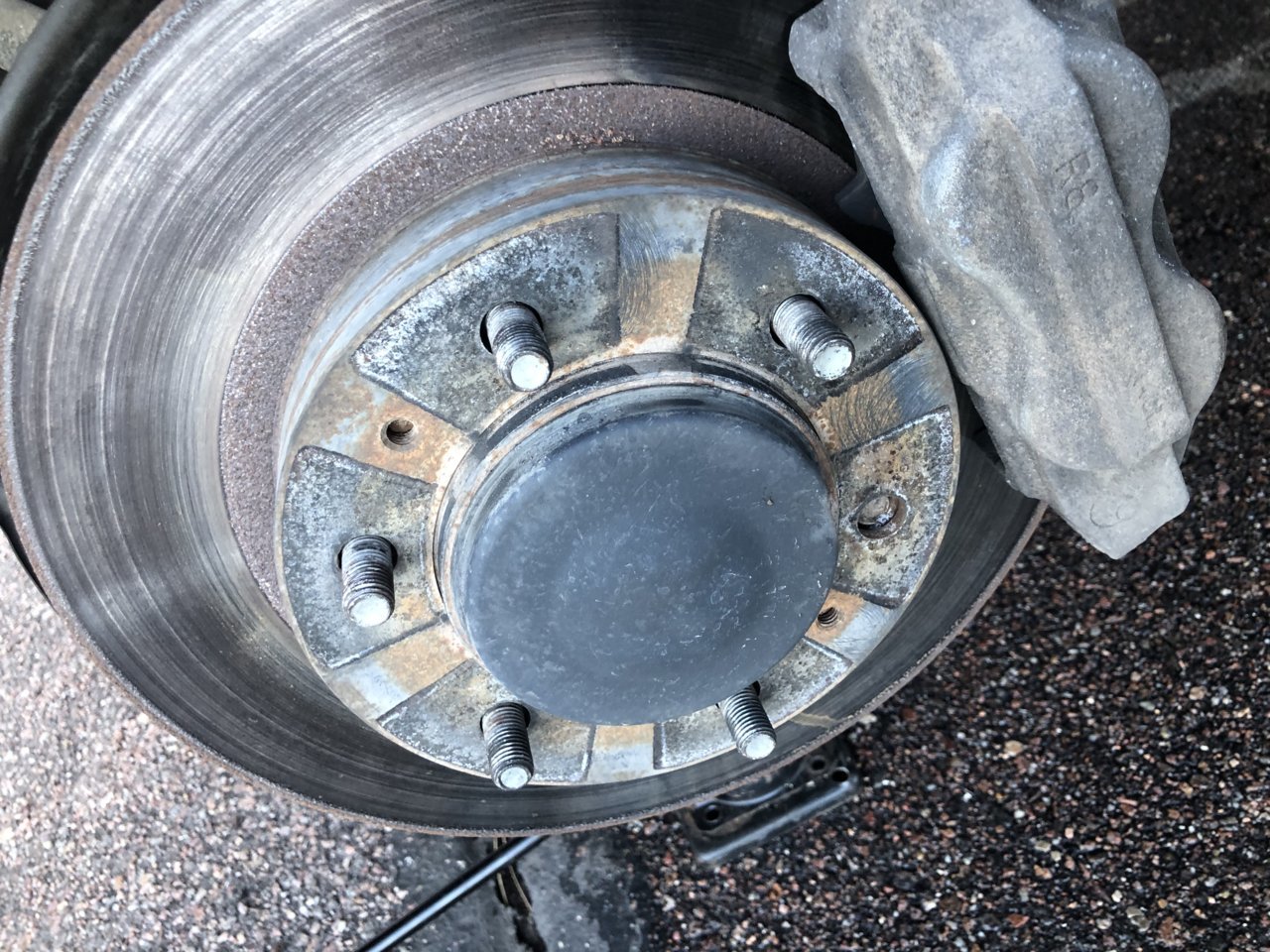

    What would you do if you were a poor college student? Do I have to buy a whole new hub? 5E3345AB-1920-4607-9ACE-0F36928C8274.jpg

    No. They sell them separately. Just gotta remove the brake disk

    It's not hard to do, just annoying because of all the stuff you gotta remove to get to it

    Seriously, easy enough fix. Takes longer to remove everything

    Make sure you remove the hard line bracket bolt, so you don’t bend the Hell out of the hard line when you take off the caliper.

    Easy fix as said, it’s actually kinda satisfying to seat the new stud, or maybe it’s just me....so how’d you shear it?

    I actually have no idea... I thought a lug nut fell off somehow and bought a new one. When I went to put it on I was like "shit...".

    I sheared off a wheel stud. I took an air hammer and drive the old one out. I used a nut to “press” the new stud into place. Didn’t take long and cost about $3 to fix.
