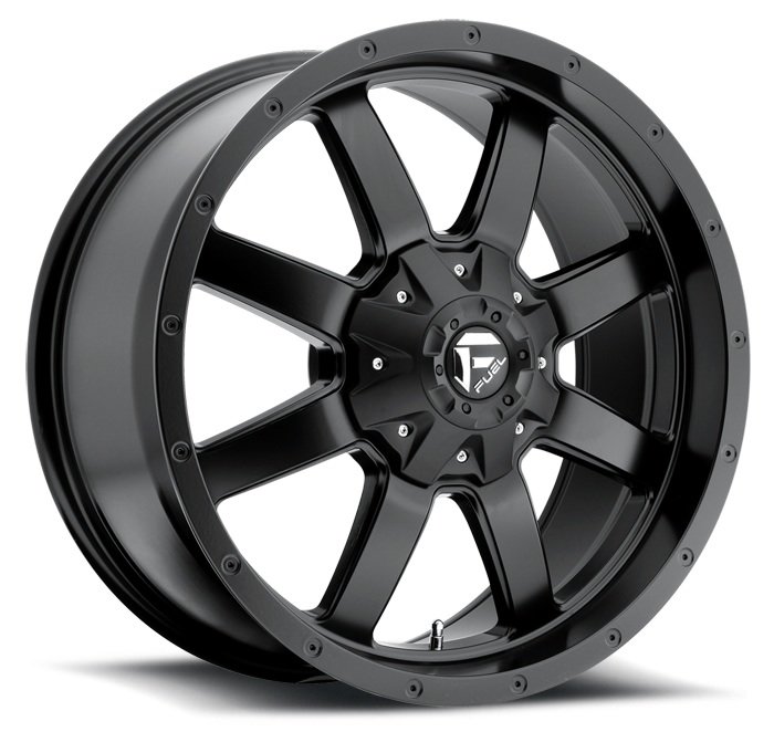

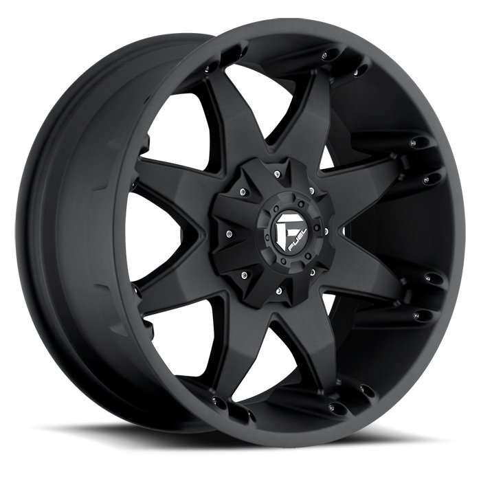

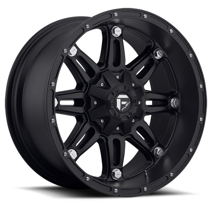

    Did some digging for you Fuel Off Road makes 3 different style wheels that are hub centric to the tacoma's hub 106.4 center bore is what you need for it to be hub centric.
    They are the Hostage,Octane and Frontier
    I just ordered the Octane in 17x8.5 with +14 offset 5.25" back space
    They will poke out one inch further then stock 17" trd sport wheels
    Gonna wrap them in 265/65/17 Yokohama Geolander ats
    Trying to keep it close to stock and keeping stock suspension
    I will have some pics up in about 12 days or so....stay tuned
    D531 Hostage
    D509 Octane
    D545 Frontier
