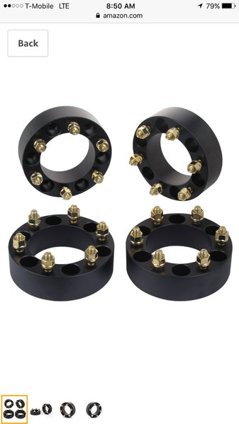

    IMG_6615.jpg Spacers look like this. There not hub Centric

    Wait I just saw you are running none hub centric spacers...... I would just order spacers that have the built in hub centric ring if you are going to run spacers

    and the spacer doesn't have a built in hub centric ring on the outer lip which isn't a good thing either

    I would highly suggest getting 2" hub centric wheel spacers specifically for your truck. adding hub centric rings to wheel spacers isn't going to address the issue of the spacers not having the hub centric ring for your rims.
