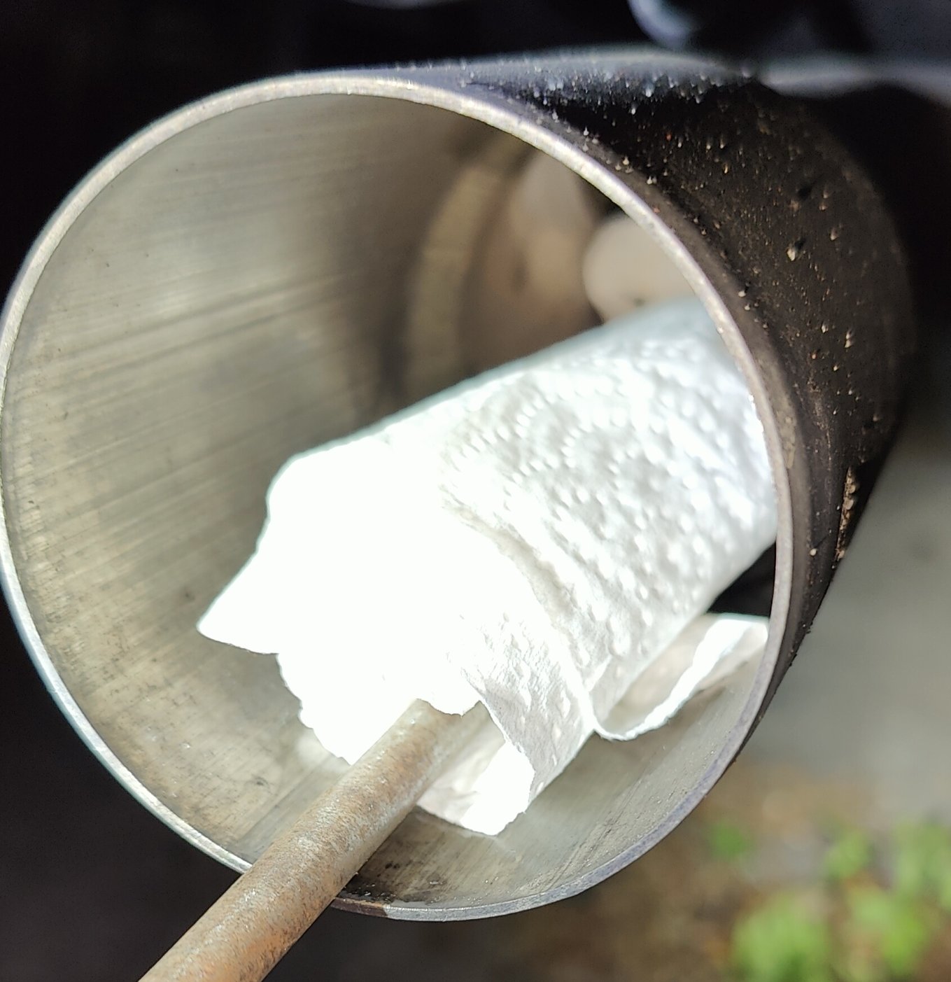

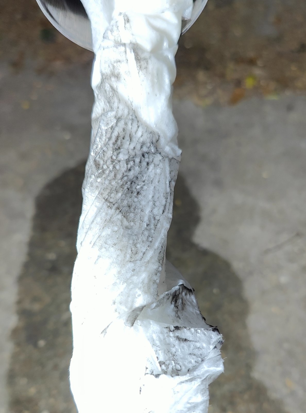

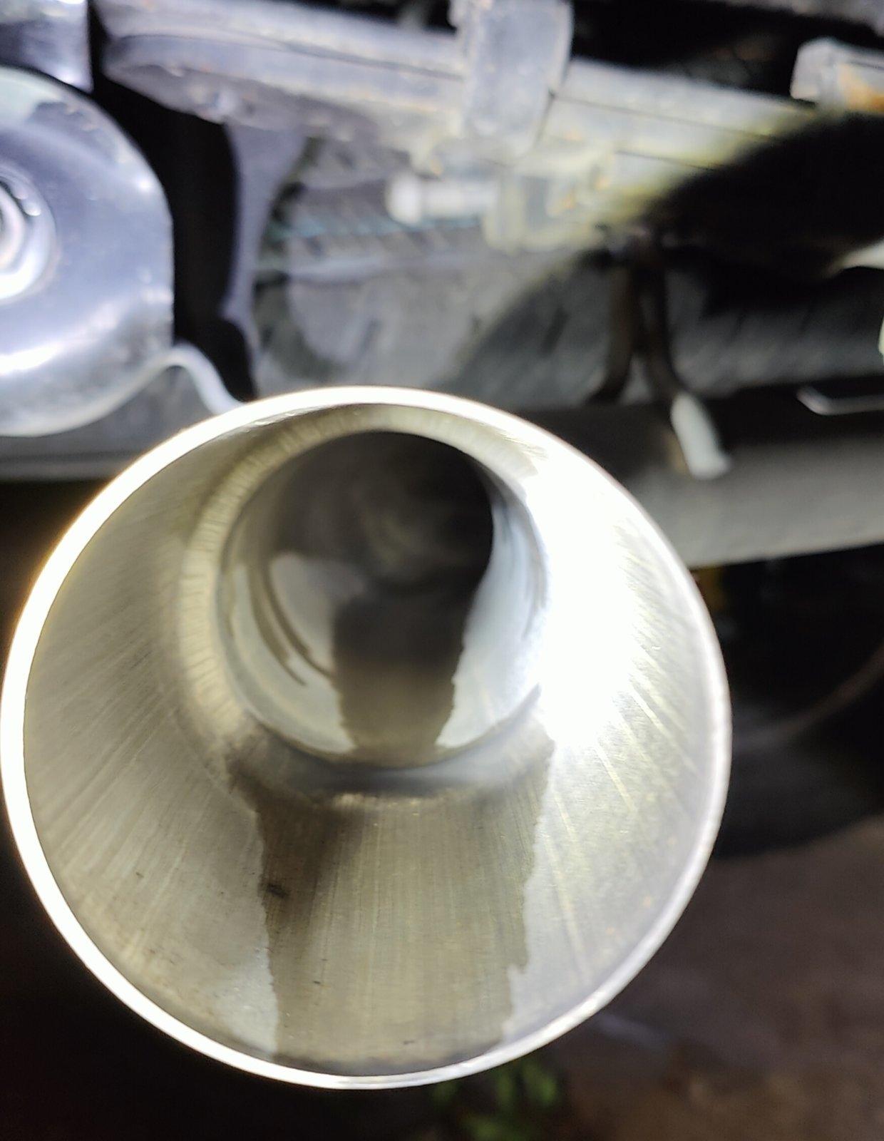

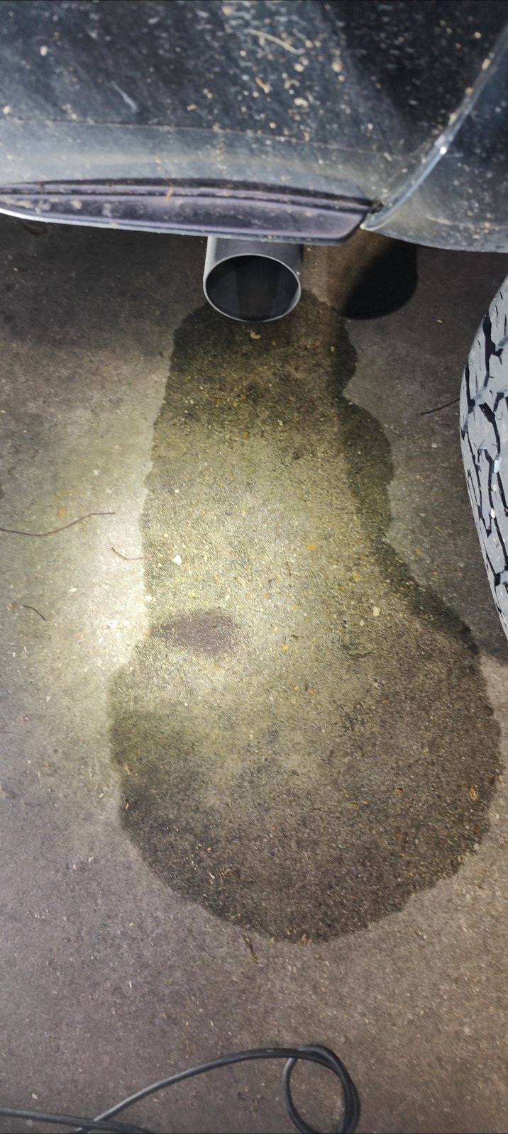

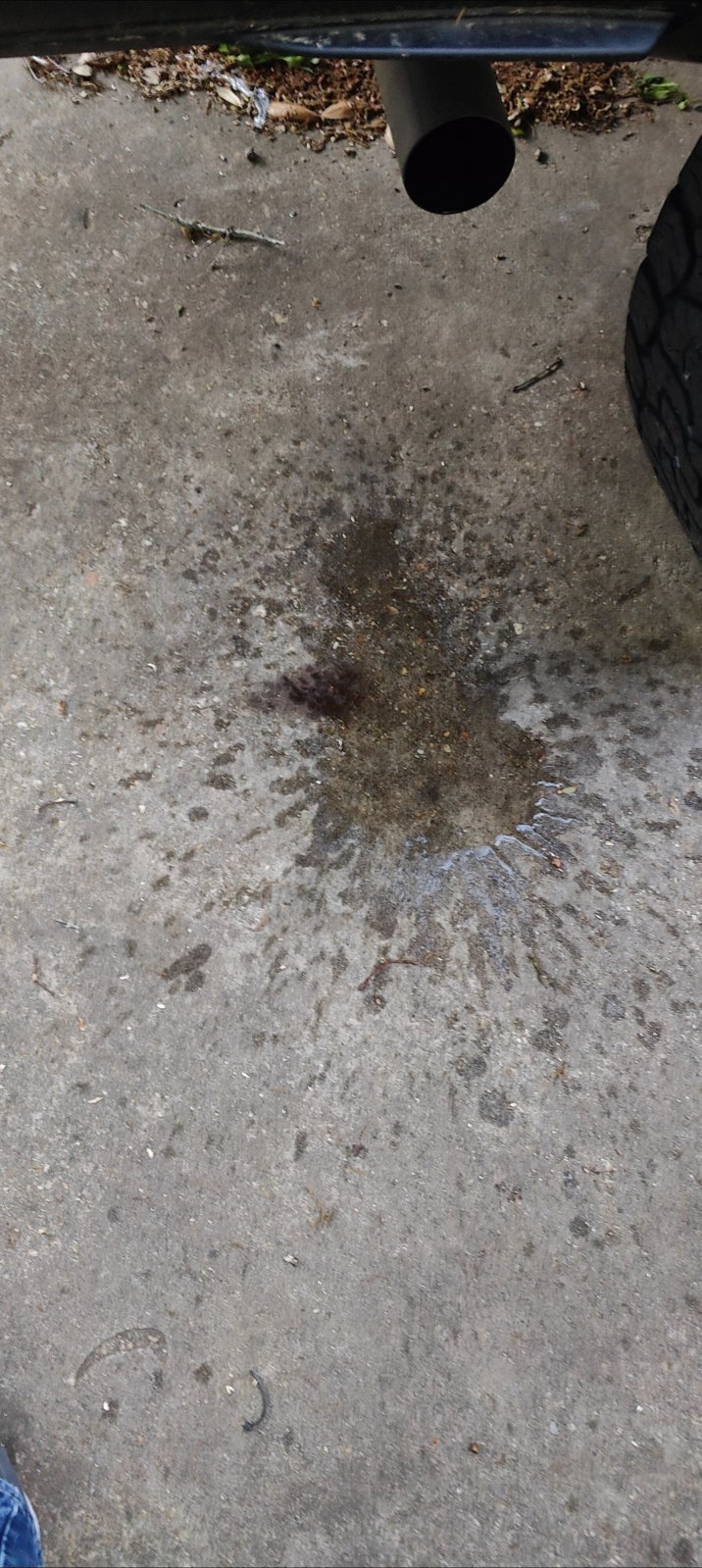

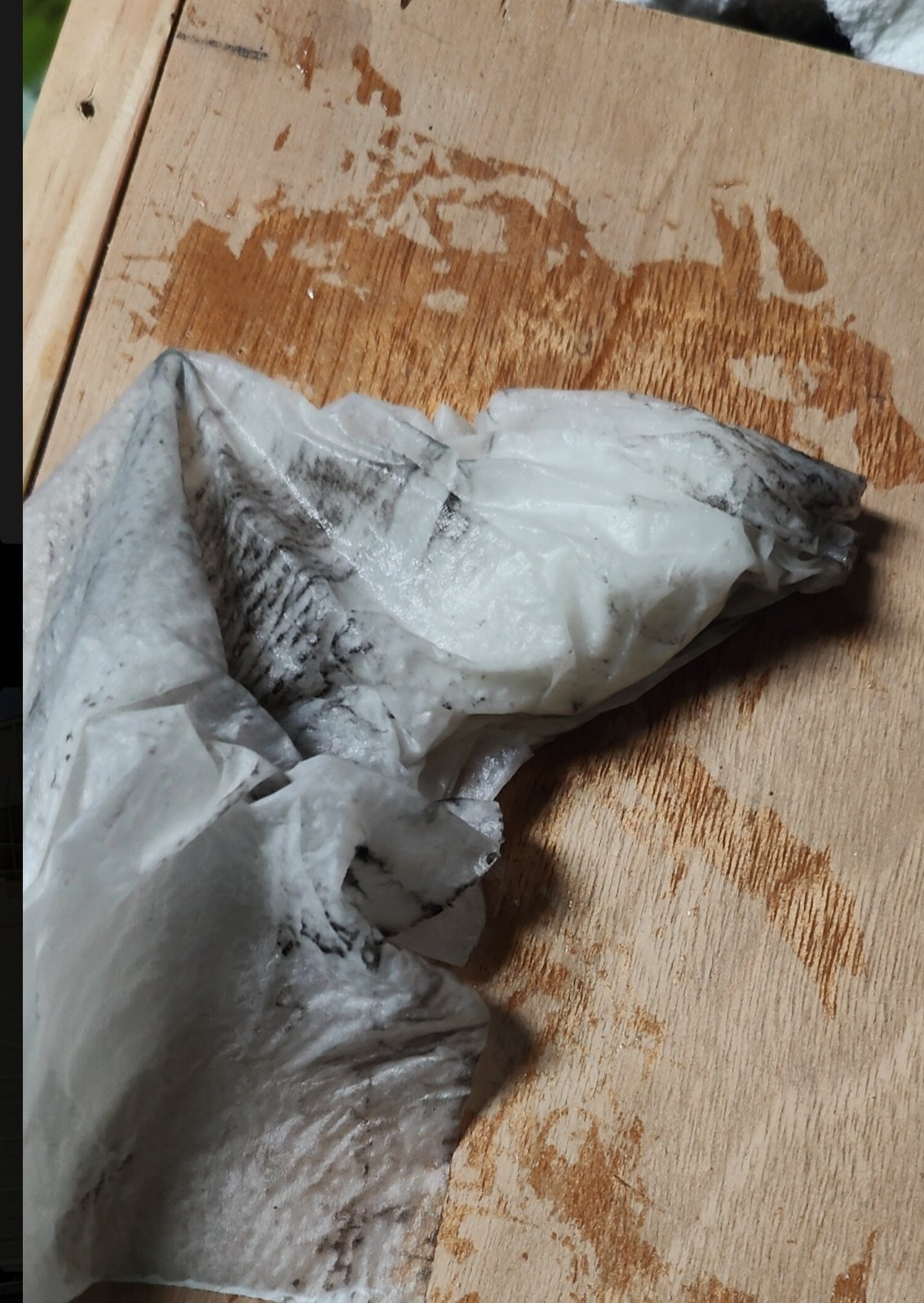

    I noticed this last night. Average temp, 60's. Humidity not too high. I started the truck and Alot of water shot out of the Tailpipe?
    1st pic it right when I started it
    2nd pic is after it idled for a while
    3rd pic is after I turned the engine off, puddles of water visible
    4th pic I stuck a paper towel in the table pipe
    5th pic I removed the paper towel
    6th pic shows how much standing water left in the tailpipe
    There is less than 2000 miles on the truck is this 'normal' for these engines?

    It's normal. Stop doing short trips and short idle times.

    When cold air meets warm air...:rain:

    When you combust fossil fuels, you create water in the process. A lot of water, in fact, you create around a gallon of water when you burn a gallon of gasoline.

    Normal. As long as it's clean water. If it was coolant, you would know. Water comes from condensation and is also a by product of the catalytic converter. Catalytic converters provide a site for the oxidation and reduction of toxic by-products (like nitrogen oxides, carbon monoxide, and hydrocarbons) of fuel into less hazardous substances such as carbon dioxide, water vapor, and nitrogen gas.

    There's probably water pooling in your muffler, since the tailpipe opening is higher than the muffler bottom. Thankfully the muffler is stainless.

    You can check and see if your drain on your muffler is clogged, I don’t have a third gen but never seen a car without a weep hole on the muffler
